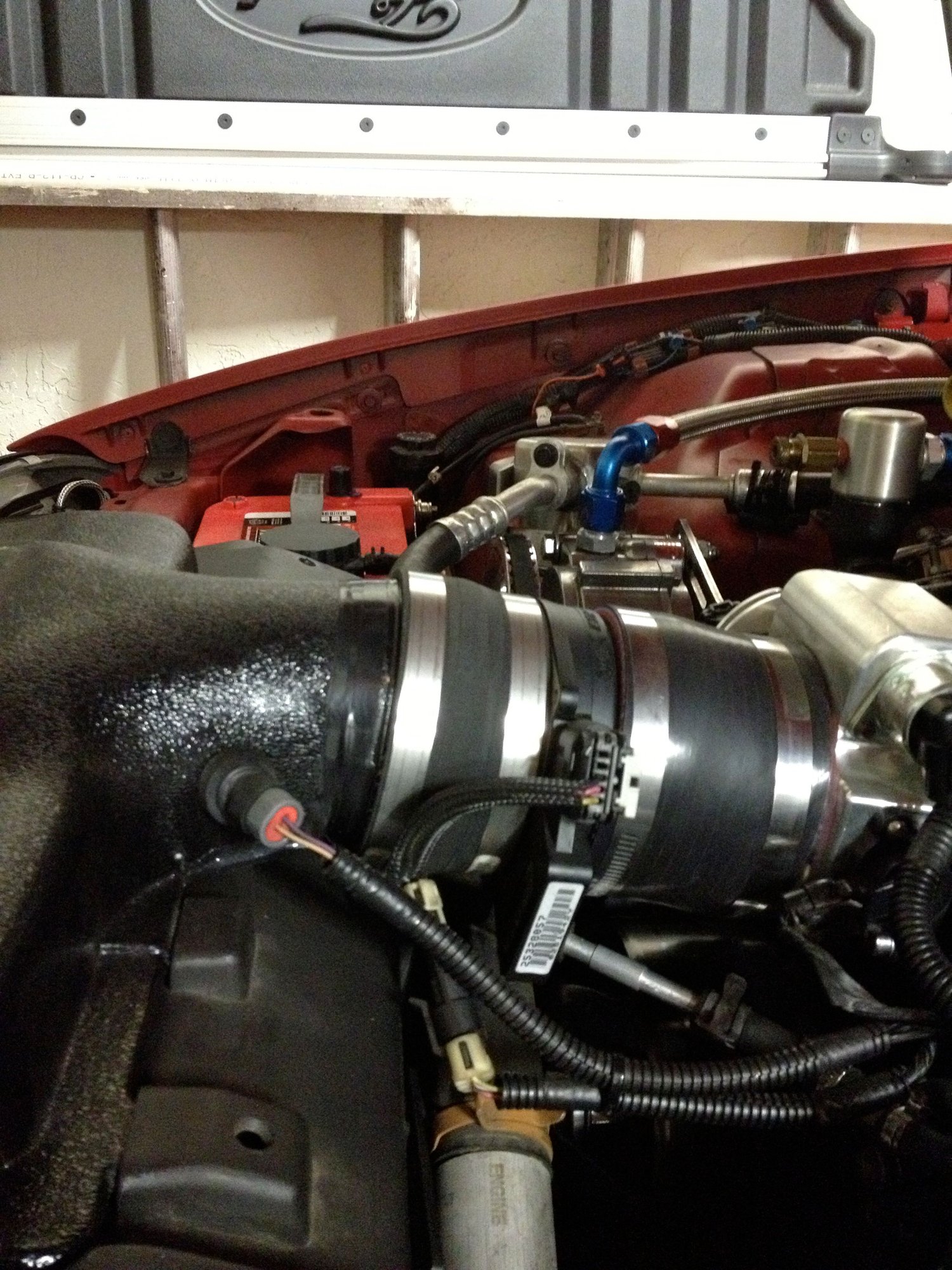

Here's a pic of mine. Just to note I have spohn solid motor mounts that raise the motor a bit.

yours looks like a straight shot from the lid to the TB.....no ...or little....angle to it at all
I have the non solid spohn mounts with polys....i know that raises the engine a bit over worn out rubber mounts
what MAF is that ? looks to be shorter than the metal or truck plastic one

Just looked at number on MAF. It's 25168491. The 85mm unit. It looks to be plastic on one side & metal the other.

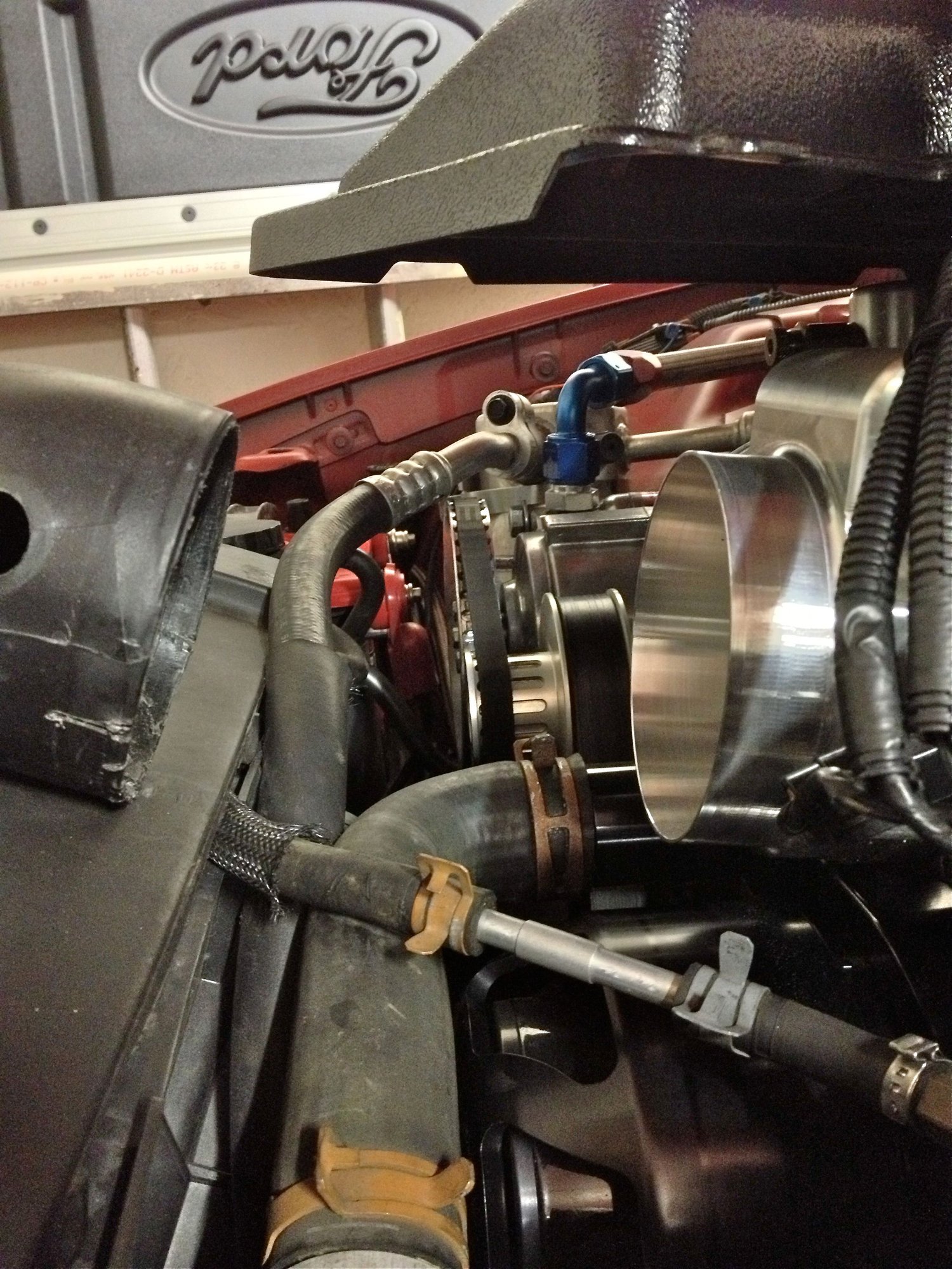

The SLP lid does have an extra bend. I still have it I'll take a pic next to this one. Give me a minute.

Here's a pic of the SLP lid on. You can tell with the MAF on it would be down like yours. It was the only reason I got the new lid, because the SLP didn't fit with new intake. Some people figure a way to get it but the FTP lid is bigger & better anyway. It does start to touch the hood but pretty normal. Also just another angle with the FTP lid. It fits straight/perfect. I take it on & off all the time. I just don't like telling people exactly what to buy as it's your car. Hope this helps a little.

it looks like your coupler between the lid and MAF takes a little downward jog....but not so much it cant handle
is that MAF shorter ?

looked up that MAF.....looks like the one SLP used to sell
