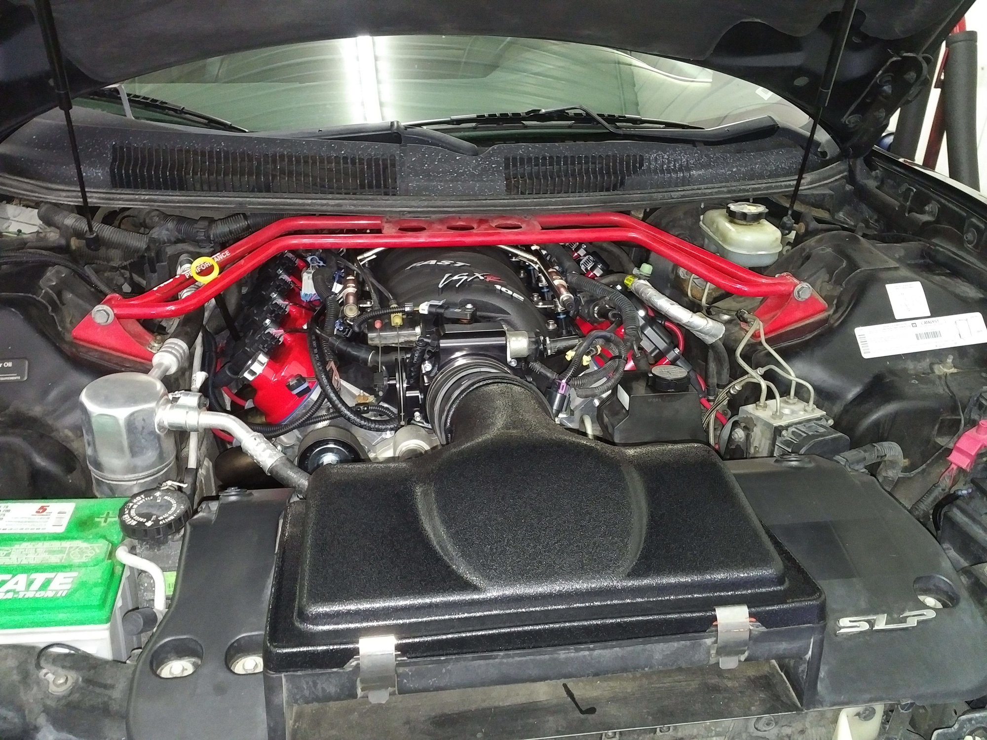

The quality of the FTP 104 lid is excellent based on my experience with the one on my 99 TA. It fits and seals well. The TA isn't a WS6, but has the WS6 lower airbox and the FTP 104 lid fit fine on my 99TA. The lid has been on the car for over a year and about 3,000 miles. No issues.

cool, nice photo, thanks for advice ...what maf you running?

Thank you. If I recall the 104 FTP may have fit issues on some Z28's and SS Camaro's. Running the LPE 100 mm MAF.
​​​Lingenfelter 100mm MAF

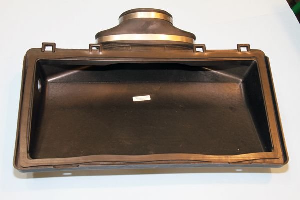

The above picture is a stock lid, a blackwing lid is smooth inside and so is the FTP. The FTP would adapt better to a FAST setup due to the neck being bigger. I would not use the blackwing on a FAST setup, the smaller neck would be a restriction. I have not had any sealing issues with my FTP, just minor clearance issues.
Damnit. I got it from some article on black wing lids and didn't scroll down further. I just scrolled through more of the article and you are right,
This is a blackwing
My apologies

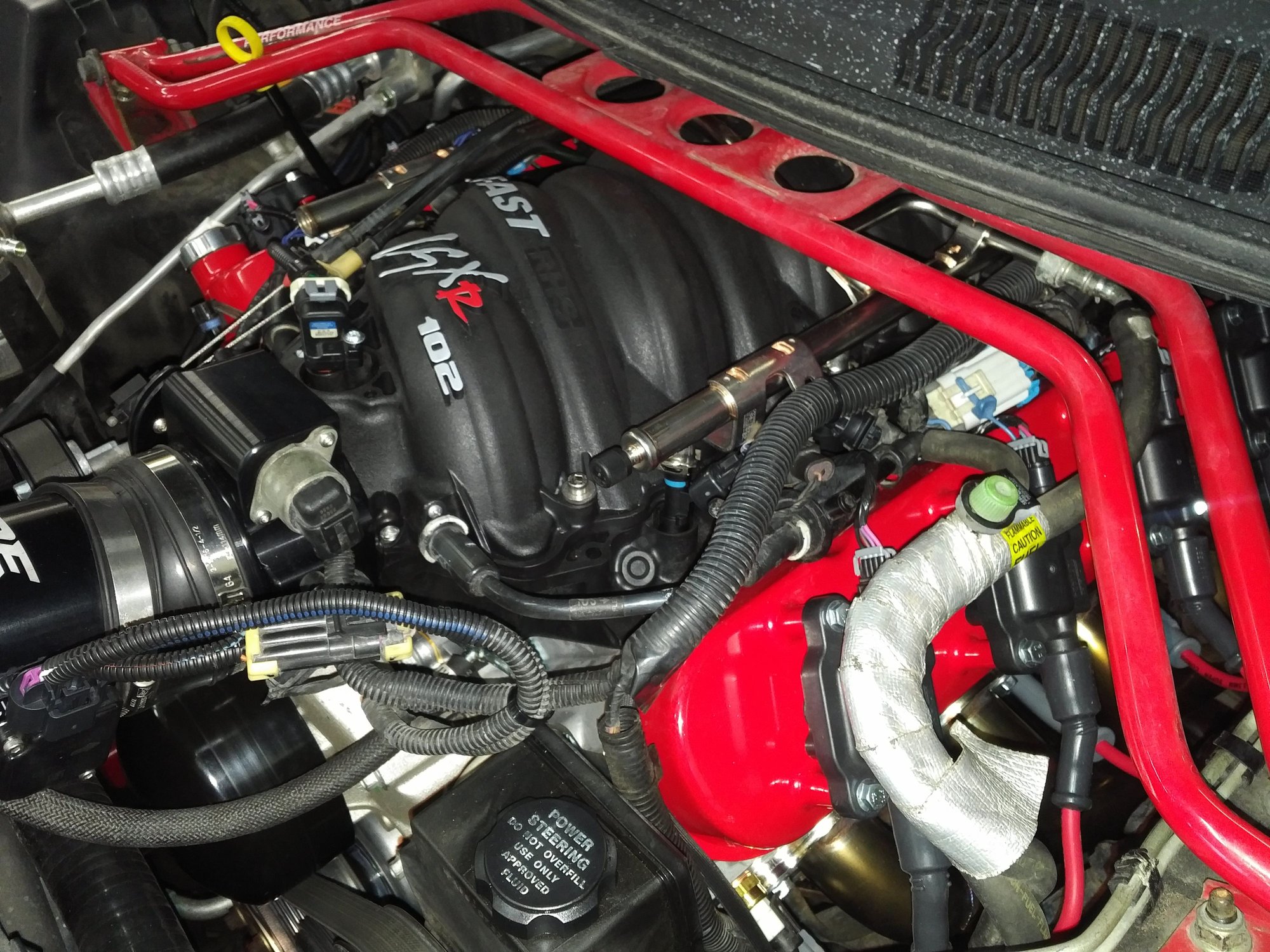

FTP 104 lid , WS6 lower air box, & LPE 100mm, MAF w/NW 102 TB, Fast 102 LSXR
So far the FTP lid no issues fitting. Stock TA hood.
