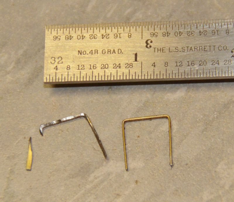

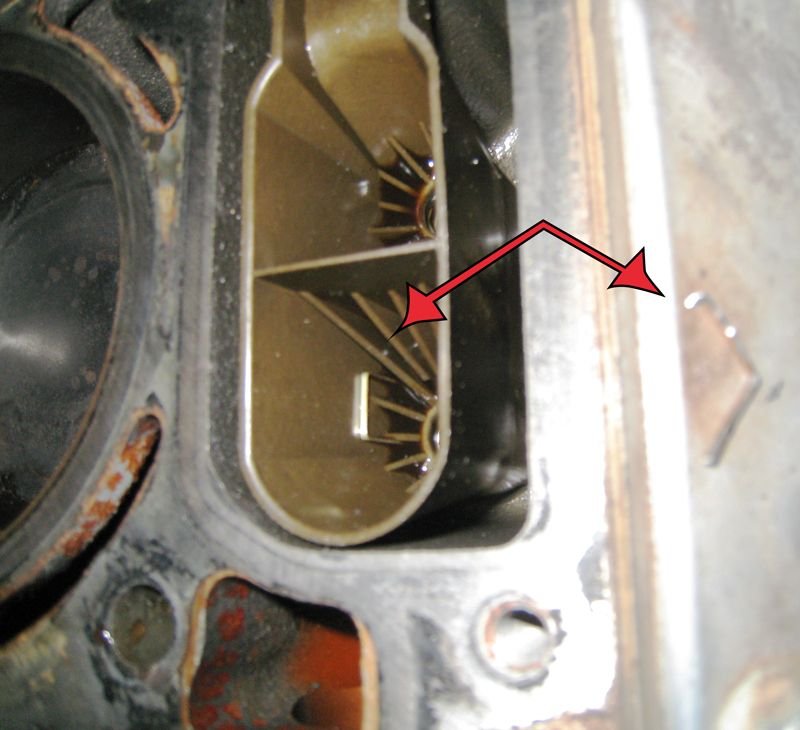

You just never know what you find when you open-- up an engine. I pulled the heads off to do a head swap and I found two 9/16” staples inside. One in two pieces under the passenger side valve cover and one setting on the same side lifter tray. I did have the covers off years ago to change the valves springs for a cam swap. So, the one that got chewed up by the springs could off gone in then----but not the one on the tray.

One in the tray, the other by the valve springs.

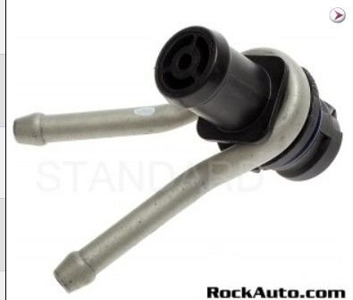

Ford has a pcv setup where they run a small coolant hose around the pcv valve. You could run your throttle body coolant hoses around your tank to simulate what they do.
Here is a picture of one
