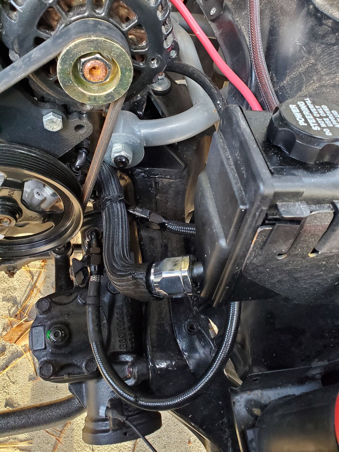

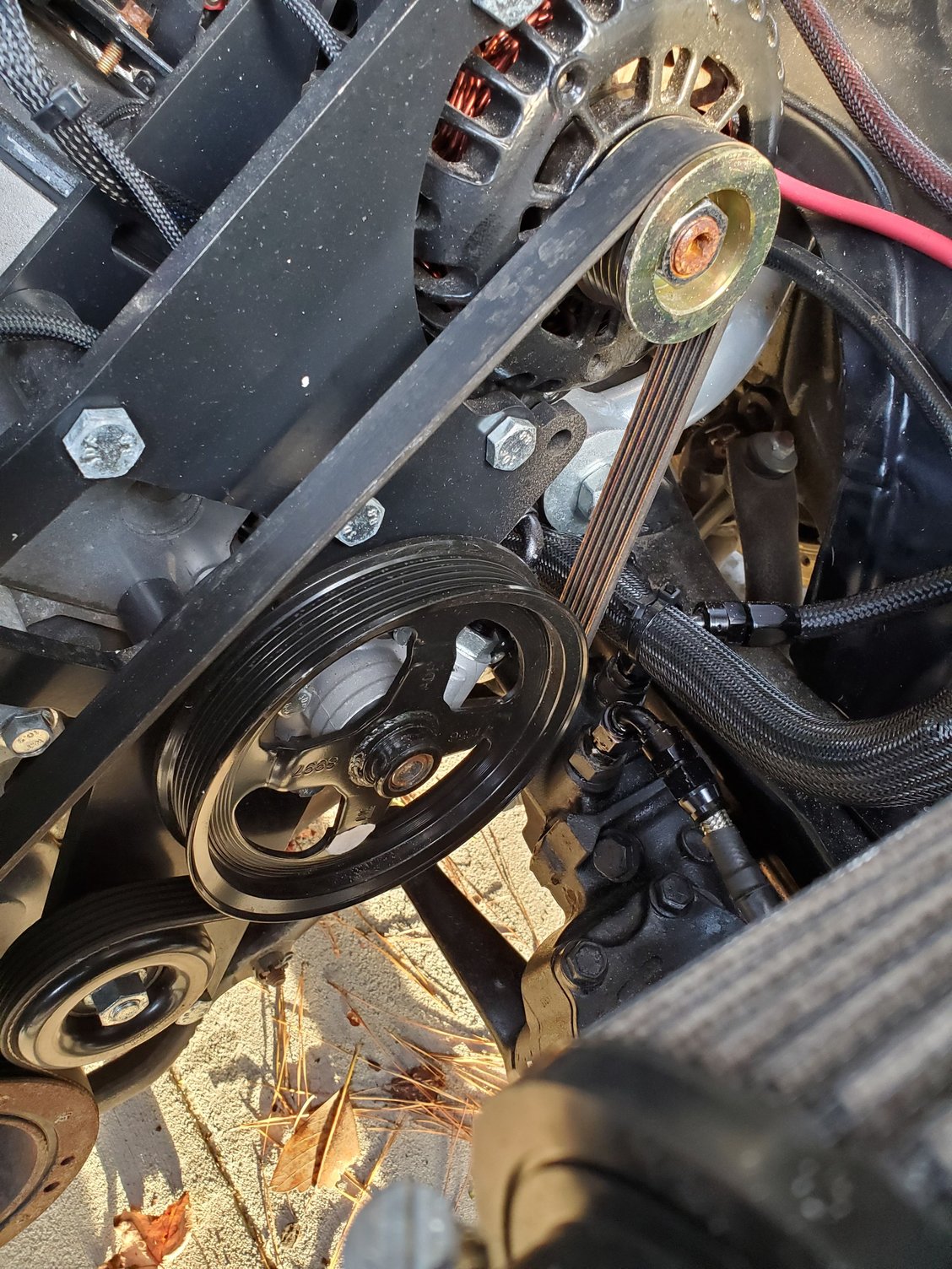

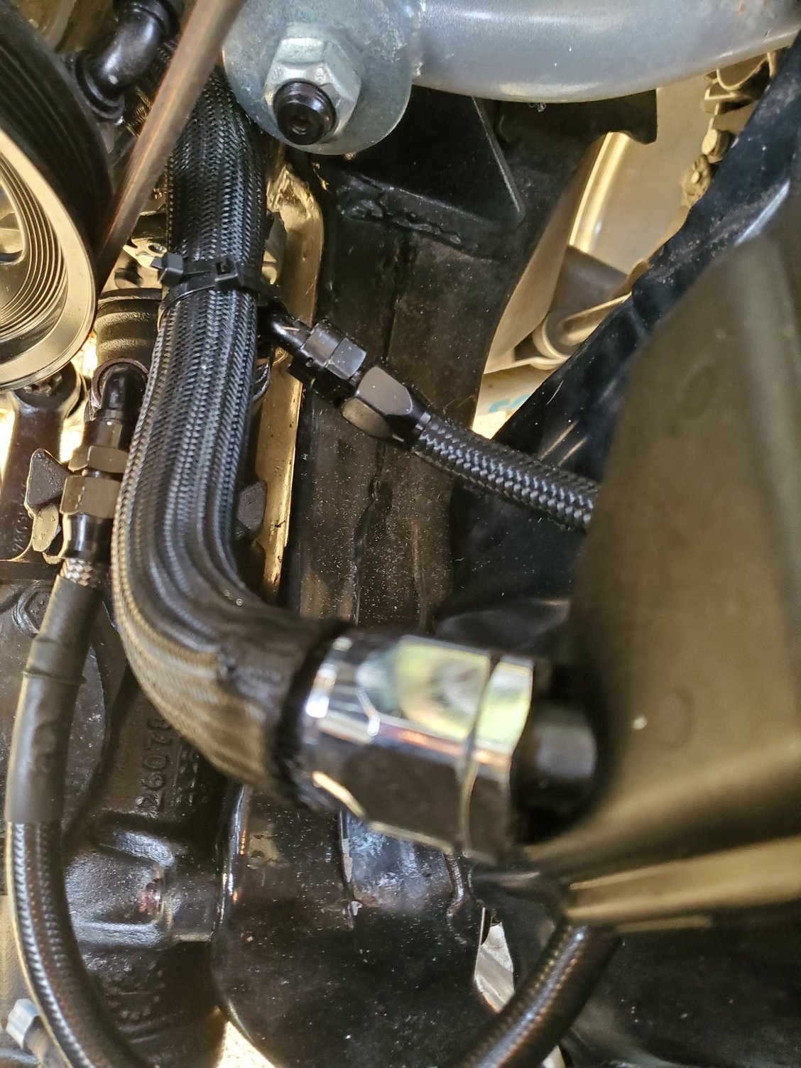

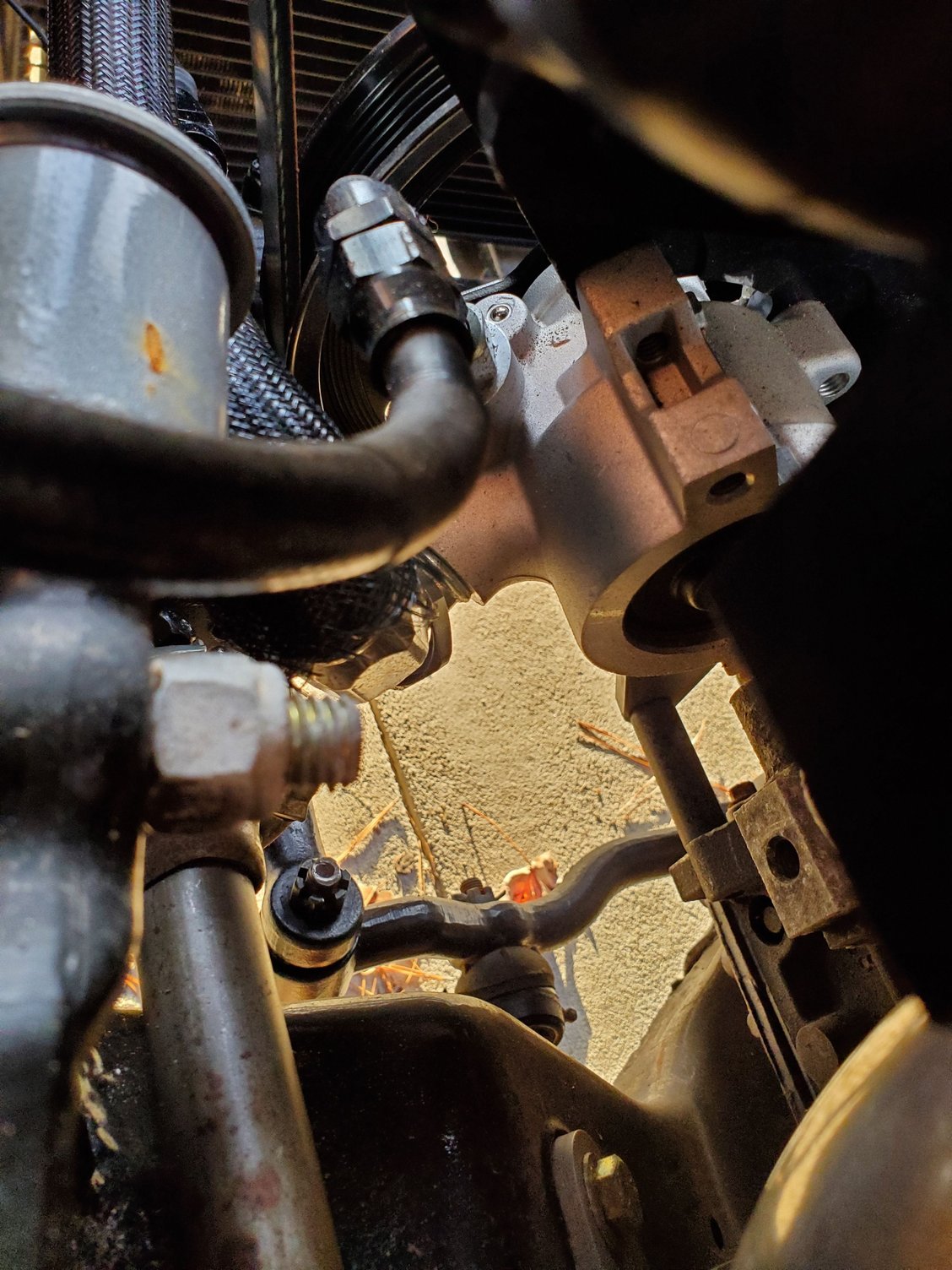

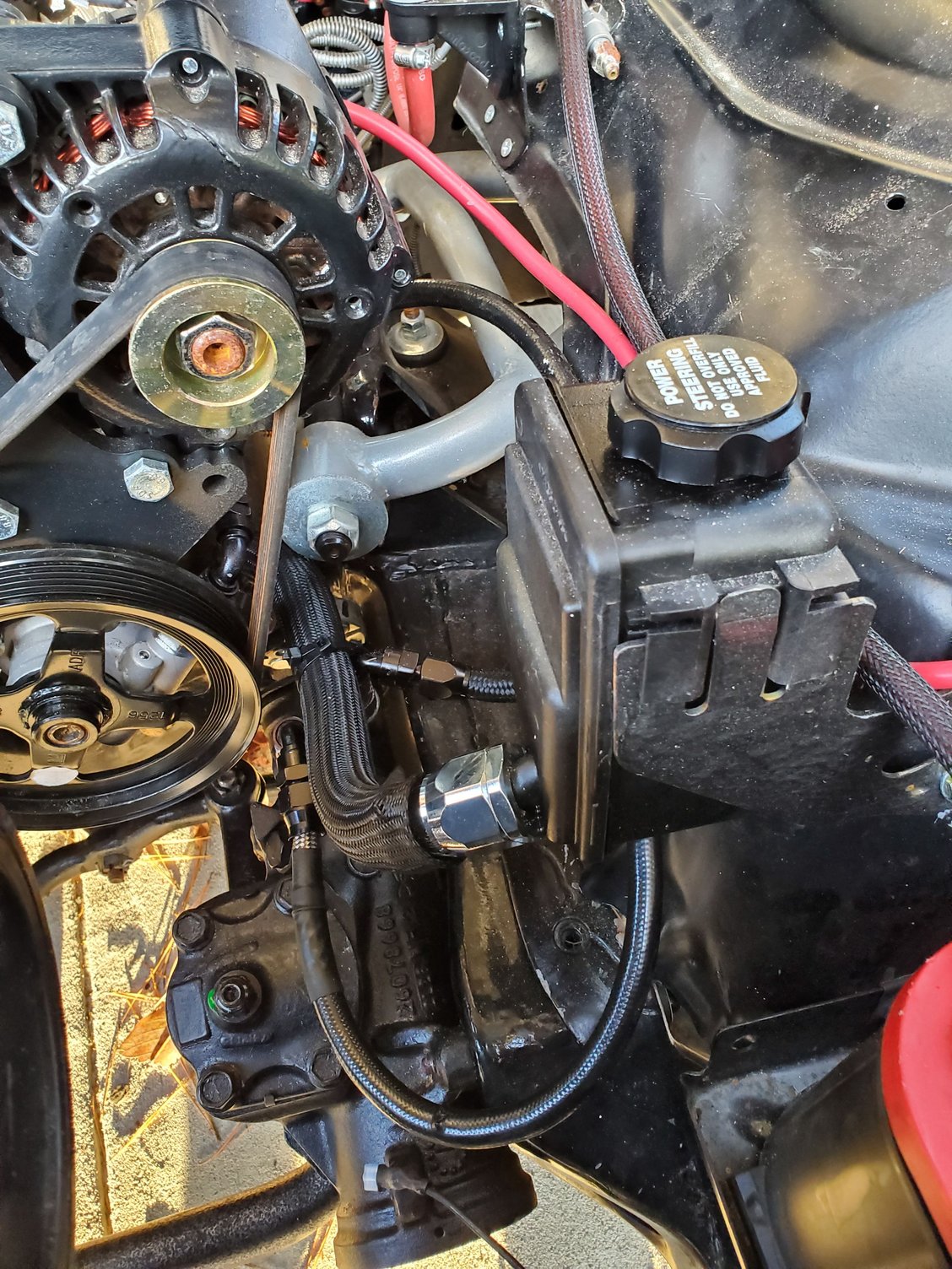

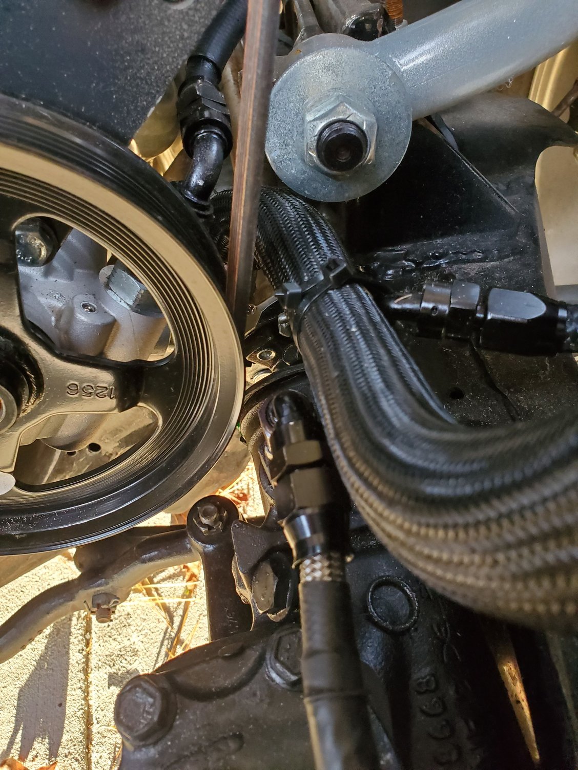

Sorry for the lack thereof of details. I have a 1/2 rubber hose feeding the pump and I'm using a -6 PTFE AN line from my pump to my steering box then a standard braided -6 from my pump to resevoir. Please excuse the cars condition as it has been sitting for nearly a year and a half collecting dust and rust. The setup is super fugly, It looked great last year when the box was working but I have removed and installed the lines and resevoir so many times, I just started trying to change the location of various items. The hose routing is temporary. Just tried to get it going so I could drive it up to the new shop (which I did lol).
I do not like how I routed the pump feed line but I did jack it up and turn the wheels left and right to bleed the system before I even attempted to start it up. I kept adding oil and priming until it would stop taking oil. All comments are appreciated, thanks
