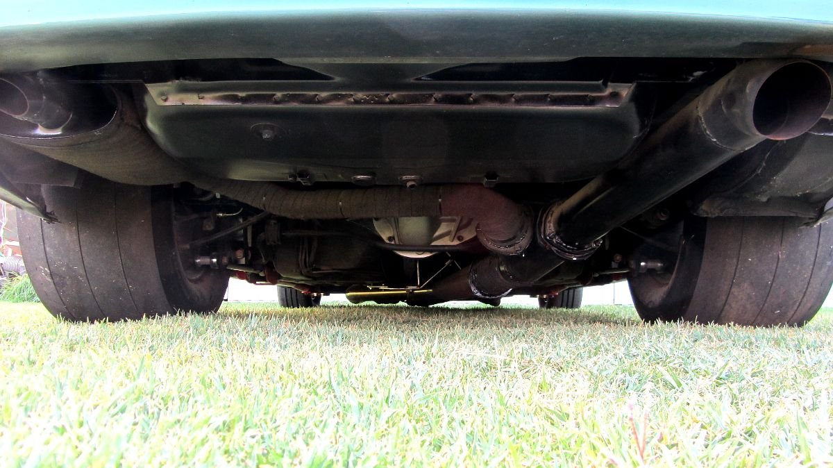

I realized one day that i can use an electric cut out, kind of backwards to it's intended purpose. The 4" electric cut out itself is mounted on the straight side of the Y junction at the rear, mounted just before the tailpipe.
I open the cut out and have a single 4" straight through with no muffler. Sounds nasty, but not anywhere near open header loud. I close the cut out and the engine pumps through a single 2.5" pipe and muffler all heat wrapped to make it neighbour and suburbs friendly. Best of both worlds. I tucked the little muffler up as high as possible so it's barely noticeable from behind and only the 4" dump pipe shows. I also left more than enough clearance to run a thick drag rear sway bar, I just haven't needed one yet.

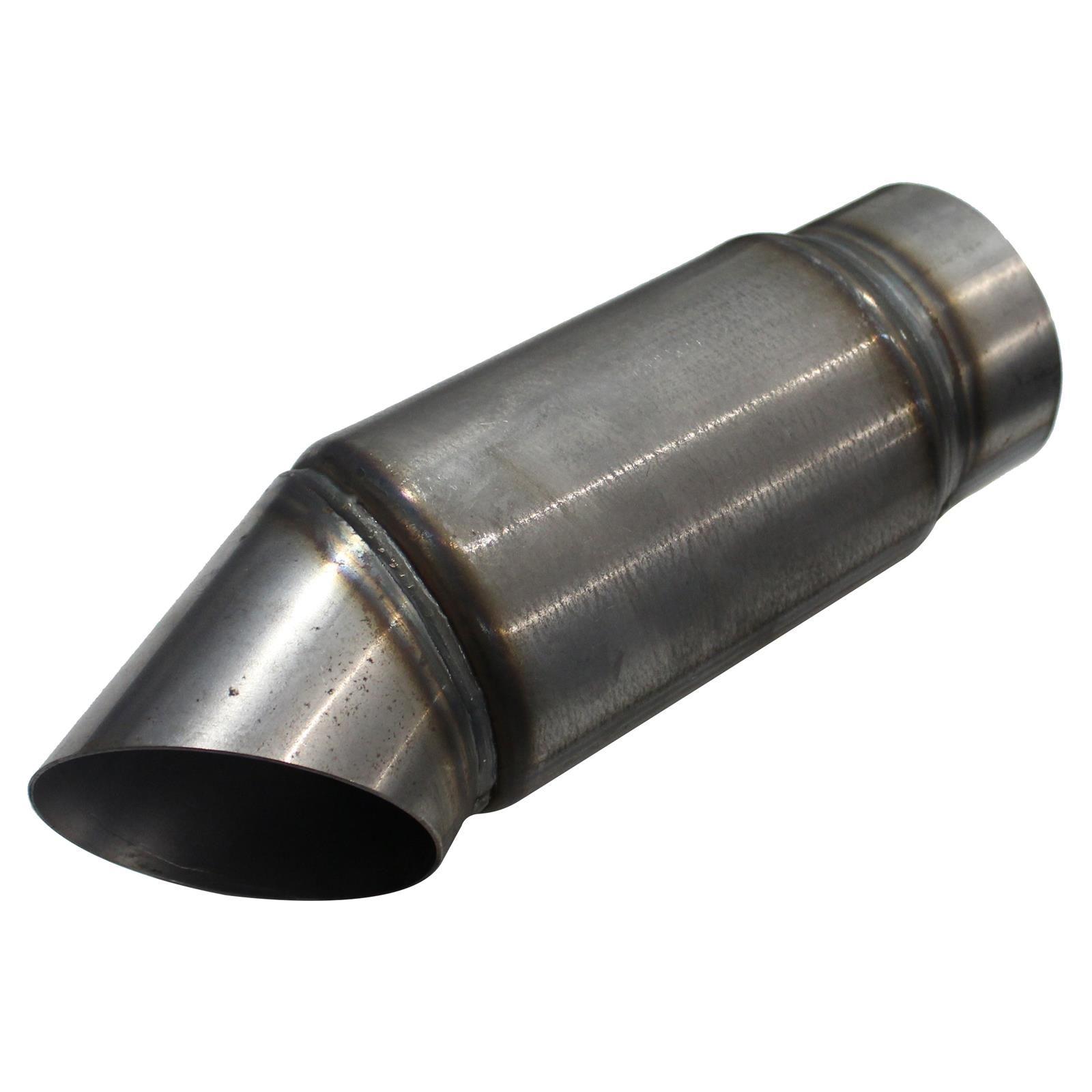

I am currently running a single 3" walker bullet muffler dumped before rear axle and it sounds cool, much like an older fox body mustang and not a dump truck. I plan on upgrading to a larger 3.5" Beyea muffler (part# muf3.5) and pipe for more flow. I will lightly weld the 3.5 pipe to my SLP Y pipe to connect muffler. Summit sells this muffler and has a built in turn down. Beyea also sells quiter versions of this muffler (part# mufq3.5)
