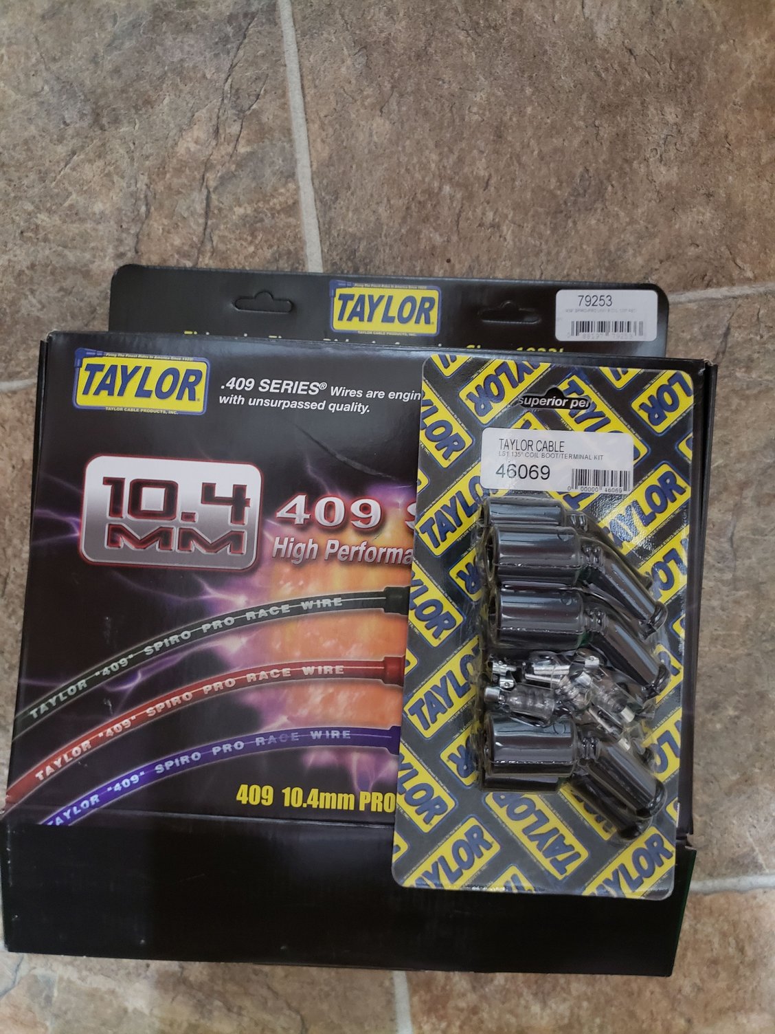

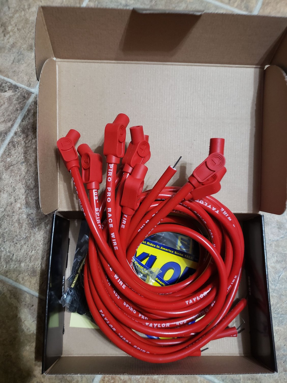

I like the way the Taylors look. I assembled them myself to get what I wanted. Unfortunately I have a problem removing them and from time to time the clip stays on the plug. In order to not be stuck or have to wait I purchased extra. I picked up a universal V8 set (79253) and a set of LS1 coil boots/terminals (46069). Both of these have 45° boots, but Taylor refers to them as 135°. I believe the LT1 optispark ends are straight, no angel. This may or may not suit your custom application.
