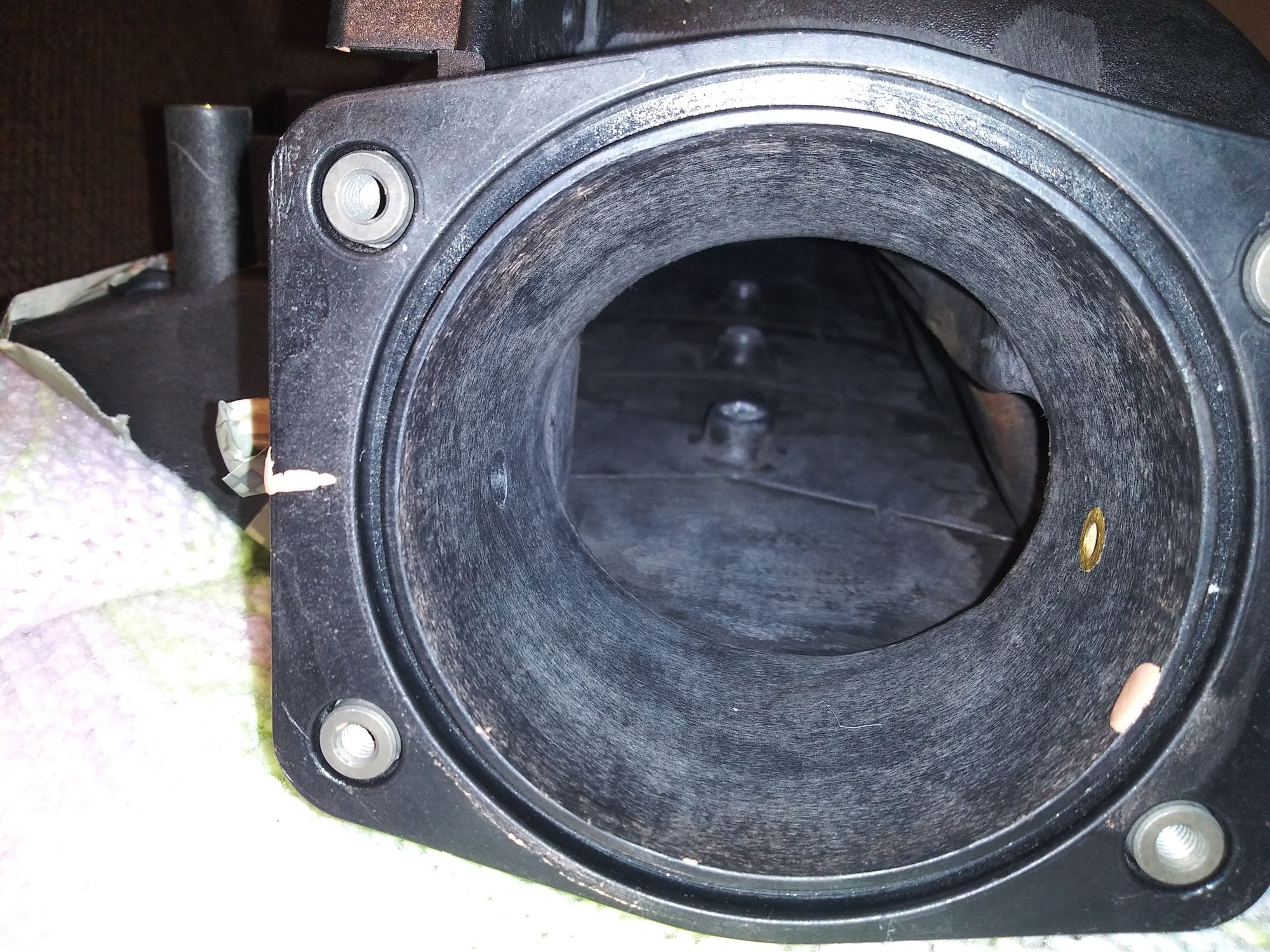

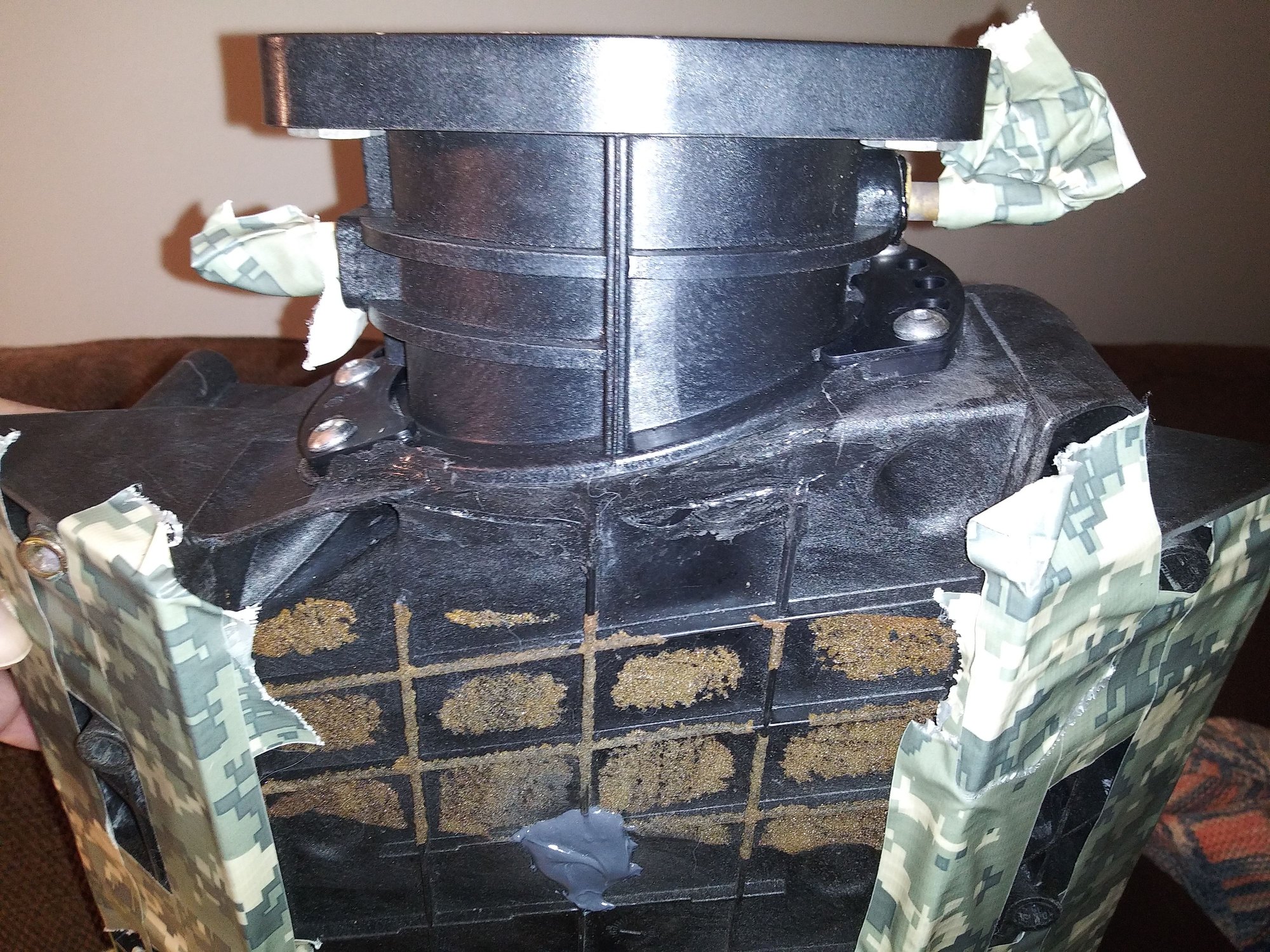

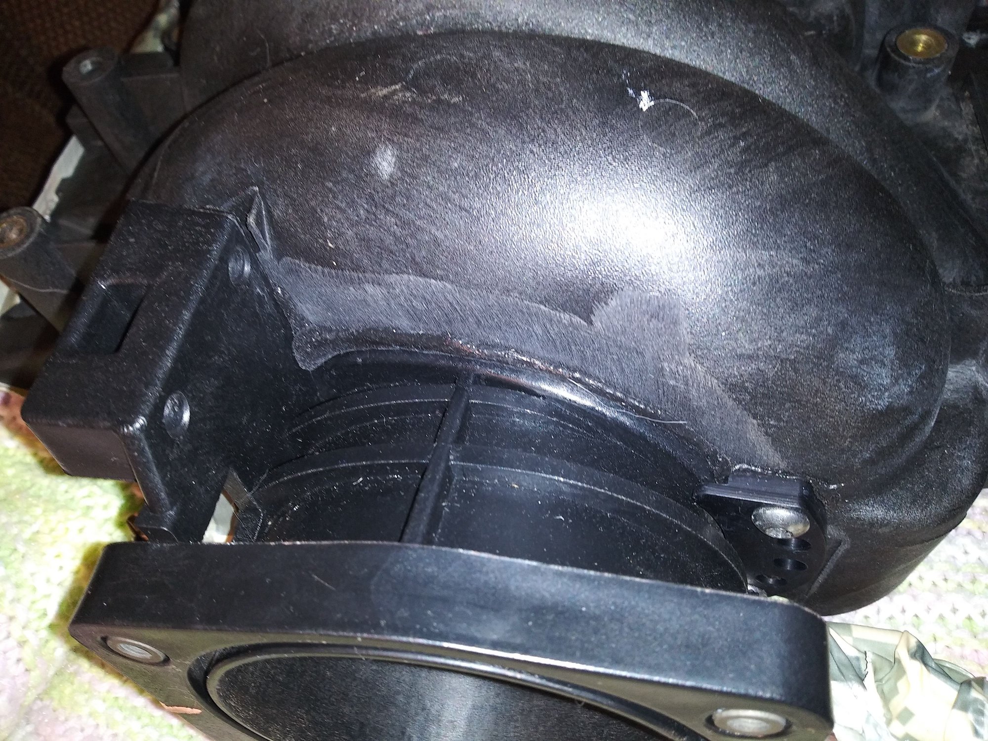

The 90mm LS6 has the stock 78 mm snout cut off of the intake manifold and replaced with a 90mm snout from an LS2 intake. LPE did the one below in 2017 and the new snout cost $350. My 91 RS has a TPIS converted 90mm LS6 that was done in 2015.
You can see where the new 90mm snout is glued and bolted on to the LS6 intake. This one was done my Lingenfelter Performance Engineering.
90 mm snout on LS6 from the front.
