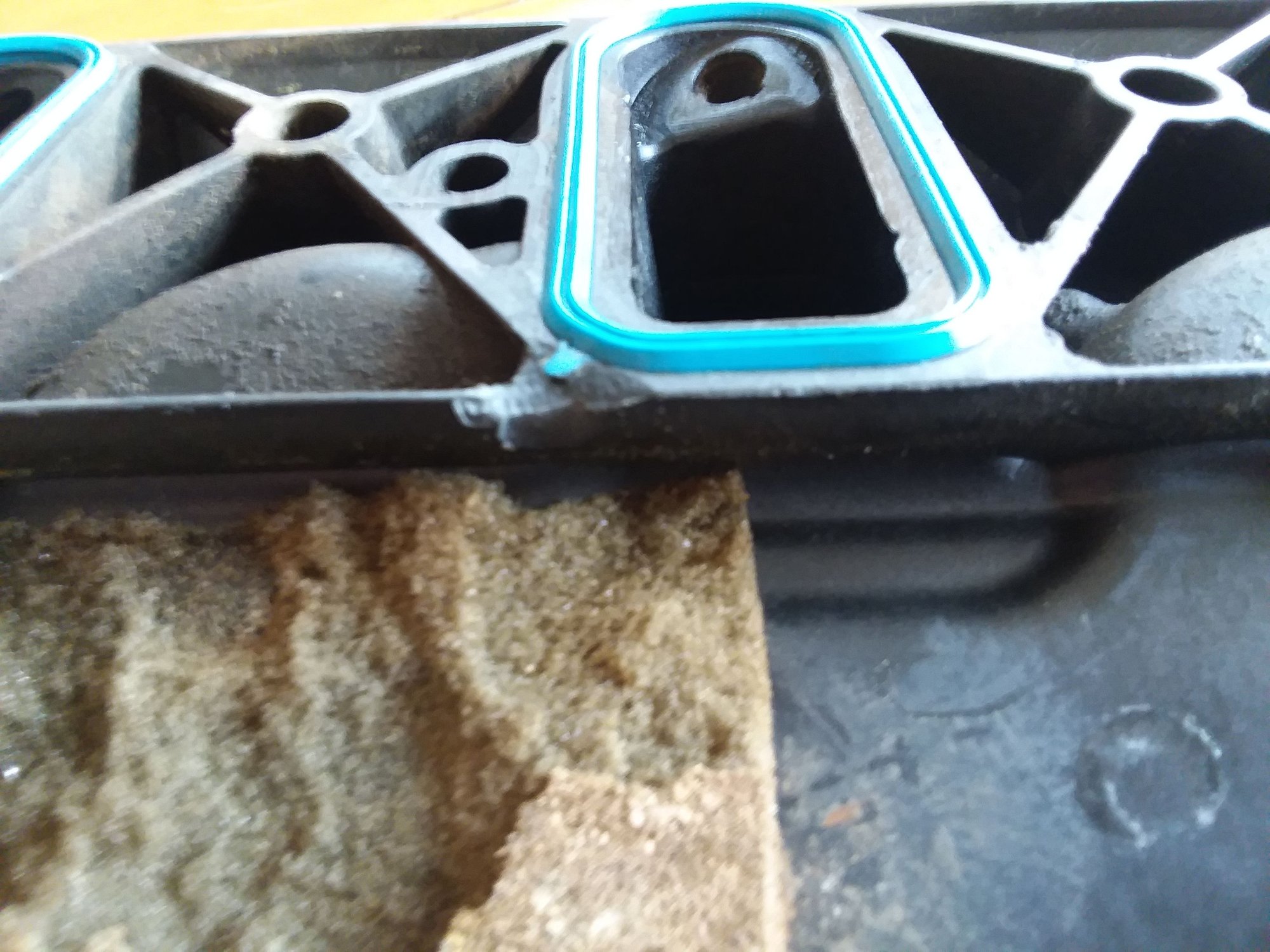

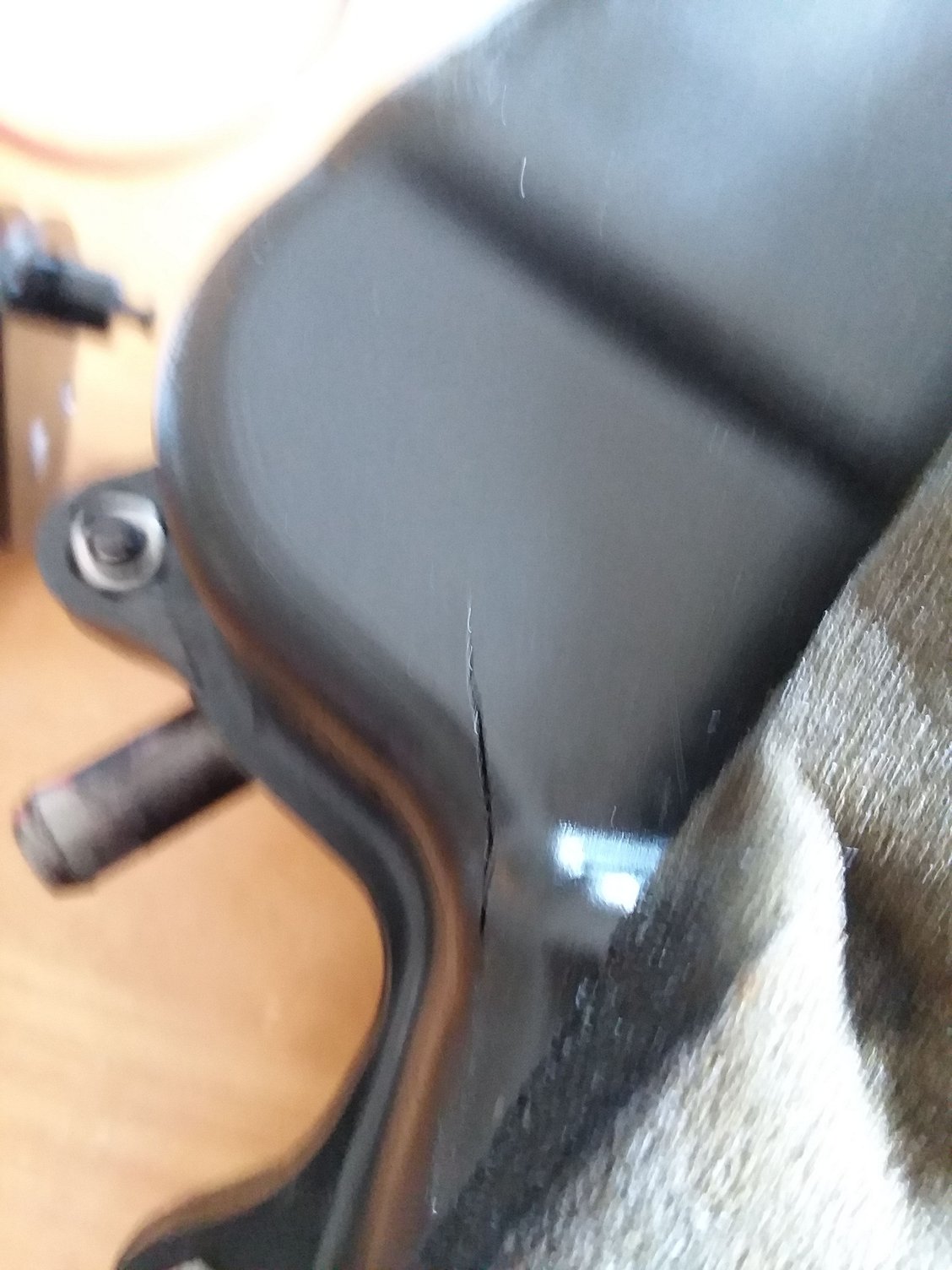

Can anyone tell me if this crack/or just gouge on the intake would affect performance/cause leaks by the photos alone? I'd rather not open up the intake since the crack looks very shallow. The second photo is a small chunk of material missing on the bottom of the intake.

Second pic is fine. First is hard to say. Looks like it could be sealed pretty easily tho.

Thanks. Yeah doesn't look like it goes through. What product would you recommend to seal it?

Some permatex ultra black would work. Or there are plastic weld kits where you sprinkle some powder on the piece and spray it with an activator. That would be the more solid choice imo.

Should be able to be fixed with an epoxy.

There's a jb weld plastic epoxy that's specifically for abs type plastics that I've had good luck with. They sell it at home depot in tan, but the clear version would probably work better for you.

definitely use an epoxy that is for abs plastics!

3M panel bond adhesive....dont use anything else
