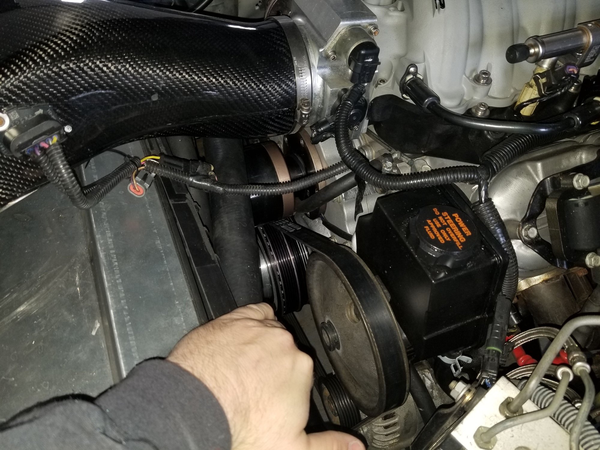

I run the street meziere. But i took that big idler pulley, tensioner and smaller idler pulley off years ago.
I ran it mostly with just the "right" fit belt. Just rolled it on then removed the idler by the ps to take it off. With the jegs alt bracket i did away with that idler.

any pics

There ya go
When i had my ewp rebuilt i had them leave the inner supper and bearing off for the idle pulley. Just letting ya know because it looks a little different.
