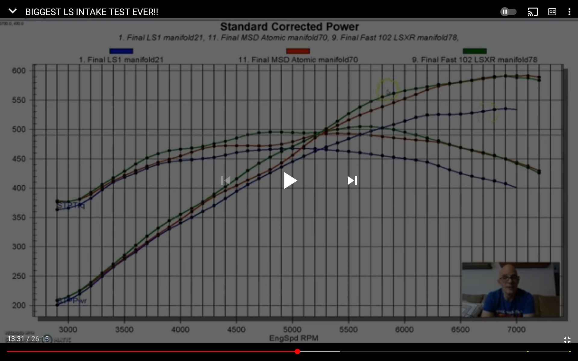

I was watching this video recently which convinced me the Atomic MSD intake is good value when compaired to the Fast manifold. This is because the Atomic can use the stock fuel rails and throttle which is a huge saving.
The atomic makes the same peak power than the Fast in this test although less torque but torque is still on par (or very close) with the LS6 manifold up until 4700 although the Atomic still wins as it holds on to its torque longer and peaks higher at 5500.
Does anyone know if the Atomic looses any low end driveability under 2000 rpm due to its emphasis on high end power?

Screenshots of above video LS6 vs Atomic result 30 HP ??

Hi yes it might be better to buy locally, I'm thinking I'd only get 20 HP on my mild set up with the Atomic, the manifold in the test was with a plus 230 duration cam and good heads also not a sub 220 cam like mine.
Unless the tuner knew what he was doing I doubt I'd get 20 HP more, sounds a little like tuners here in a Australia don't know how to tune to suit these manifolds.

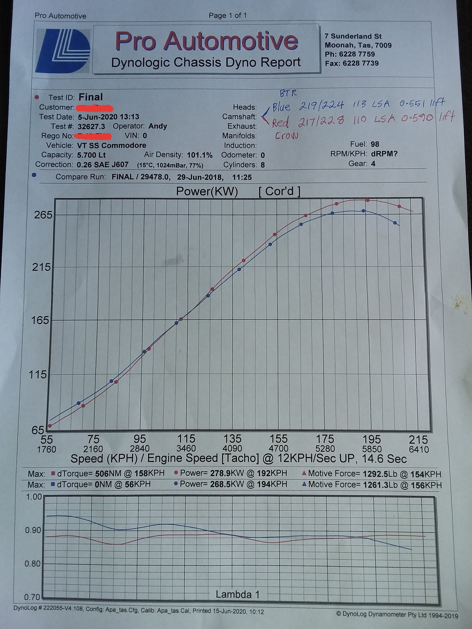

Yes here is the graph overlaid with my previous cam in same car, when I say peak power I mean the point at which the most power is made. Definitely no point in me reving to 6800.

Yes, we are talking the same thing regarding peak power. Wow, ok. That is low. My car surges past that but now that I think about it, my 218/226 actually dropped off like that at similar rpm. It was one of the reasons I hated it after my 214/217 which loved to rev. I can understand why you are looking at a better manifold. LS1 on your VT, right?
Edit: Just dug out my sheets. Unfortunately, the dyno sheet for the 218/226 doesn't show rpm, it shows road speed for some reason. Also, to be exact, the 216/220 peaks just under 6800, where it starts to drop.

Normally any cam in a LS1 will not peak above 6300 even if it's a 230 duration and above cam because the LS6 manifold largely determines this. A hotter cam will still make more power and hold on to it longer but the LS6 manifold becomes a restriction to it peaking at higher rpm. 43 IVC is usually what is needed for 6300 peak (usually 220 plus cam) mine is much less at 38 IVC. What's your IVC?
Actually the results in the test at top of the thread in the video appear to be an exception but see it still flatlines around 6300 and dips up a little right at the end although that is a serious cam with a very wide spilt a comp 231/247 113 LSA
