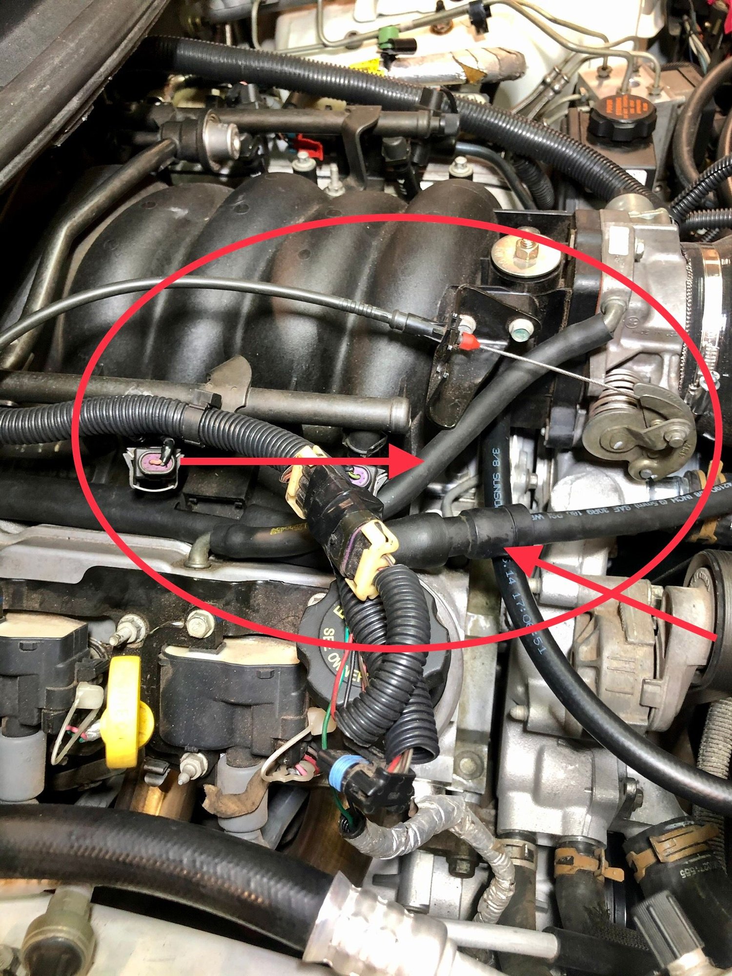

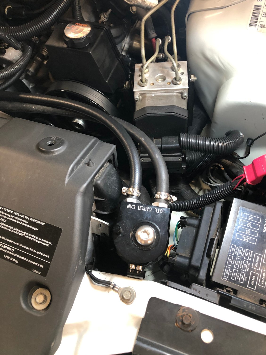

Recently had to install a catch can. Sent it to the shop and they recommended putting one on because I was having a issue with oil leaking. They found it and wanted the catch can added. Since I added it, I went on a 200 mile cruise yesterday and at the end of it my idle was running high. Usually it’s around 750 and it was staying around 2000 for extended periods of time So my question is, would adding the catch can have anything to do with the idle. I ran longer tubes bc I had only one location that would fit this catch can. Sorry if this is stupid but when I change something and something Else happens then 2+2 =4. Most of the time

Not a big fan of the setup but I can't really tell from the pics how your system is routed but it looks like you have the TB capped off and the intake and clean air side of the valve cover going to the CC. What's going on with the other two ports on the VC's? If this is an LS1 then you should have two ports on the passenger side and one on the rear of the driver side VC. In stock form the the rear of both VC's connect to a hose running up to the intake manifold where a PCV valve is in the line just before entering the intake manifold. If there's a leak in the line leading into the intake manifold it will cause higher than normal idle.
If it were me and I needed to run a CC then I would have left the lines as stock but ran the lines connecting the two valve covers to the CC and then from the can through the inline PCV valve and then into the intake manifold. As for the other port on the passenger side it should be connected to the throttle body or the bellow between the MAF and TB.

After looking at the pictures more carefully 01 camarosstx is right. It looks like you have the supply air tube from the throttle body capped off That port is where the supply of clean air into the engine comes from. If the supply air tube is just vented to atmosphere you are using unmetered air which can cause issues too.

Ok I added the PCV valve back in line on the inlet side of the catch can. And then I connected the hose from the passenger side valve cover front 90 to the throttle body. Not sure why this was off. Don’t know if the shop took it off and didn’t forgot to put it back in or left it off for whatever reason. Today I will get out and see if that makes a difference.
when I took it out Sunday I drove about 2-3 miles with everything ok, and then it felt like my foot was on the gas pedal gradually climbing the rpms up even though my foot wasn’t on the gas. I put it in neutral and then it idle up to 3k rpm for a bit. Then went back to down to normal idle after a minute. So I drove it home and parked it. Haven’t drove it since I put the throttle body line and PCV valve back on. Hopefully this helps.

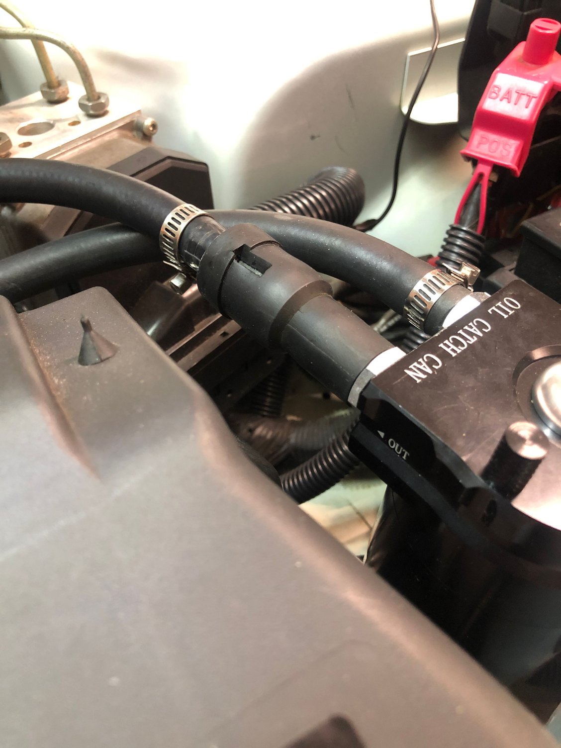

this is how I have it running. So should I move the PCV valve? I have it coming off the long line coming from behind the top back of the intake (where the two PCV lines come together). Sorry, just trying to get it right. .
also in here I put the line from the throttle body to the valve cover? That is good to go? How I have it is how it should be? Thanks again any and everyone for any help
the catch can is sealed pretty good. O-Rings on the parts with arrows and hose clamps on the hoses. So the catch can should be sealed pretty good

The line from the throttle body to the v/c is correct.
If the catch can holds vacuum you should be good as is.
Personally I would move the pcv valve to between the can and intake to be sure.

ok..... so you would move the PCV valve to the exit side of the catch can. So come out of the catch can (on outlet side)/PCV Valve/ then go into the intake? I’ll look into that.
I put the catch can there bc it’s where I could mount it without doing much modification. But I wonder if I got a tall skinnier one that I could fit closer to the throttle body/intake area. And mount it there and it will shorten the lines going to both and maybe that would be good? Not sure if the longer lines have any negative effect on it.

I would move the pcv valve in case the can won't hold vacuum.
The length of the lines shouldn't be an issue.
Make sure the valve is installed in the same direction as stock. It's basically a check valve.
