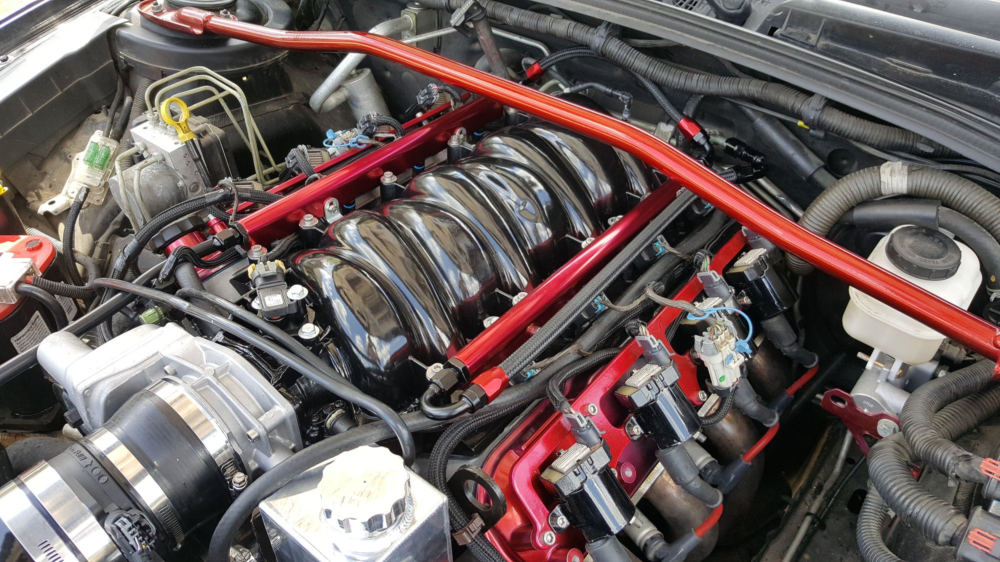

Like said, it should have came with button head bolts for the valley pan. They eliminate any clearance issue.
Mine only needed the typical steam vent pipe "flattening", which is needed for clearance with an LS6 intake as well.
I've had my rails on and off at least 5 times, maybe 6. I hand tighten the screws, and while brass or metal inserts would be a great addition, I have had no issues whatsoever.
I got mine for under $400 a few years ago, and thought then, that it was a very low quality, flimsy piece, but it has been through 3 different engine combos, a couple minor nitrous backfires, and 22+ psi of boost and is still hanging tough, so my original impressions were evidently wrong...
