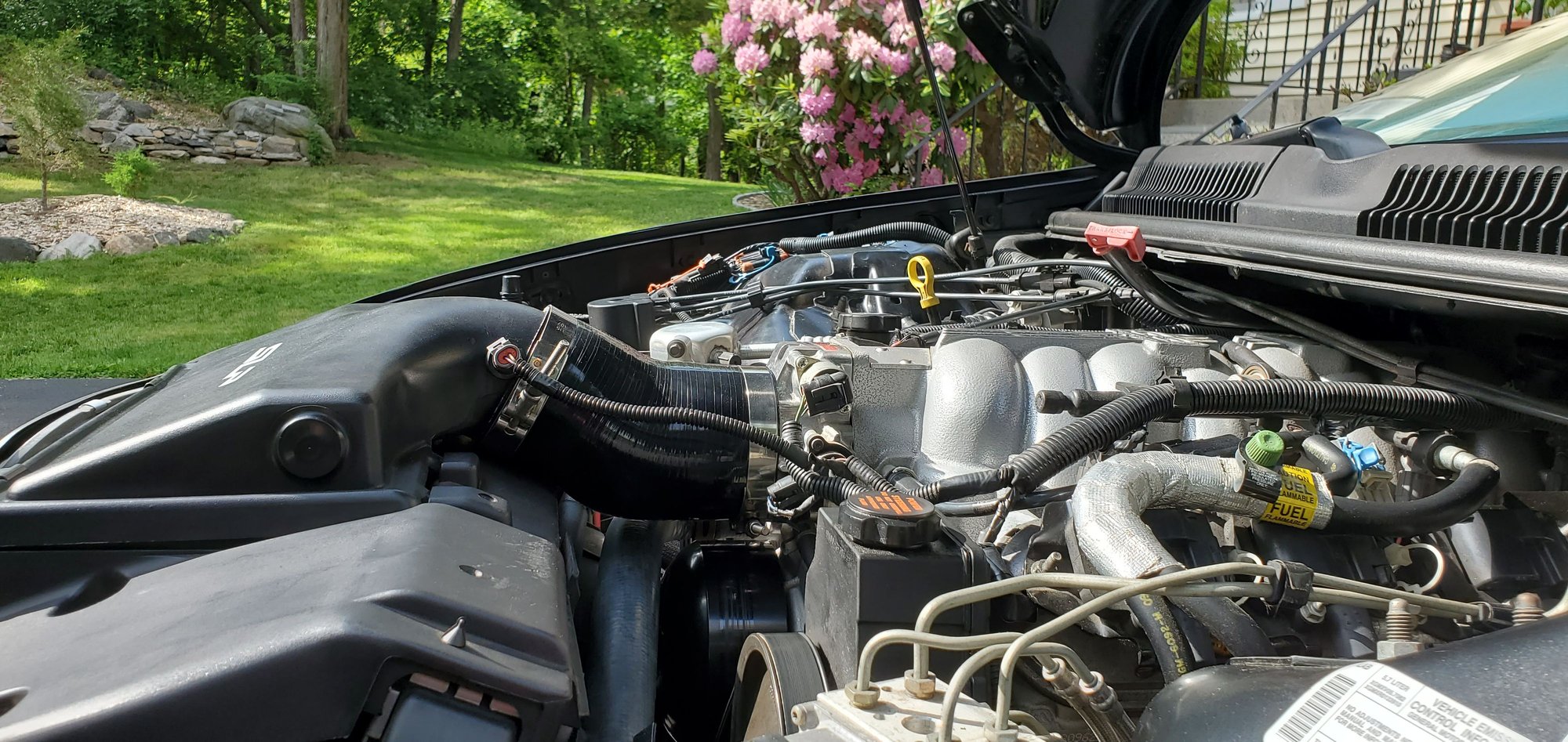

Just wanted to post an update. The intake hose I originally created this thread for didn't work. Maybe if I messed around with it for a couple hours I'd get somewhere, but the fitment was poor. It basically has no give, it really doesn't bend anymore than a straight one. I played around a little more with the 30° coupler I had and got it to work

Looks good man!!
