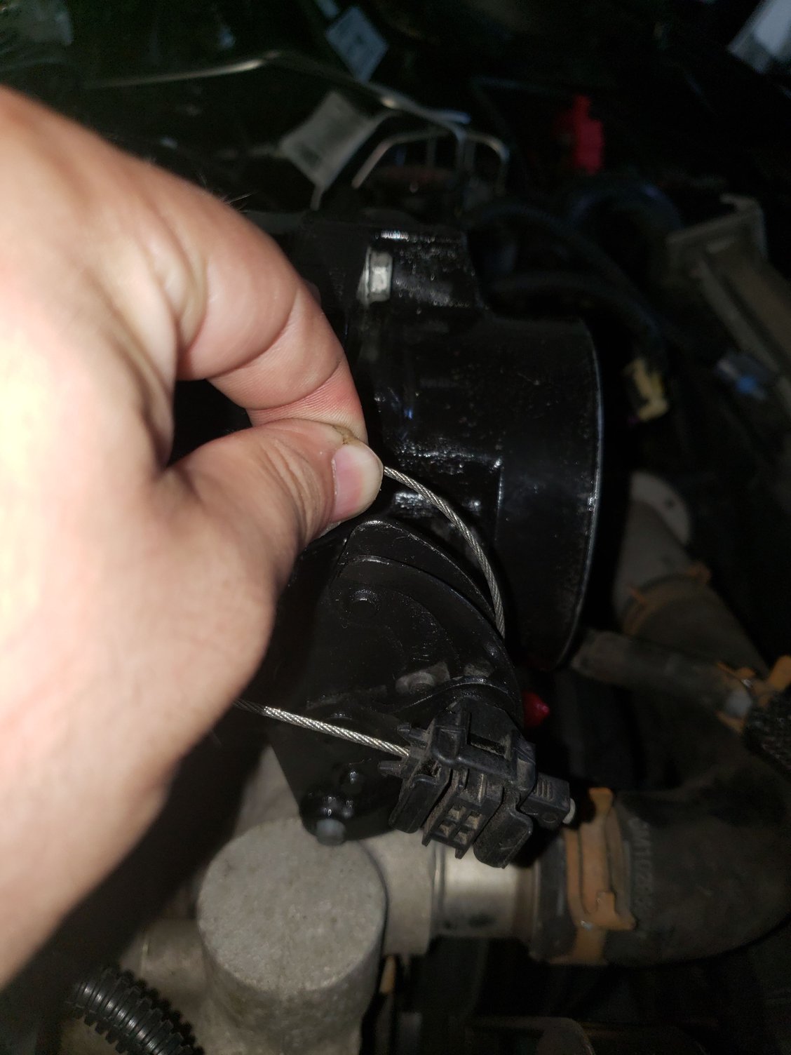

I recently removed my intake manifold to replace gaskets and pulled the throttle cable out of the way. When I replaced everything and checked everything, it seems as if the throttle cable has more slack now. The pedal seems to be a little closer to the floor as well. I don't know how I could have possibly messed anything up by just moving the cable out of the way and putting it back, but I must have found a way. Or maybe just bending that 20 year old wire was enough to stretch it out a half inch or so. Is there any way to adjust this? I've searched forums, but nothing seems to make sense. I have a NON TRACTION CONTROL model, so that adjustment I've found on forums and threads will not work in my situation.
This seems like more slack than before

Yes there is and you'll have to play with the cable adjuster for the one going to the throttle body.

There's actually two of them and the one I'm pointing at runs from the pedal to the transducer or cruise control module and the one below that comes from the module and runs up to the throttle body.
You'll have to remove the plastic locking tab and turn the adjustment wheel to tighten or loosen the cable. I'd start with the one for the throttle body and you may want to have someone in the car to push the pedal to the floor so you can make sure its adjusted for WOT.
I may be mistaken, but I don't think my throttle cable is like that. My throttle cable seems to run from the firewall to the throttle body directly. Is that a traction control version you're pointing at? Mine's non traction control.

You must not have cruise control then so I would try twisting the cable to see if you can get some of the slack out of it. I'd inspect the cable and make sure there's nothing that could be an issue with it though.

That's traction control not cruise control. I also don't have that extra cable with adjuster, because no TCS. I used a couple of fishing line weights on the throttle cable to try to eliminate slack, didn't make much difference. I believe it can be adjusted at the pedal, which would be a PITA.

I think both ends have a swaged ferrule on the end. Only adjustment is distance of clips to where the cable ends hook up, and those are fixed locations. Check that something funky didn't come loose at the pedal side. Also, I've never seen a stock throttle body but I know my Nick Williams throttle body has two positions to hook up cable to the blade, and one of those positions is too short....
