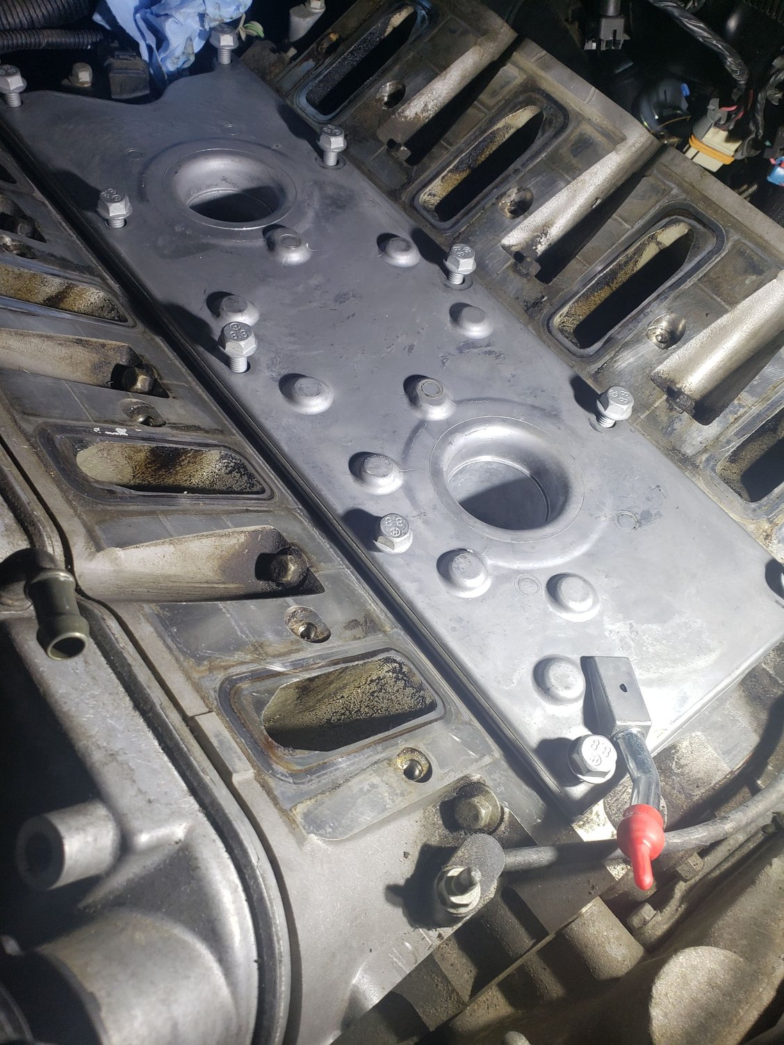

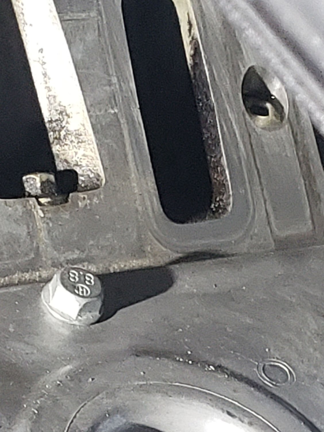

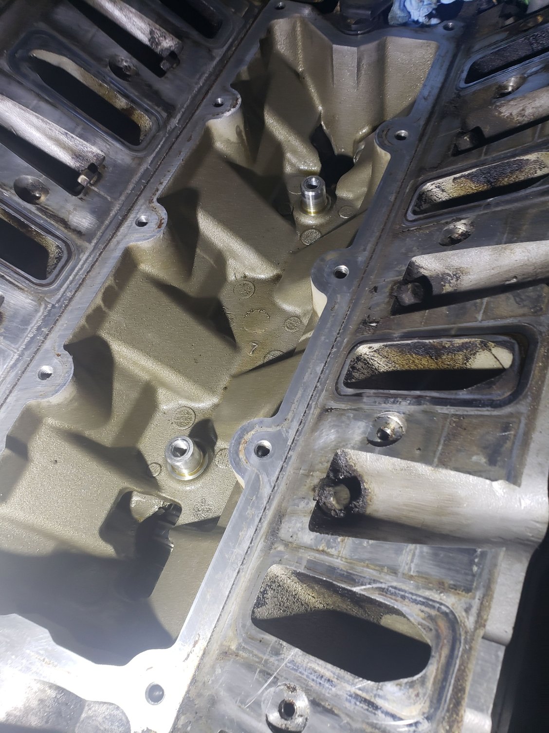

Okay. So luckily I just realized I took some photos of the new ls6 valley cover. I used the bolts that came with the cover. One photo shows a bolt torqued all the way down. I can't believe I took pictures. I rarely do that. I'm going to take pictures of every step of every thing i do in the future. Can come in handy.
cleaned the mating surfaces
valley cover before being torqued down
close up of torqued down bolt.
Does it look like it may cause some small clearance issues?

I think it looks good to me.

Beautiful bolts. Look great. Can't tell A DAMN THING about whether they'll interfere with the intake though.
Look at the underside of your intake and see if there are any witness marks from the bolt heads.

It's possible, but I doubt it. It looks close to flush. If the bolts are in fact interfering, it must be a tiny amount barely flexing the intake manifold. Especially since I never torqued it over 89lbs inch. In any case, I'll inspect the intake since I'll have it off. The buttonhead bolts I ordered recommend 11 ft lbs of torque. I really hate allen drive bolts so I'm going to go with their recommendation over the standard bolt torque spec. I will apply a tiny amount of anti seize as in my personal experience, allen drive bolts round off way too easily. I also6 realized in my photos that the new ls6 valley cover has raised bumps, but they seem to be lower than the bolt heads so I doubt they'd interfere. They look to be as high as the button head bolts would be.

Yup, I bought some. But the more I think about it, the more I doubt it's causing an interference issue. The bolt heads look to be around the same size as the ones that were on the original valley cover.

They may be just as high but they're in a different spot.
