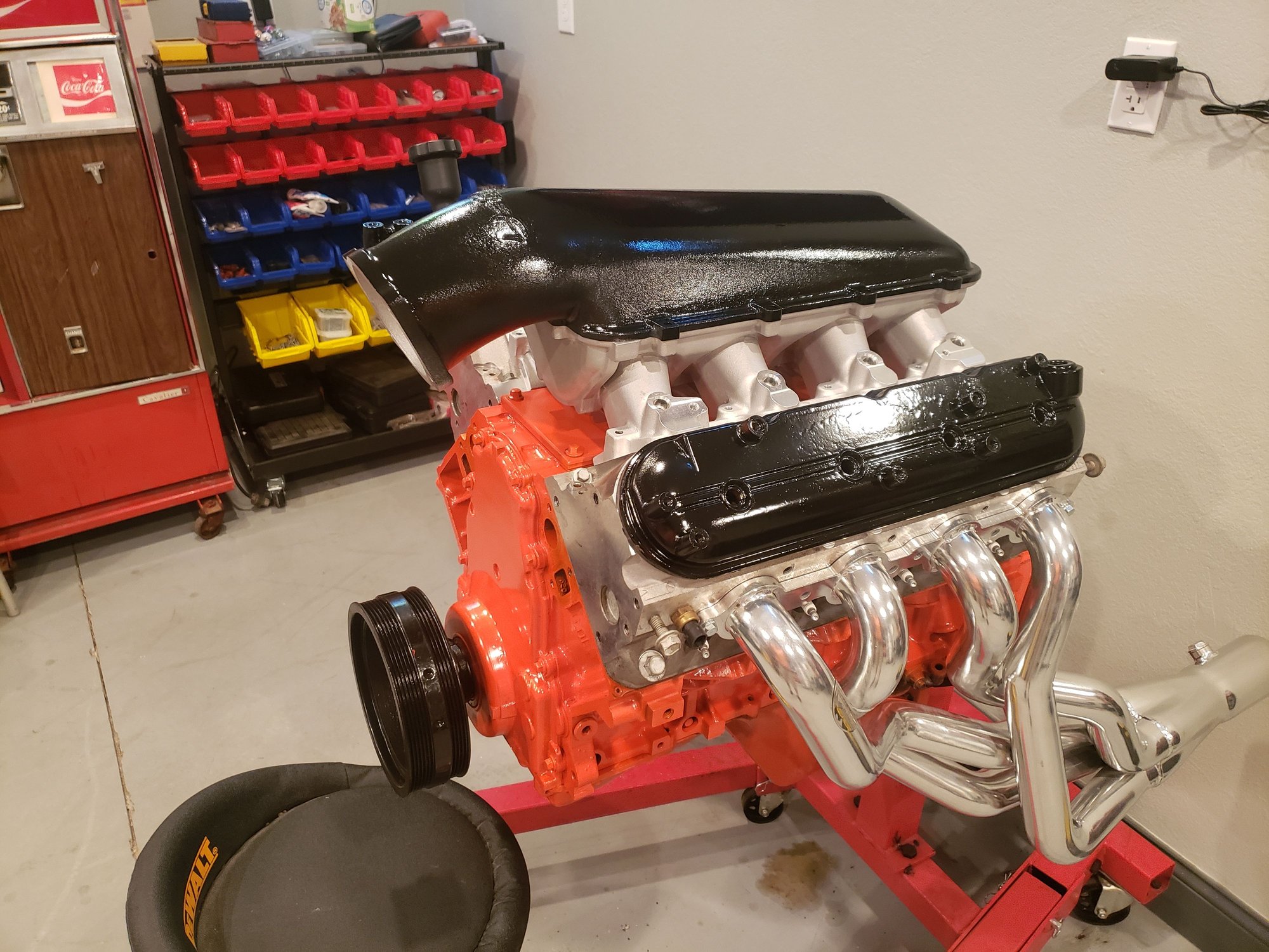

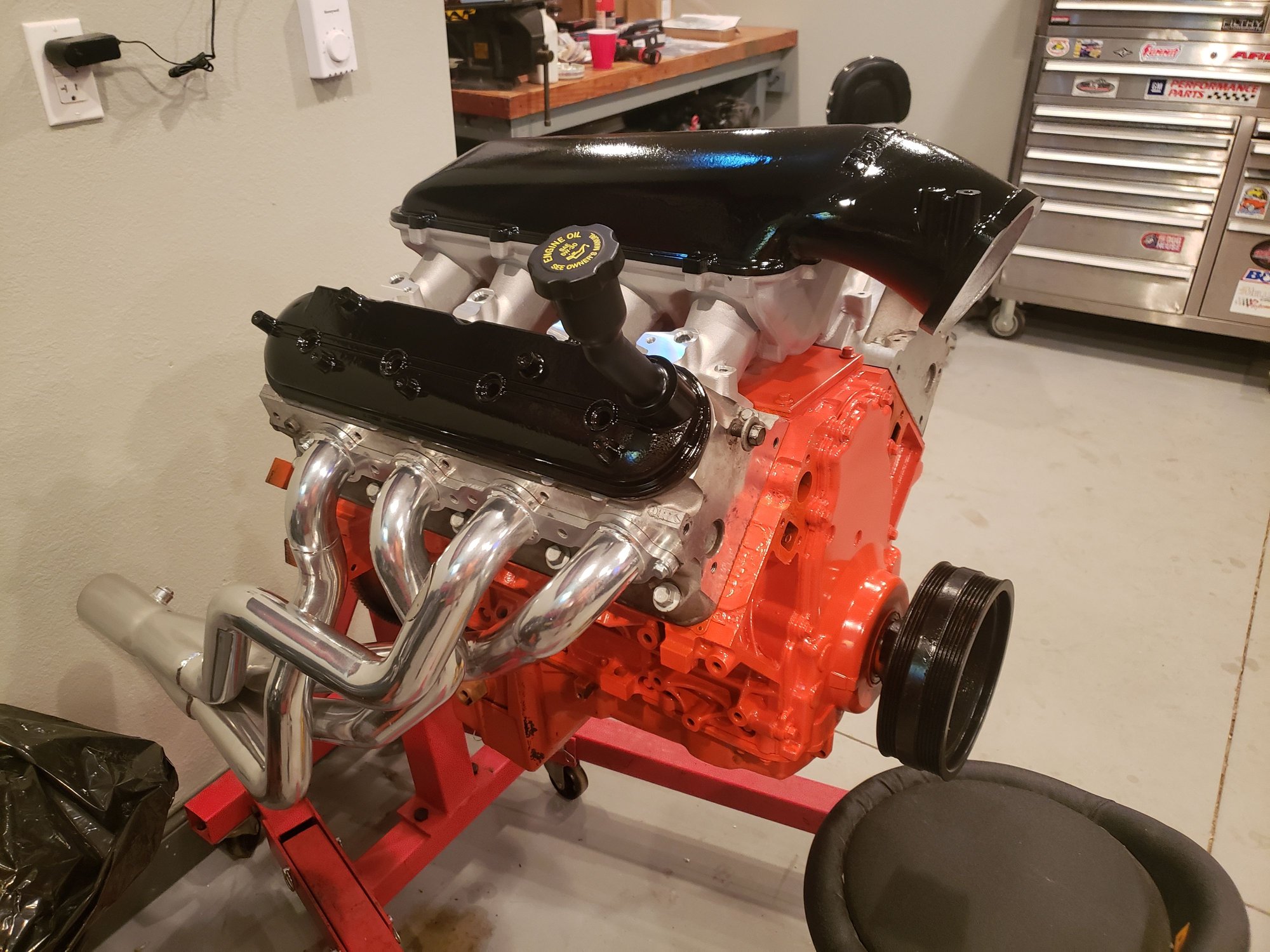

Hi all, I'm new to the forum.
This is my first LS build and to be perfectly honest, I love these motors now that I've had a chance to tear into the LQ9 6.0. Building this for my 68 Camaro.
I've added a Texas Speed cam, springs and rebuilt the trunions. Also added a Holley Low-Ram intake so far.
My questions:
  • Coil selection. I have the old coils from the Escalade it came from but not sure is they will have the output I need for the new build. What style and type do you guys recommend.
  • What throttle cable setup should I use for the conversion being my old linkage is rod design?
  • How about my stock injectors... Will they handle the demands of 500 HP?
I'm sure I'll have more questions but that's
it for now.
Thanks guys!
