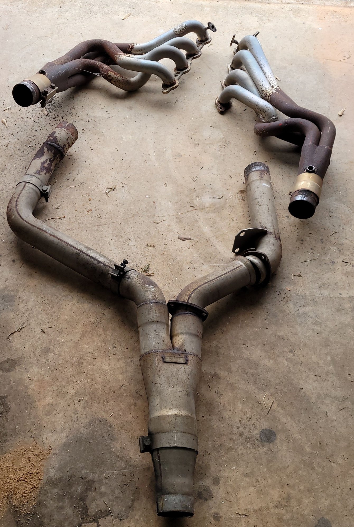

My old Mufflex Y set up is beat up but one can see how the dual 3 inch to 4 inch merge rocks. It would be easy to do a 4 inch cut out and use a reduce for the 3 inch catback.

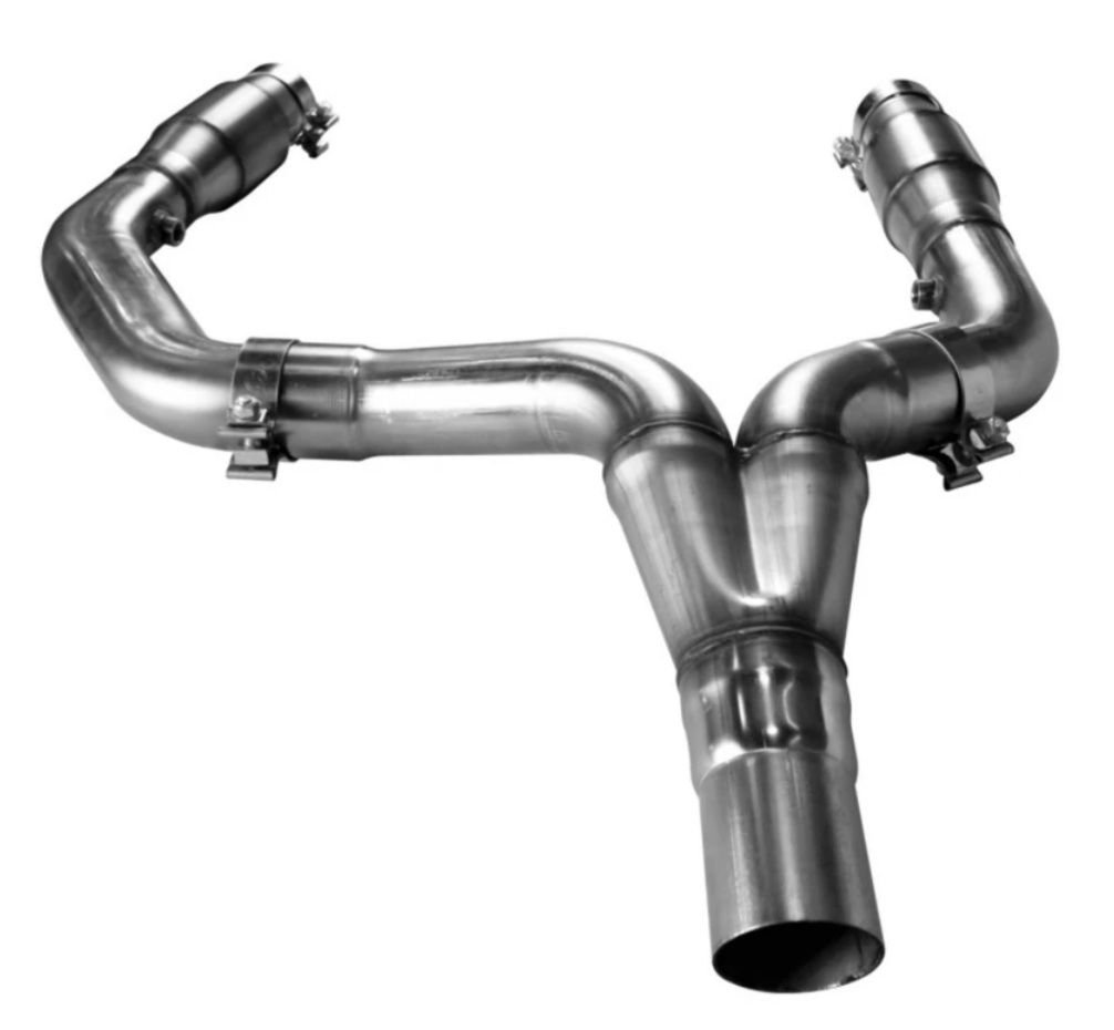

Kook's Y pipe for LS1

Mufflex Y
My old Mufflex Y came with the dual Flowmaster 3 inch to 4 inch collector. Had a reducer for the 3inch catback. Would have been easy to do 4 inch cut out then do the reducer.
BTW - the Mufflex fat merge Flowmaster definitely sounds better than the Kook's Y in my subjective opinion all else equal.
