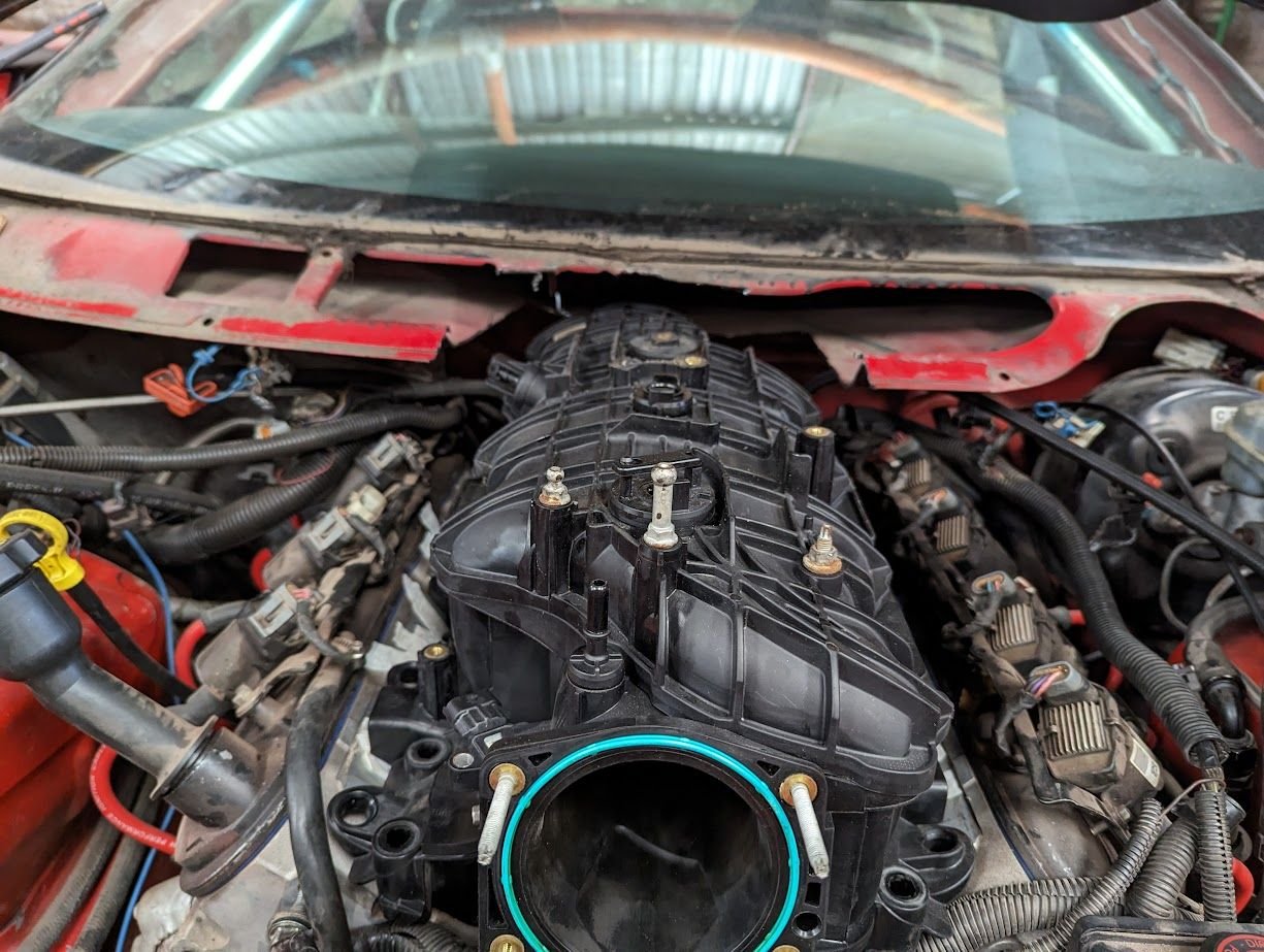

FYI, I experienced the TBSS install. Definitely you cant shave a lot the intake and shave the engine mounts. Take a look at the reference pictures.
Also regarding the wipers, it is almost impossible to retain them. I began taking little by little with care and it is impossible to retain the wipers.
Reference LS6 intake on the 4th gen Camaro
ls6 intake in 4th gen camaro
Now the TBSS intake on the 4th gen Camaro
cutting for the tbss on the 4th gen fbody
tbss fitted
And the hood closes perfectly with the 92mm TB.
