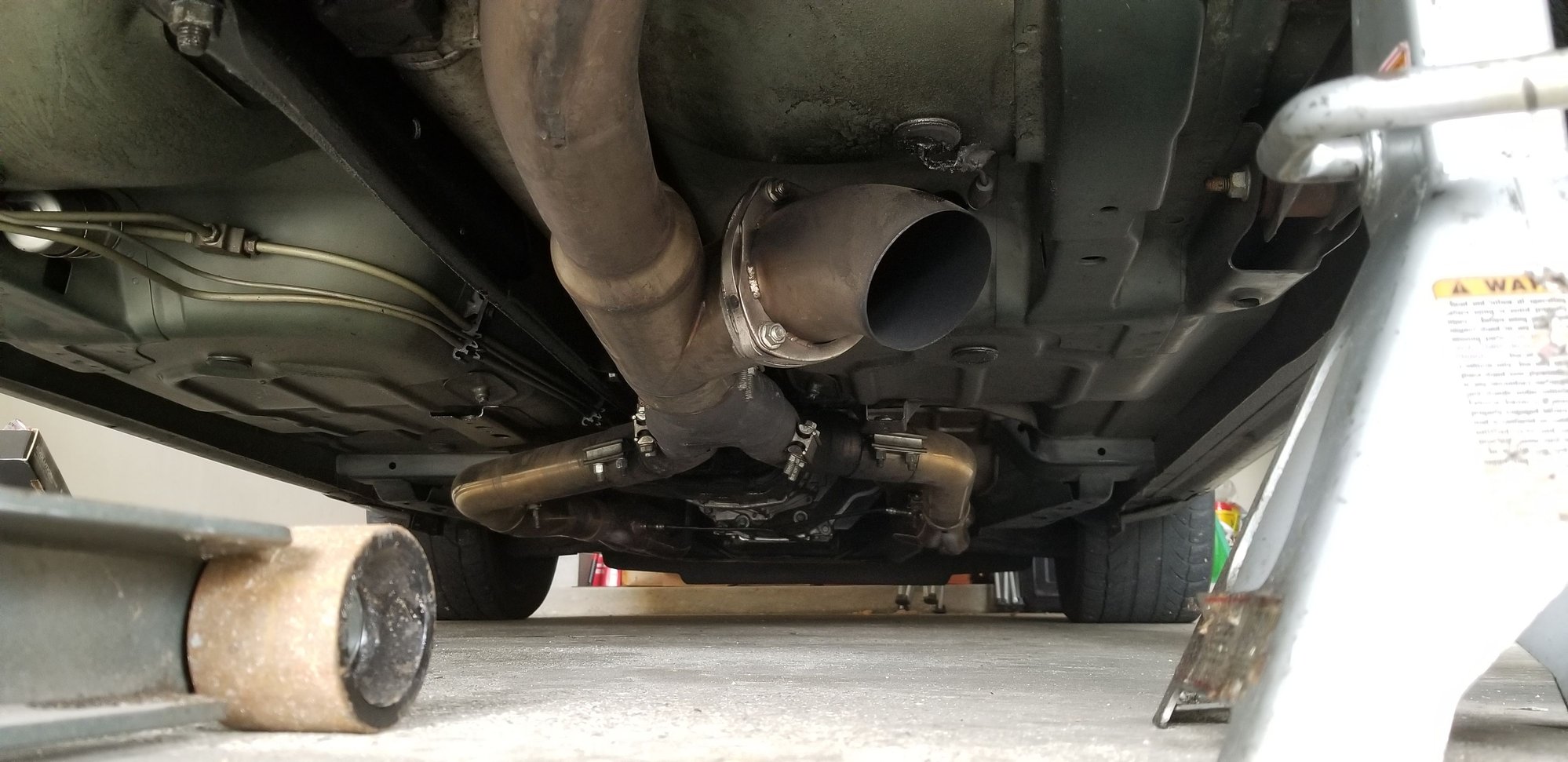

I have a Magnaflow on my car, it flows as good as any 3" setup and is fairly quiet at low RPM, but it gets decently loud at WOT. I also added a Flowmaster 4" merge to my Y-pipe along with a 4" cutout. IMO this is the best Y-pipe cat back setup you can do with these cars, unless you want it loud all the time.
Did you notice any sound difference when you added the 4" merge? Any sound clips of your car? I've been wanting to chop my Y pipe and put in a 4" merge and swap my magnaflow catback to a 4" mufflex/magnaflow.
Just to be clear, I still have the 3" Magnaflow behind the 4" cutout, I do not have the Mufflex 4" with a Magnaflow muffler on it, which is much louder than my setup.
I didn't notice much difference in sound after switching to the Flowmaster merge. However I don't get any sort of rasp in that 1800-2500 rpm area that a lot of Y-pipe setups have.
I think I have a sound clip somewhere, I'll see if I can post it on Youtube and get back to you on that.

Here's a sound clip of my setup with the cutout closed. TSP 1-7/8 headers, Flowmaster 3"-4" merge, back through a Magnaflow 3"system.
