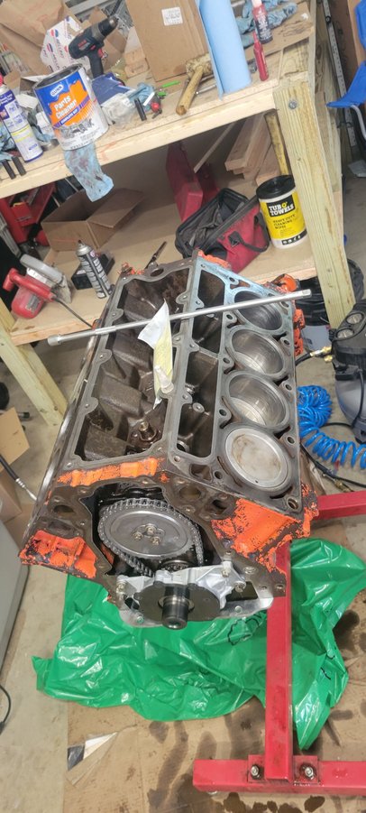

Here's a photo of the engine right after I put the oil pump on, you can see the position of the pistons and the cam gear.
