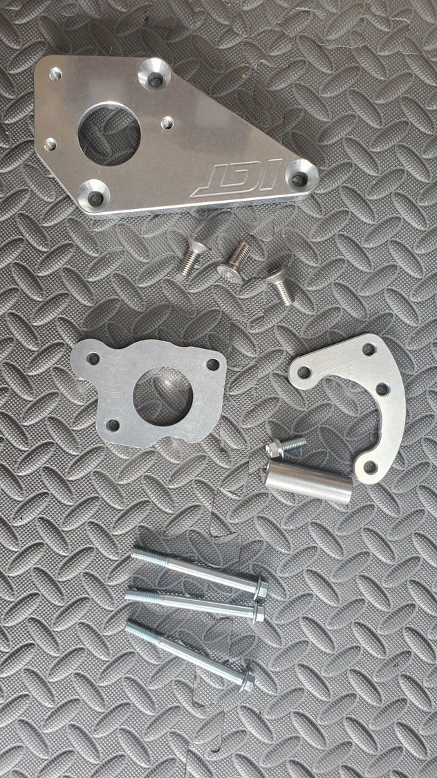

heres how the bracket sits without the resivoir on it, but you will need to mate the two together before installing it.

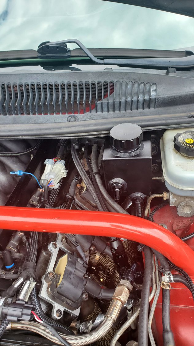

for my car i went with the black aluminum resivoir, there are clear plastic and silver aluminum if you want.

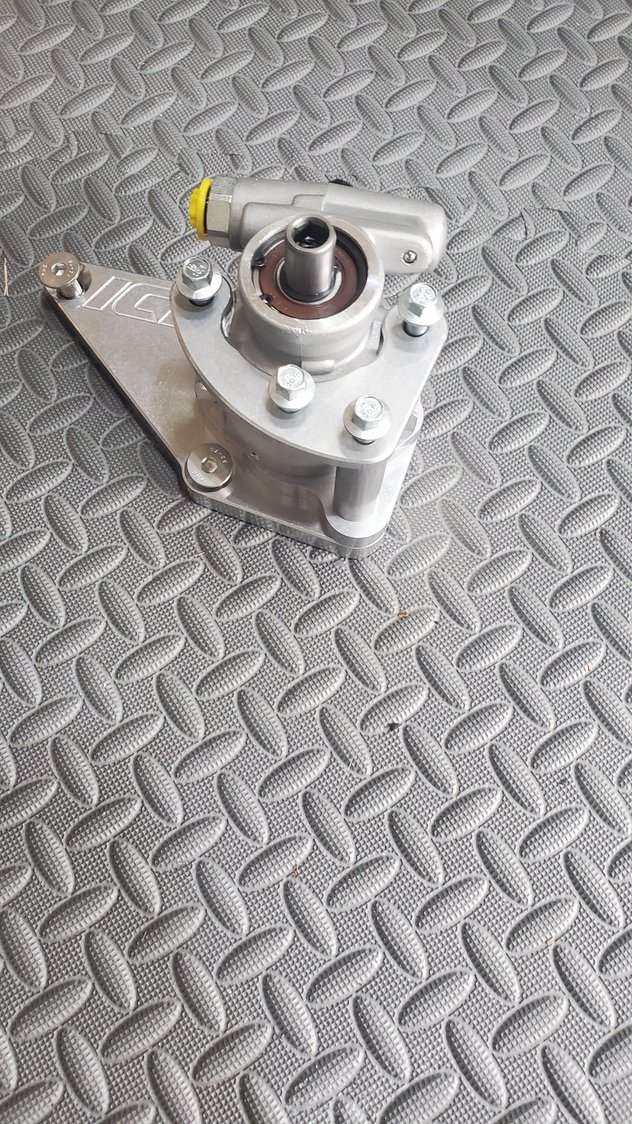

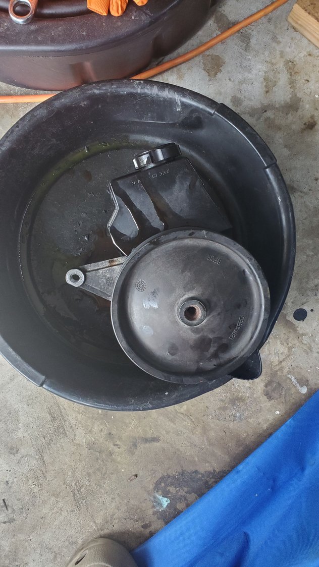

heres the old pump coming out. normally you will need to reuse the bracket, bolts, and spacer from the original pump.
heres the old unit

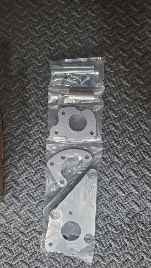

i elected for a cleaner look with ict powersteering bracket, that can be used with the stock ls1 pump or the corvette pump. does not come with nicks kit.
i also use the CBR braided lines due to being a turbo car, but the kit can be used with stock power steering lines, but i highly recommned the CBR lines for cleaner look and if you plan on turbos later
it seems like a lot of pieces but it really isnt. The ict bracket is more for those that are doing ls conversions and dont have the stock hardware. you dont need this, but it makes it easier and cleaner, and gives it a little bling under the hood
what the vette pump is all together with the brackets. you cant put it on the car like this, but you can see how it all fits together.
heres the sexy new pully that comes with Nicks kit. make sure the letters are facing out.
heres another look before mounted
first you install the main bracket with the counter sunk allen bolts
here you have the rest of the hardware and new pump

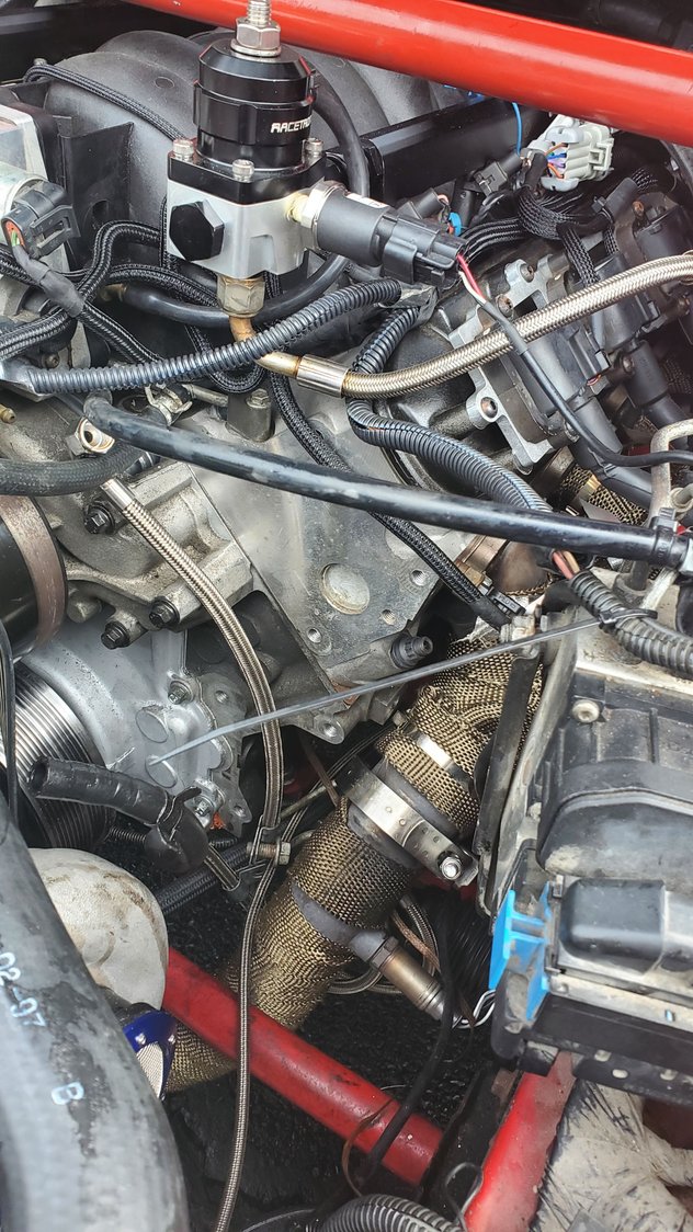

for those that are using the CBR braided power steering lines, make sure you get your an fitting back out of your old pump so you can install your hoses on ypur new pump
heres a good shot od the hoses and new main bracket
New pump installed on the bracket. nice thing about the new Ict bracket is that its all 10mm excer the allen bolts.
installed threaded hose on pump.
i installed the large hose first, secured with hose clamps. as you can see, i have a bit of other stuff running in this area and it still fits. Those that are not running turbo reference tubes, will have way more room.
here you can now see i have installed the smaller hose, the kit comes with a hose extention that splices right into your exisiting hose with hose clamped.
Once I get the pulley installed, I'll up date the post. as well as videos to go along with the install. for now enjoy!

This design doesn't make any sense. It routes flammable power steering fluid directly over the header which at a minimum, heats the fluid. At worst, it increases risk of an engine fire in the case of a leak. Also clutters up the engine bay further. I wire tucked mine, hid my coolant hoses, and spark plug wires/coils to clean up the engine bay.
Whats wrong with the stock pump anyway

these pumps are better , i do wish an option existed to mount the lines down on the frame rail and then back up so its more hidden .

I think running the hoses clutters -up the engine bay more. That's just my thoughts. Kudo's for doing the mod and doing it how YOU want! Different vehicles, different setups, different ideas= hot rodding!
I prefer the look of my setup with very short hoses

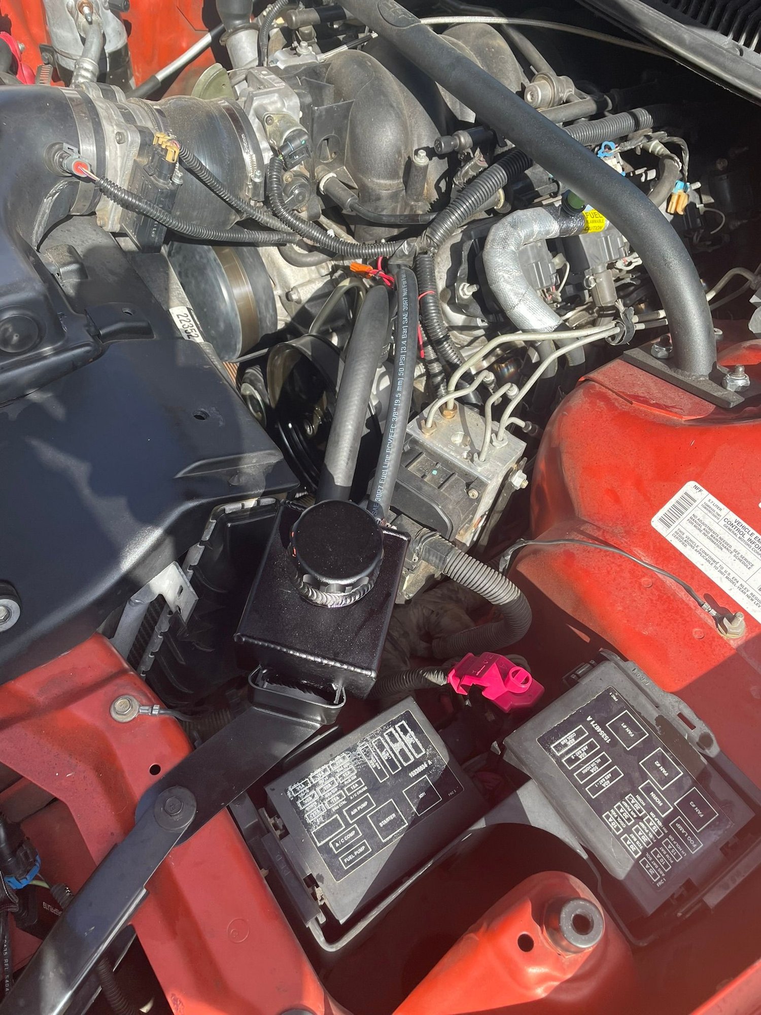

Nick now has a front mount for the reservoir. I feel this is a cleaner option.

From: Saucon Valley, PA
That is clean!
