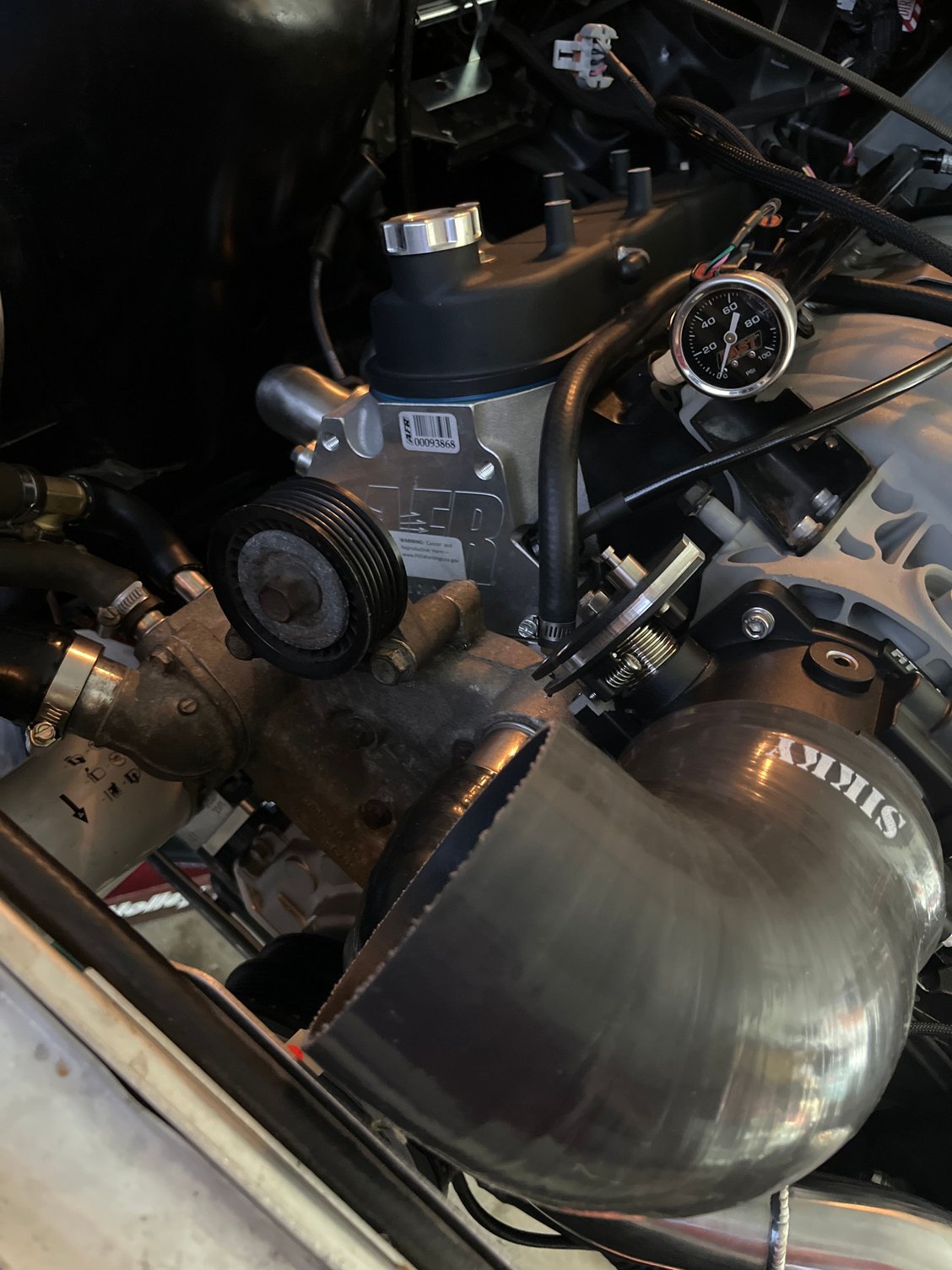

Hi everyone I’m currently in the middle of a ls swap in my e36 m3. The top of the water pump belt tensioner gets in the way of my intake piping because of where my coolant expansion tank is mounted. so I want to relocate it. I couldn’t find any easy kits so does anyone have any ideas? (Fbody accessories). Also no a/c at the moment but maybe in the future.

compressor should fit that’s not where my issue is but that’s for later as my oil filter is mounted where it goes. I would love to go left but my upper radiator hose is in the way so now it seems like making that tensioner go away or relocation my expansion tank are the best options. If there’s nothing on that tensioner then expansion tank relocate it is.

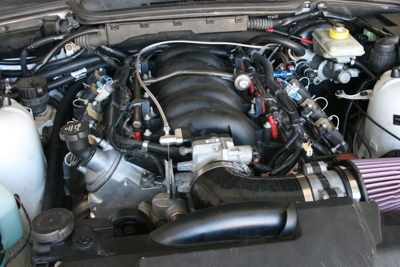

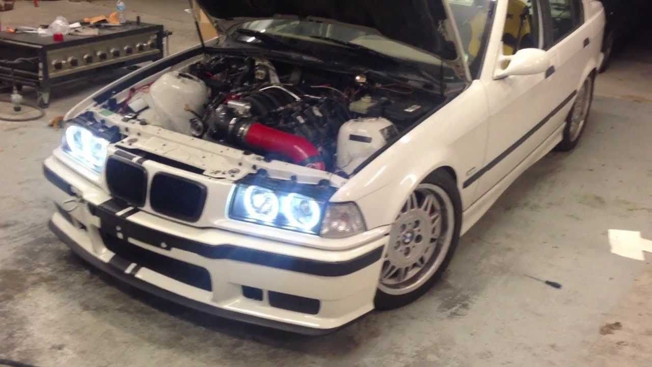

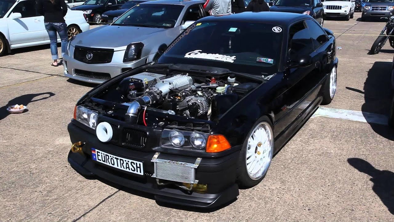

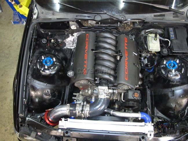

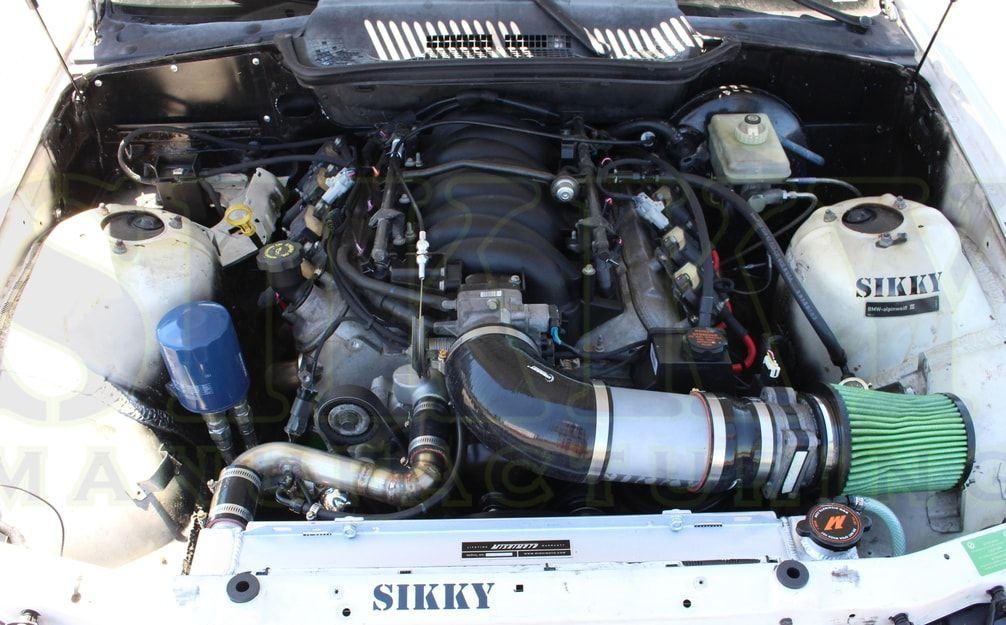

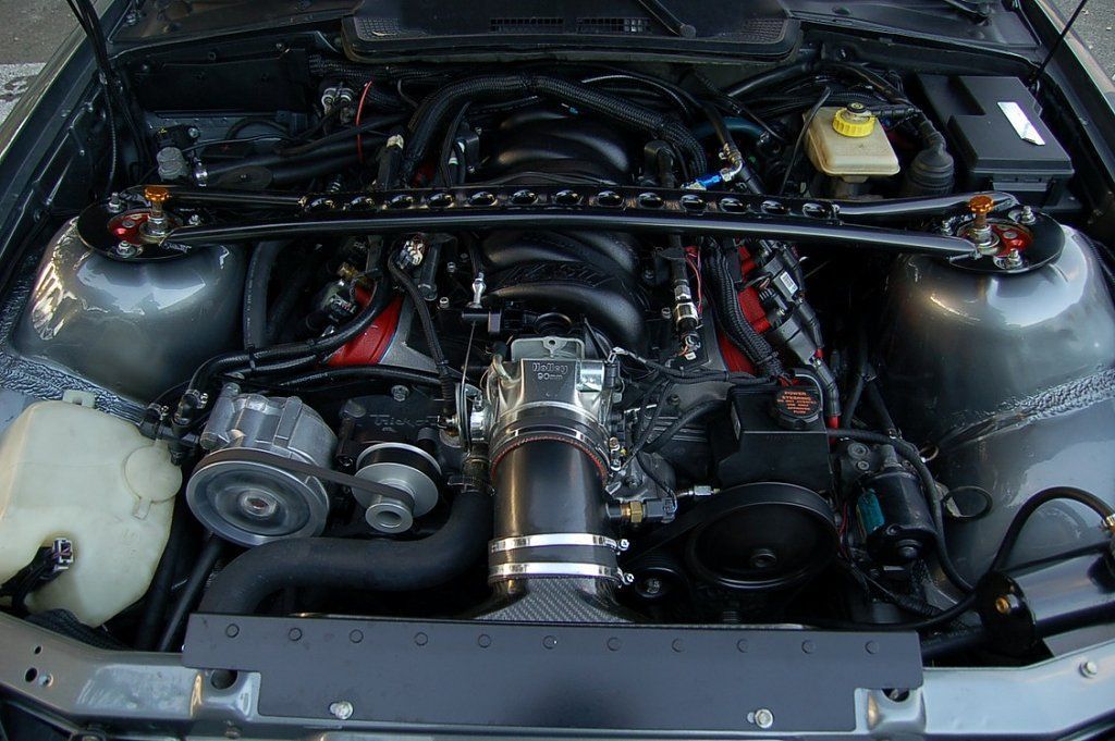

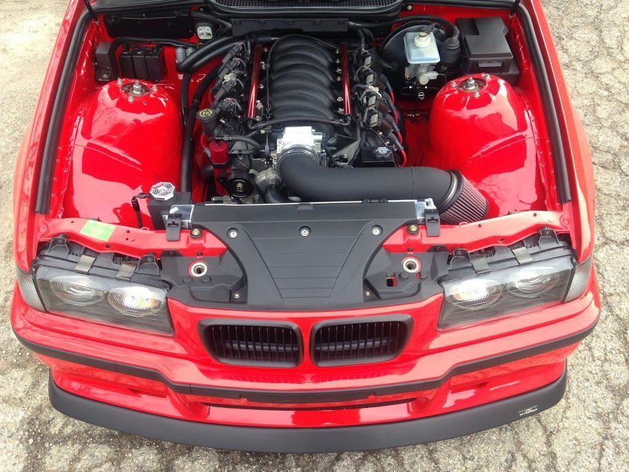

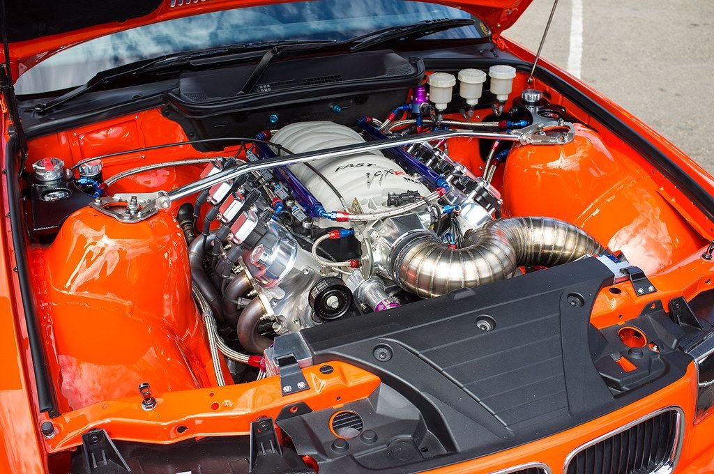

A quick Internet search for "BMW E36 LS swap" and a click on the "images" tab shows lots of lefties, a few righties and even fewer up over the middle.
This one should look familiar. Same logos as on your silicone elbow hose. Maybe same oil filter location. But it does have a different radiator. Leftie
Very clean and well done. Leftie
Leftie
Leftie
Leftie with weird filter
Leftie

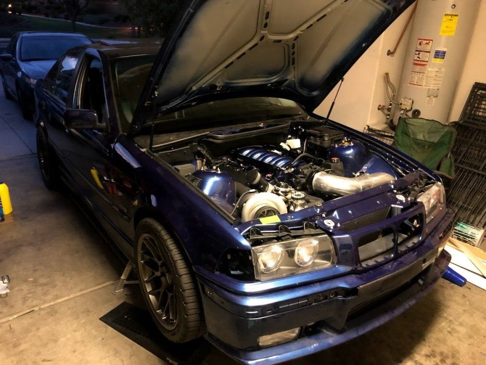

Rightie turbo with leftie boost pipe to throttle body

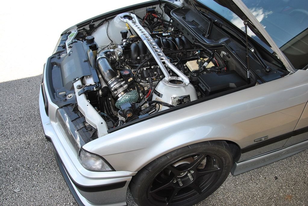

Rightie
Front and center
Front and center to supercharger. Not sure I'd copy this one. WTH is that white toilet seal doing on the right side of the grill? Not impressed with the oil cooler either.
Just some ideas for you.
PS. Sometimes I wish the Internet was as helpful with my projects as it is with others. Searching for images for "1947 DeSoto LS Swap" or even "DeSoto LS swap" gets almost nothing.
Leftie
Leftie
Leftie
Rightie
Front and center
thank you for the inspiration. When I get home from work I’m going to try to get “creative” with my radiator piping to see if I can get it to go left. The righty you posted uses the same rad hose kit I’m using and you can see how it curves up in the the worst possible spot to put a 4 inch intake over, But it seems like he somehow got that pulley out of the way on the right side to free up room I wish I could see his accessory drive setup. My abs pump is located right where most of the “lefty” guys put their filter so looks like I’m gonna need to use my thinking hat. I’ll post more pics of my setup when I’m home. The first lefty with the sikky stickers is what I would like to do but the radiators with outlet/inlet on the right side (that fit easily) cost 1,500 + (
