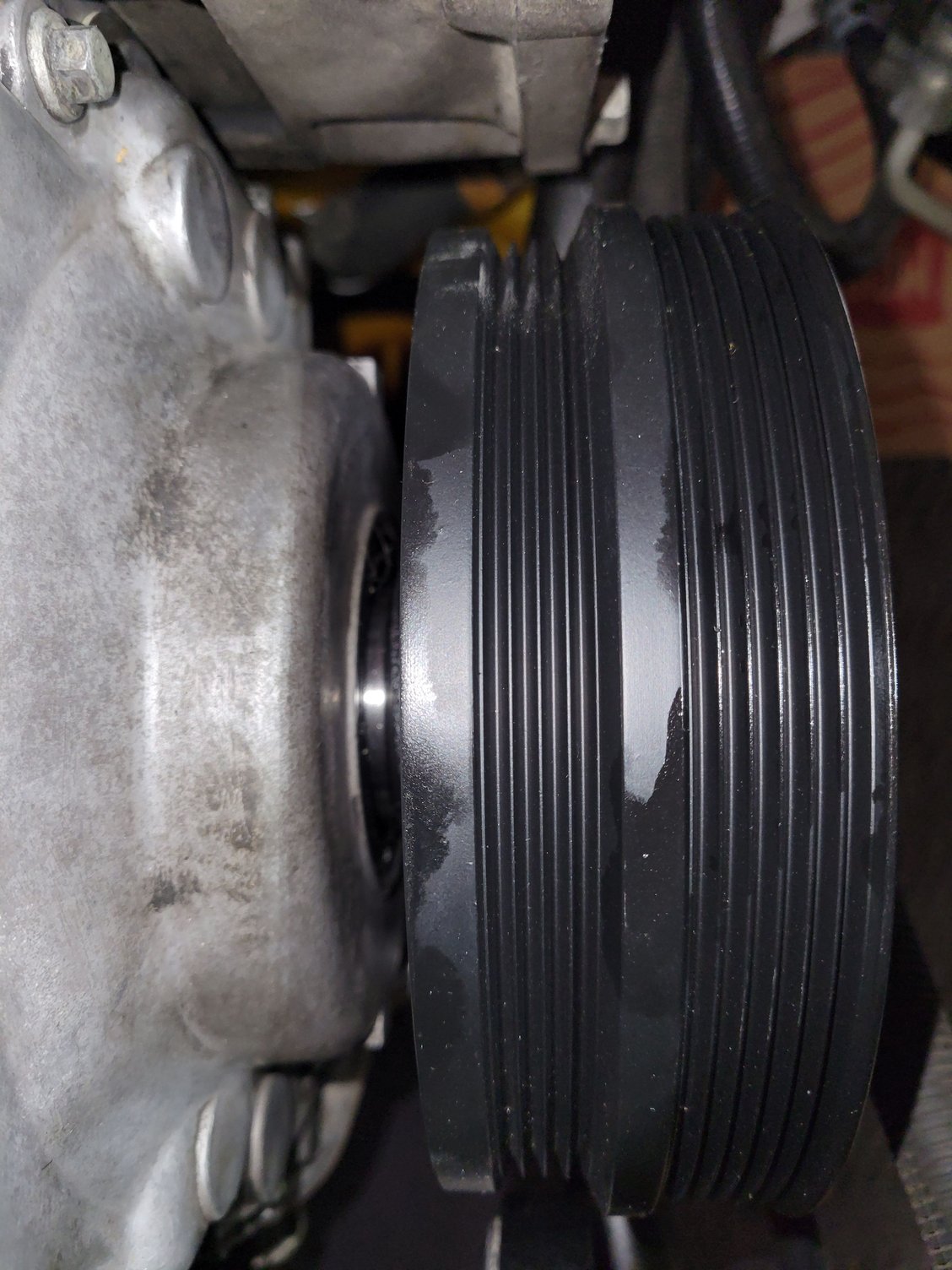

hello, im kinda new at this ls1 thing. im reinstalling my balancer, i bought an install tool, but i dont really have the resources to ability to put correctly torque the balancer bolt. i have read multiple how too's that say just get a few good "ugga ugga's' with my milwaukee high torque impact gun and it should be fine. to me it doesnt seem to be fully seated, here are some pictures, please tell me your opions

that is not fully seated. What install tool are you using?? You should be getting enough clearance from the bottom if you did not remove the radiator (doesn't sound like you did) then it is tight but you should be able to install the balancer and torque the bolt

Using the install tool and if its bottoming out you may have it installed properly. If the accessorie belt doesn't line up to the accessories you have an issue.

I used the Summit tool and cranked till it would crank no more. As soon as the pulley squeezes the lower cam gear up to the crank it wont go any farther. Pop a belt on it and and check alignment. Youll find out right quick how things set.

When the balancer is fully seated, the nose of the crank should be between 1 and 2 mm below edge of hole in the balancer.

looking further into this, it looks like the aftermarket balancer (a doorman 594-127) is about an inch shorter than the stock balancer. so, the snout of the balancer does not go into the timing cover seal. will this be ok ? because it does appear that the belts will line up

looks like it lines up, but if the snout of the balancer doesnt go into the crankcase cover past the front seal, is that ok?

My install tool was being a brat on my last install dogged up on me I think I had an 1/8th to go for it to be seated I took my harbor freight breaker bar with a 2ft cheater and cranked it the rest of the way on with the actual new bolt bouncing all of my 150lb weight on. If you don't apply a good amount of torque you can bet on it coming out. But from the pic it appears you have the ac belt on lined up pretty well or no? The shiny gap looks a bit much tho

Yes the belts appear to be lined up, I can swear that this balancer (doorman part 594-127) is an inch shorter (3 inches, and the gm balancer is 4). But all the cross references show this is the right part.

Hey all, thanks for the help, the car is back together and running great, I guess the balancer went in correctly.
