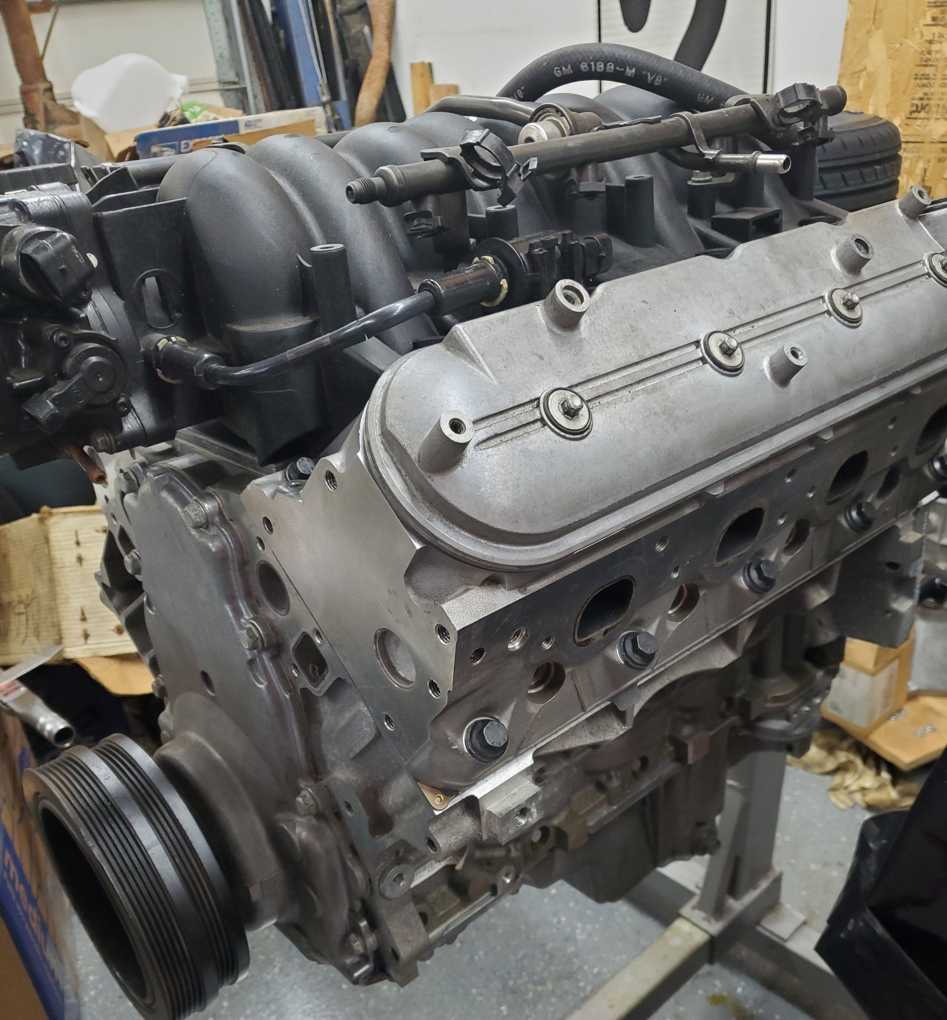

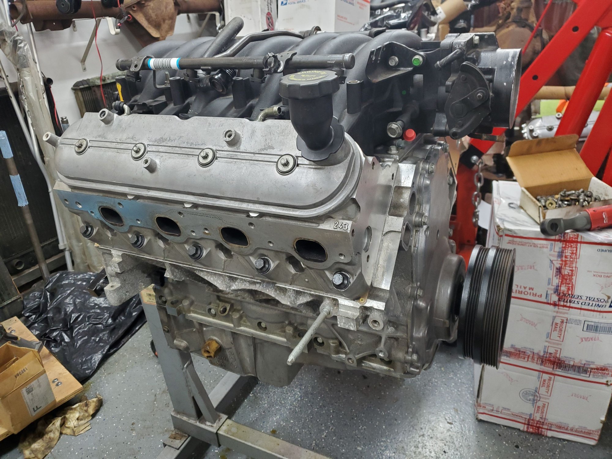

Here's where I am, the plastic line from intake was split and been replaced already - nothing bolted up on intake yet will be a real LS6 heads, cam off buddies '02 Z06
Old Mar 21, 2023 | 03:13 PM
sjsingle1's Avatar
Joined: Feb 2010
Posts: 6,761
Likes: 292
From: Fort Worth TX
looks good to me
