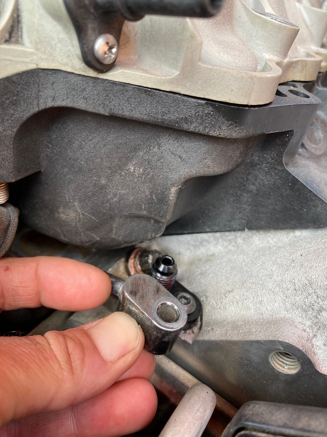

I was making my own out of metal t’s and hose to work with my fast 102 was going ok until it was hitting the driver front corner I tried tapping the fitting down with some heat but it cracked. I know the later models the rears are blocked has anyone ran a hose from head to head in the rear without going to the front? Was thinking about going to the junk yard and getting the front style but running the hose in the back. I searched and haven’t found anyone doing this. It’s got to be better than blocking it completely off right?

This is what I was making but the fitting cracked on the driver front.

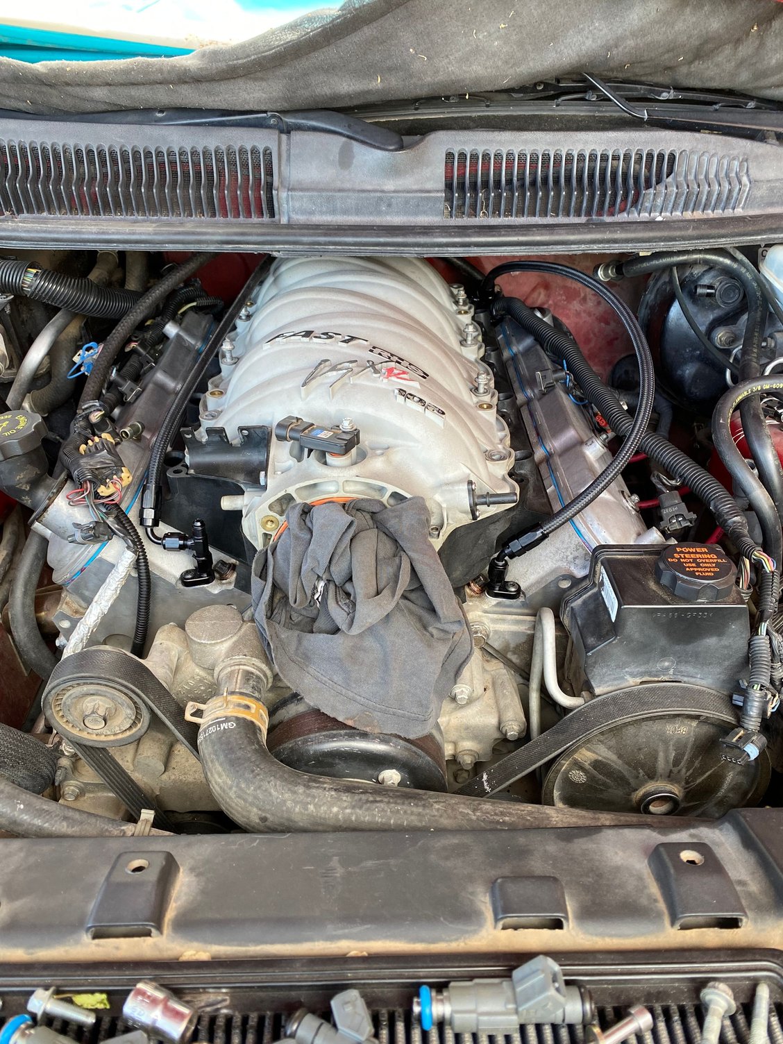

This is the garbage I’m putting on now had to order more hose because none of it is the correct length.
I asked about the hoses going side to side because I was thinking about getting the later style and just doing that I figured it might be slightly better than just blocking them. So side to side on the rear and the new style crossover on the front.

On mine I ran front-to-rear on the pass side only; across the back with a tee on the pass side, and across the front with tees on both sides. The one on the driver's side goes to the coolant bottle. (truck, in my case) I used PTFE line because it's so eeeeeezzzy to work with, black fittings like yours, and put split-loom such as for wiring on the lines, to make it mostly disappear.
That rubber line kit IS pretty weenie...

Not really. The important direction is back to front which happens in the heads if rear lines aren't used.
There is no side to side flow even if you linked the back of the heads.

I gotcha hopefully this crappy kit works.

The intake isn’t tightened down here but it was hitting the pipe and almost the top corner of the thing. It’s extremely close to the black one that’s on there now when I put the hose on. This picture doesn’t really show it unless I put the old one back on. It’s only the driver front that’s the issue.
