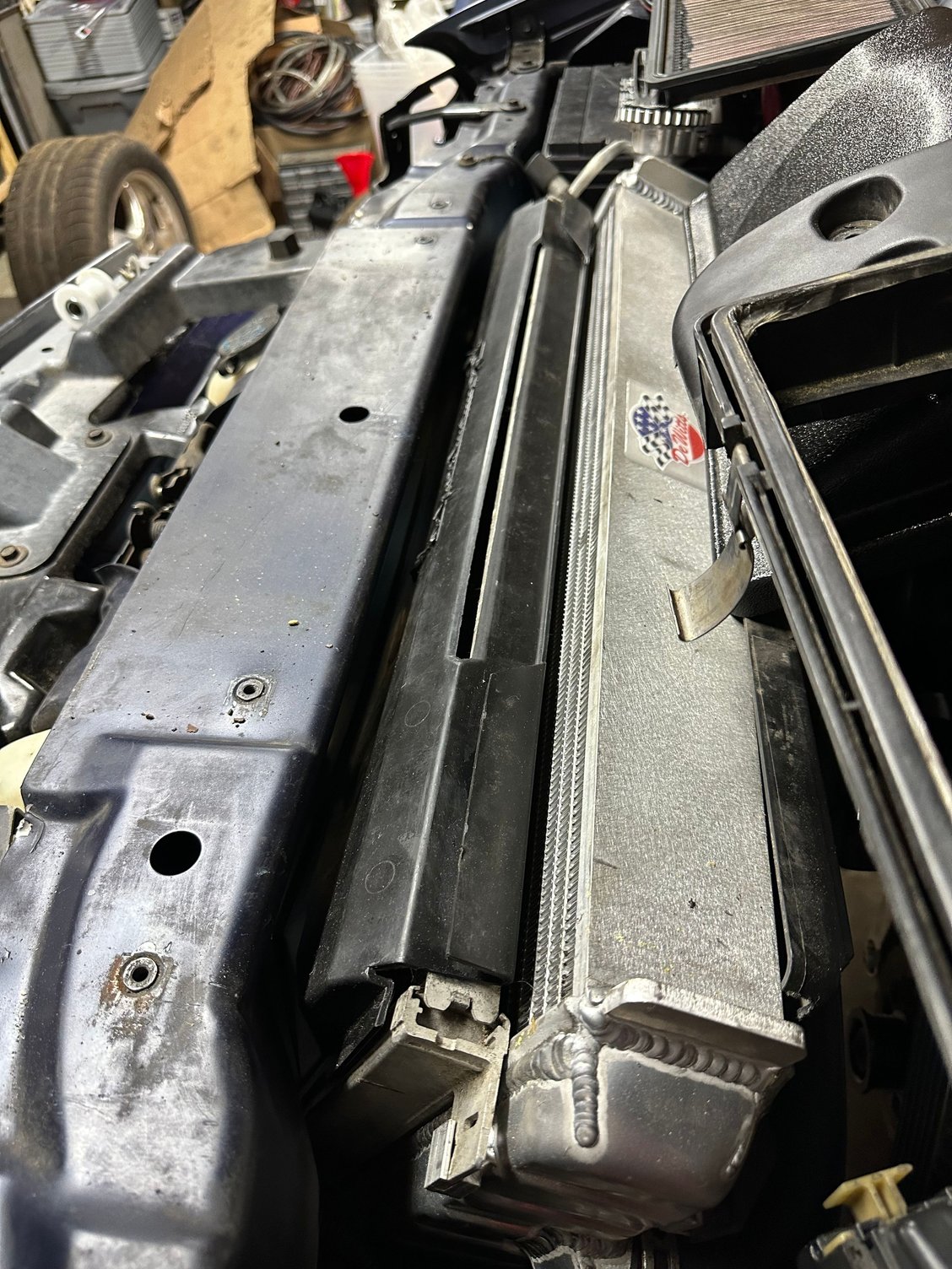

Yeah, I know — just trying to figure out if it’s worthwhile in conjunction with a 3” radiator.
I opened things up tonight to take a look:
There’s pretty much zero room. I assume with SSRA that you are supposed to remove the black plastic shroud that brings air up to the AC condenser, and the SSRA goes there? If true, then I think it might fit, but we’d be compromising flow through the condenser and radiator somewhat heavily.

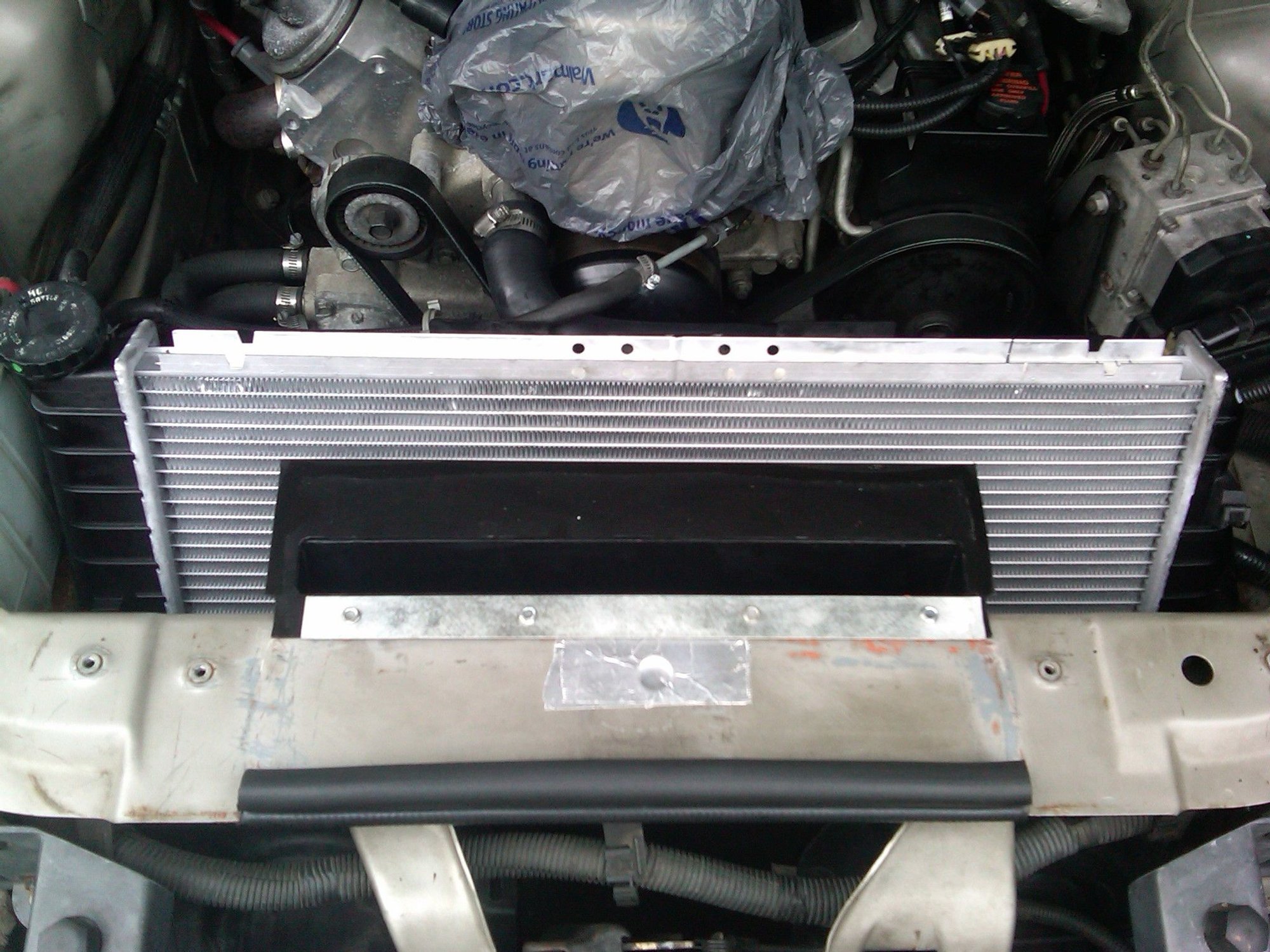

The megamouth will fit with an lt1 radiator. Trim the stupid tabs off of it that rub against it. No way it will fit with a 3" rad without serious mods. The ac version may fit though.
Old Aug 24, 2023 | 11:44 AM
Bspeck82's Avatar
Joined: Jan 2017
Posts: 1,758
Likes: 442

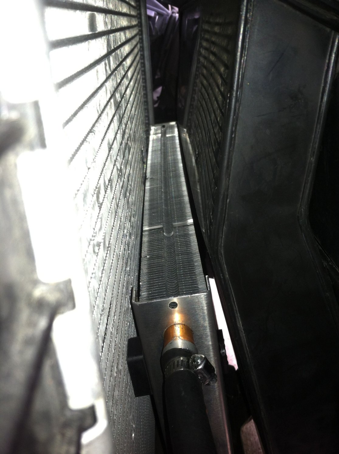

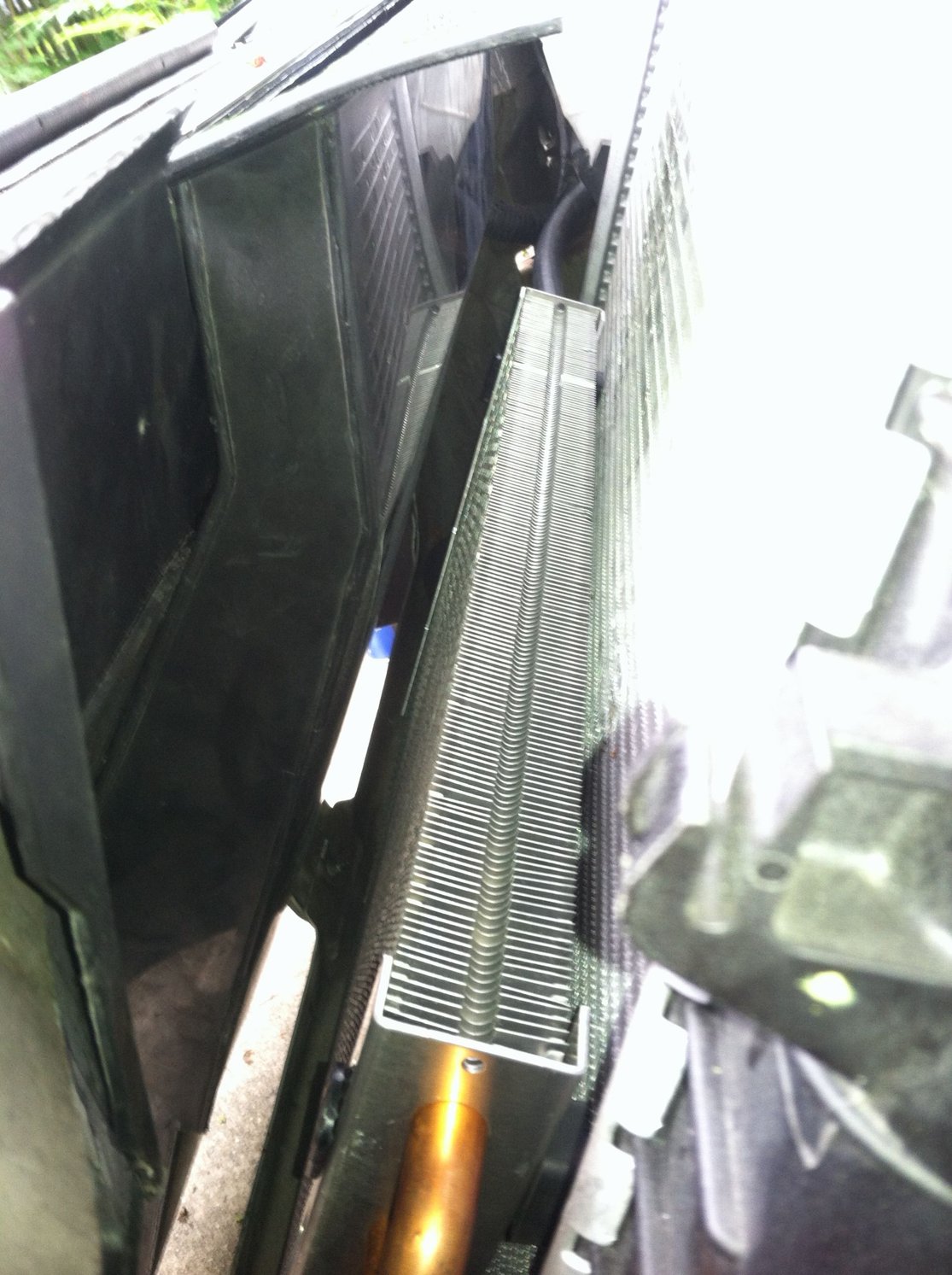

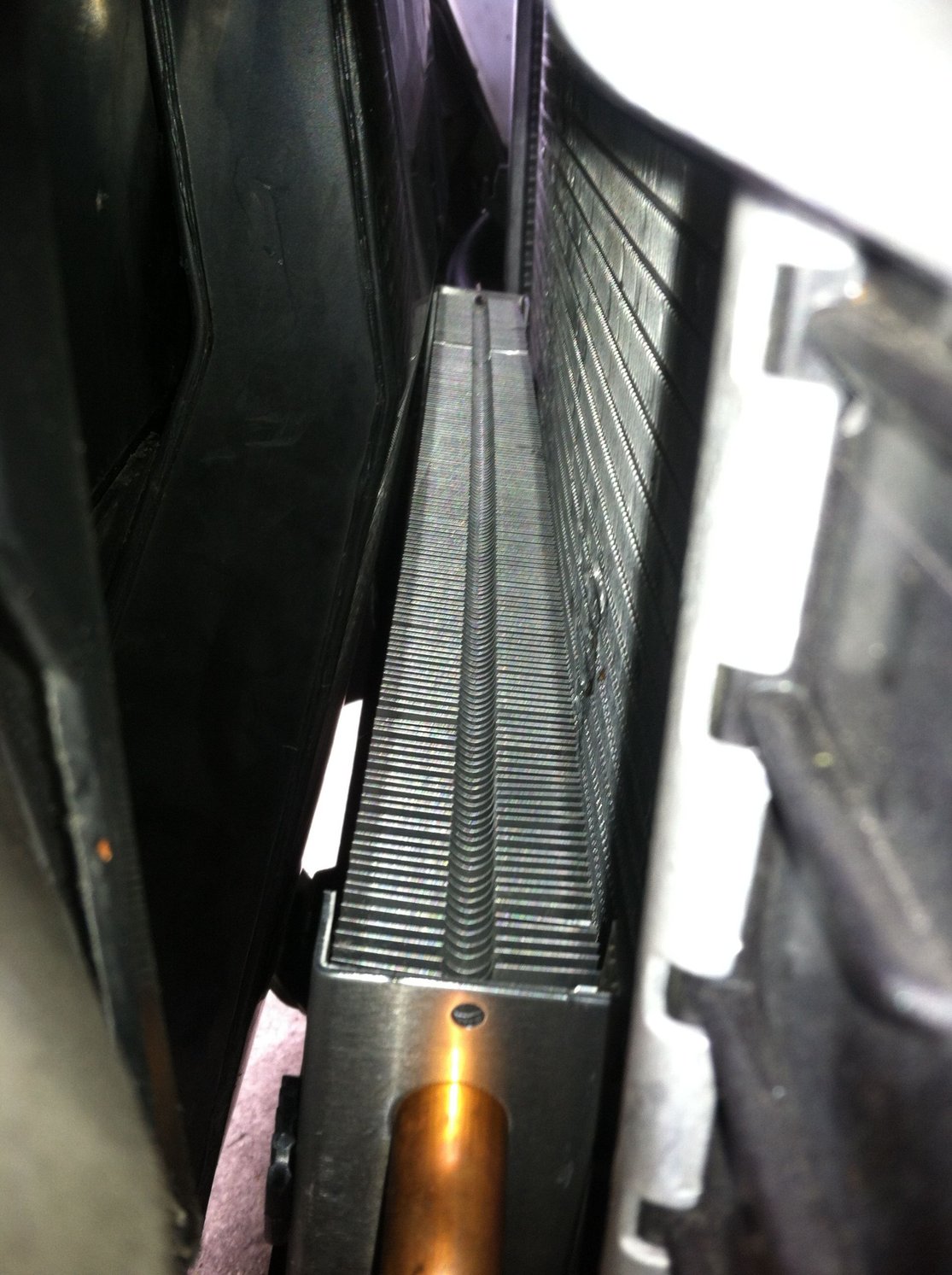

Megamouth with lt1 rad. Tabs trimmed.

Dude, you have ZERO room unless the A/C goes.
And the ac went

It has about 1 finger of clearence btw hard to tell with pic
That one finger clearance disappears when I put the top support back on; you're just seeing it sag rearward without support.
