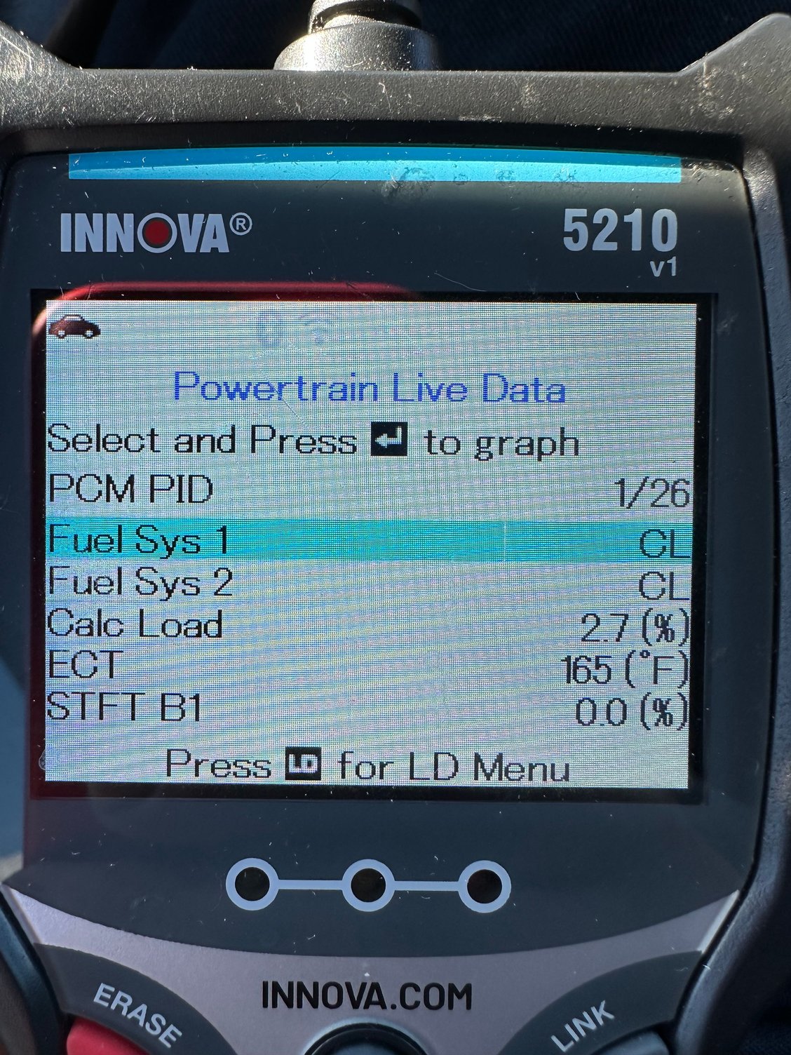

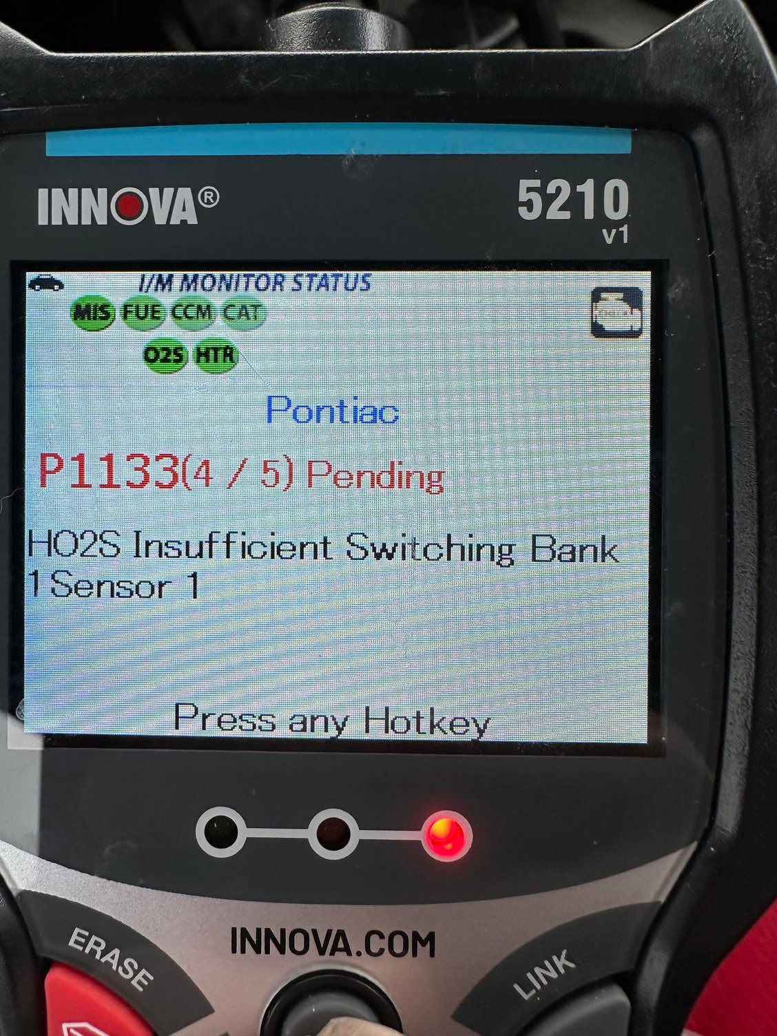

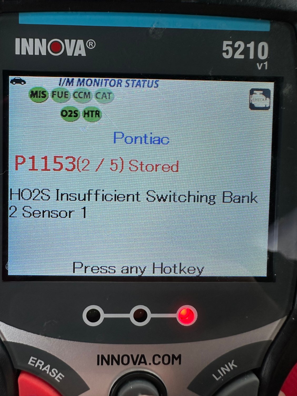

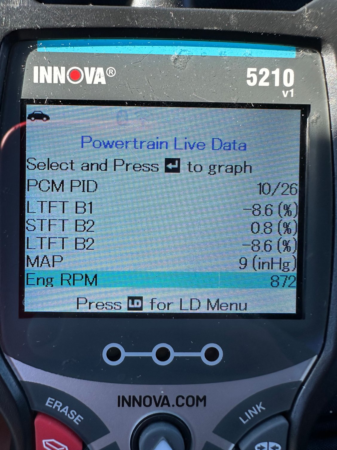

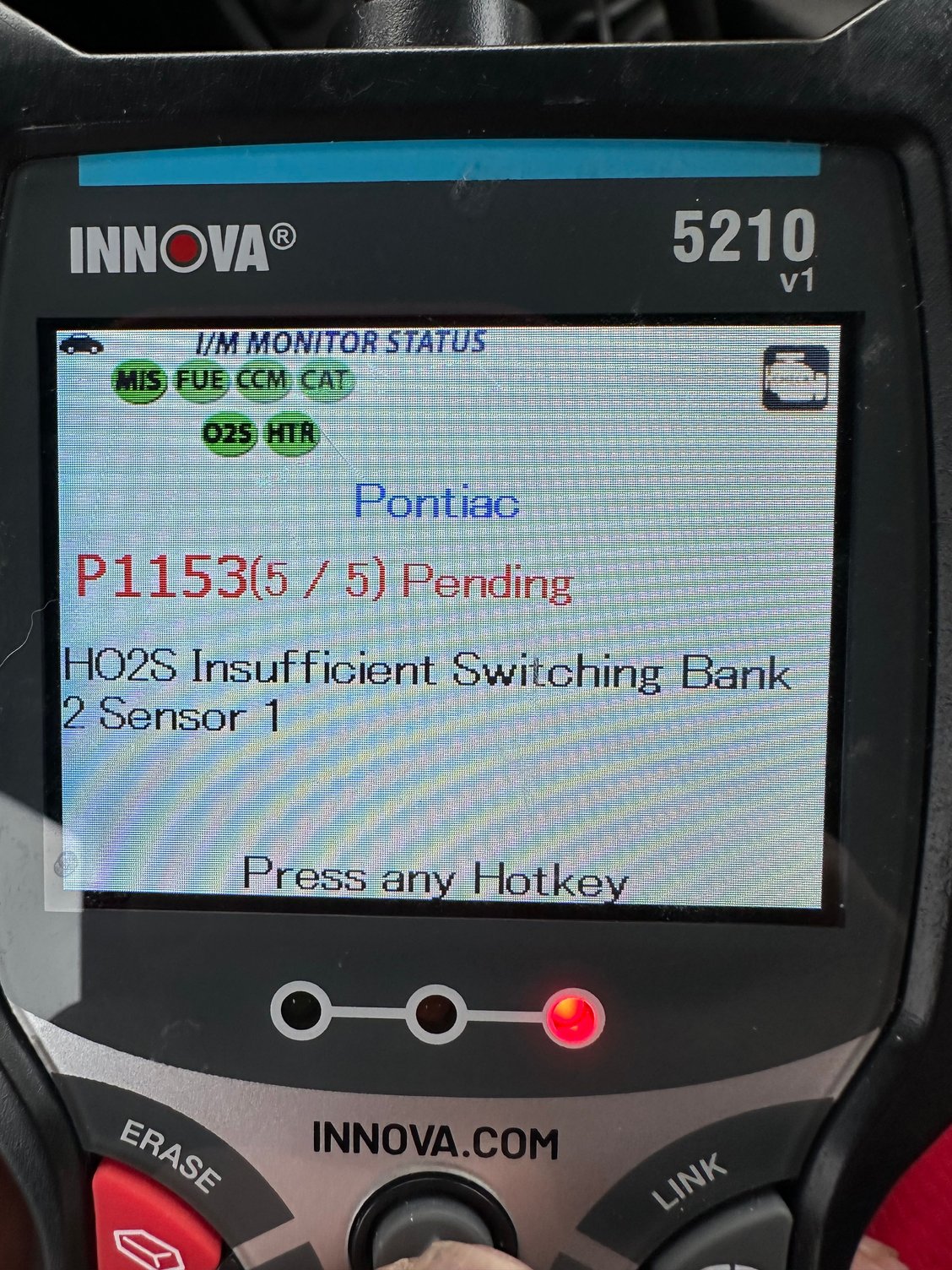

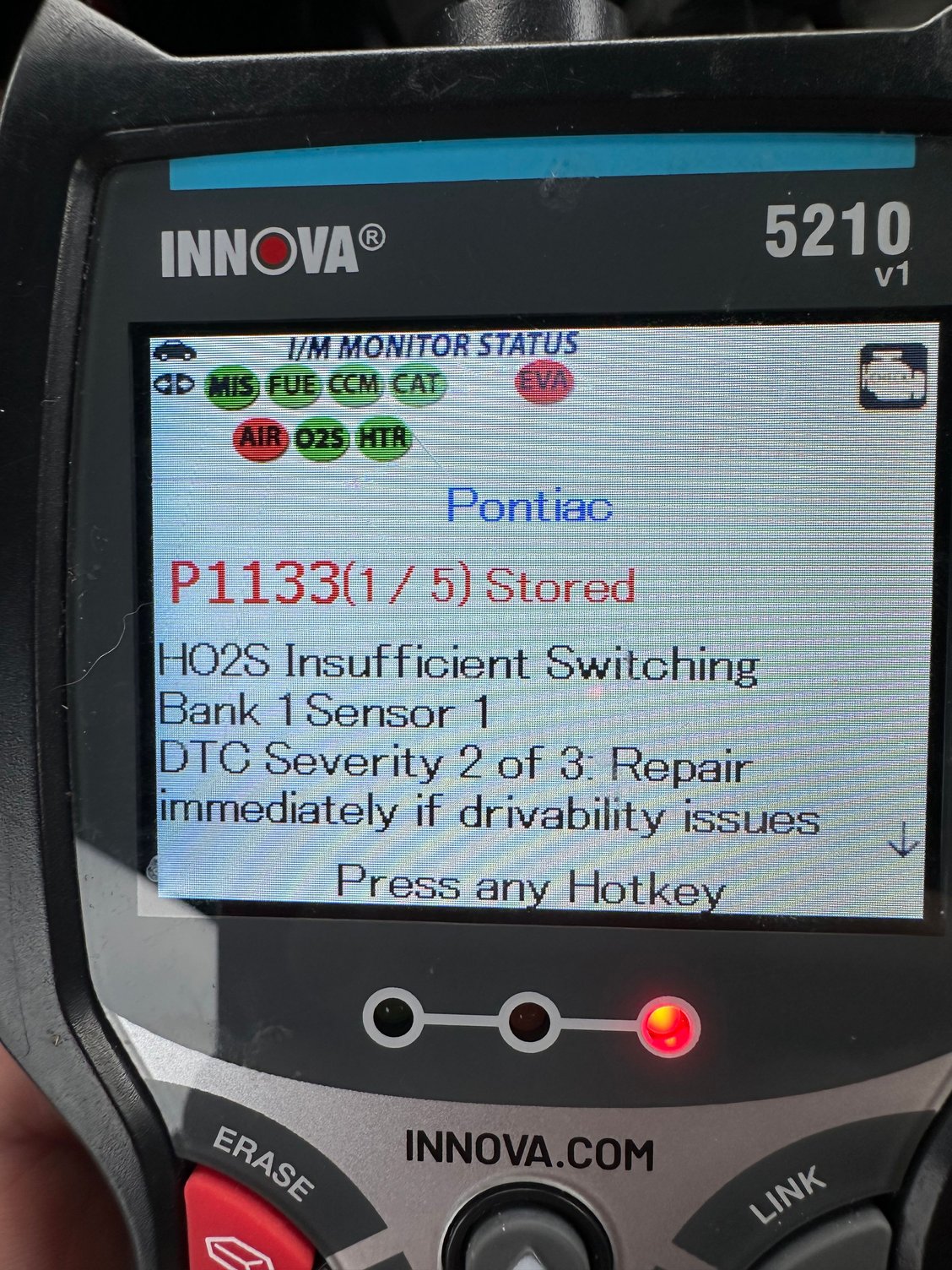

So I replaced the front two O2s with the denso sensors. Since I couldn’t get the rears out, and I figured they weren’t even reading because of the tune, I just left the old ones in. Reset the check engine light, and took it for a drive.
It was missing pretty bad with the old plug wire that was burned through, that seems to be all fixed with the new wires. But even though I replaced both front O2s, and reset the CEL, it still came back on after about 50 miles. P1133 and P1153. Looks like that means it’s running lean. Any ideas?

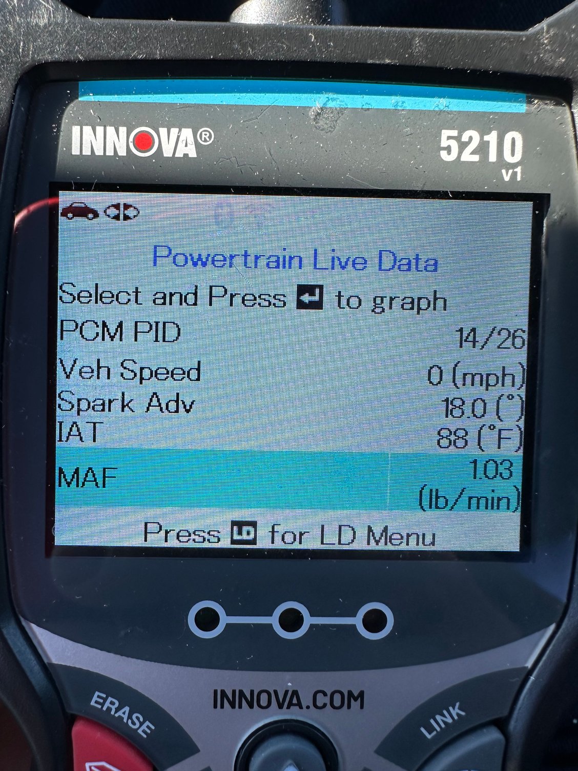

It would be interesting to know your values for Long and Short Term Fuel Trims for each side of your engine. Have you checked for an intake manifold vacuum leak that lets in extra, unmetered air that causes your fuel mixture to shift lean? Your MAF sensor could also be dirty.
Can you attach a log of your OBD2 parameter data with the engine running in closed loop, please?

I have not checked for a leak, but I did clean the MAF about 2k miles ago.

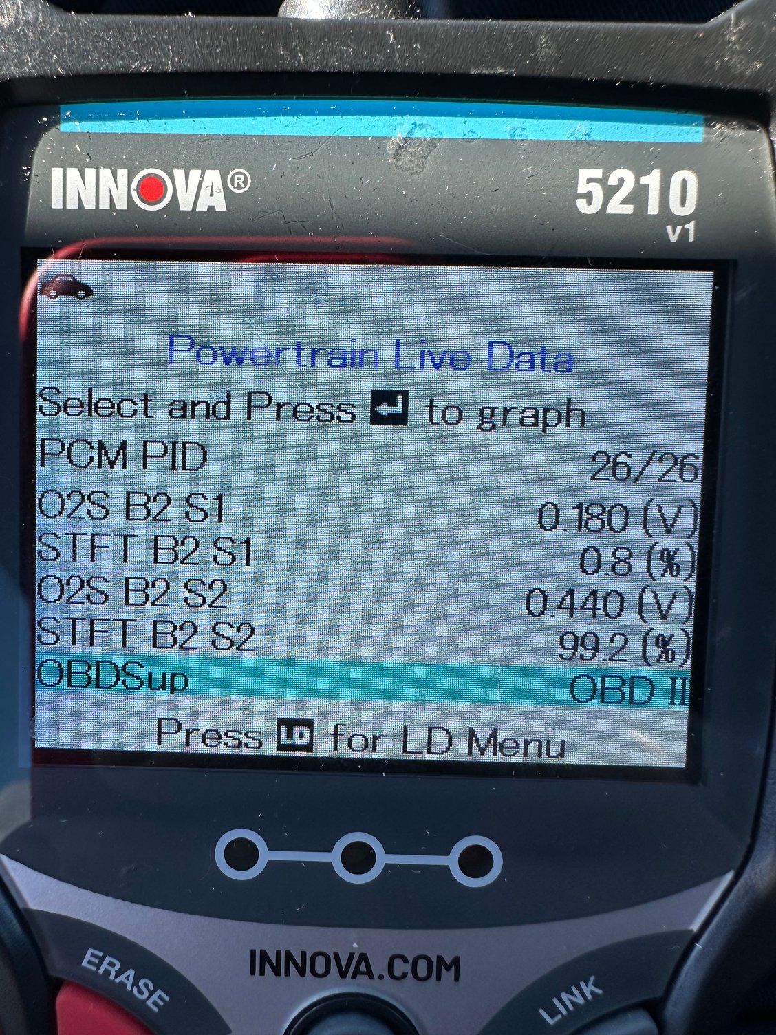

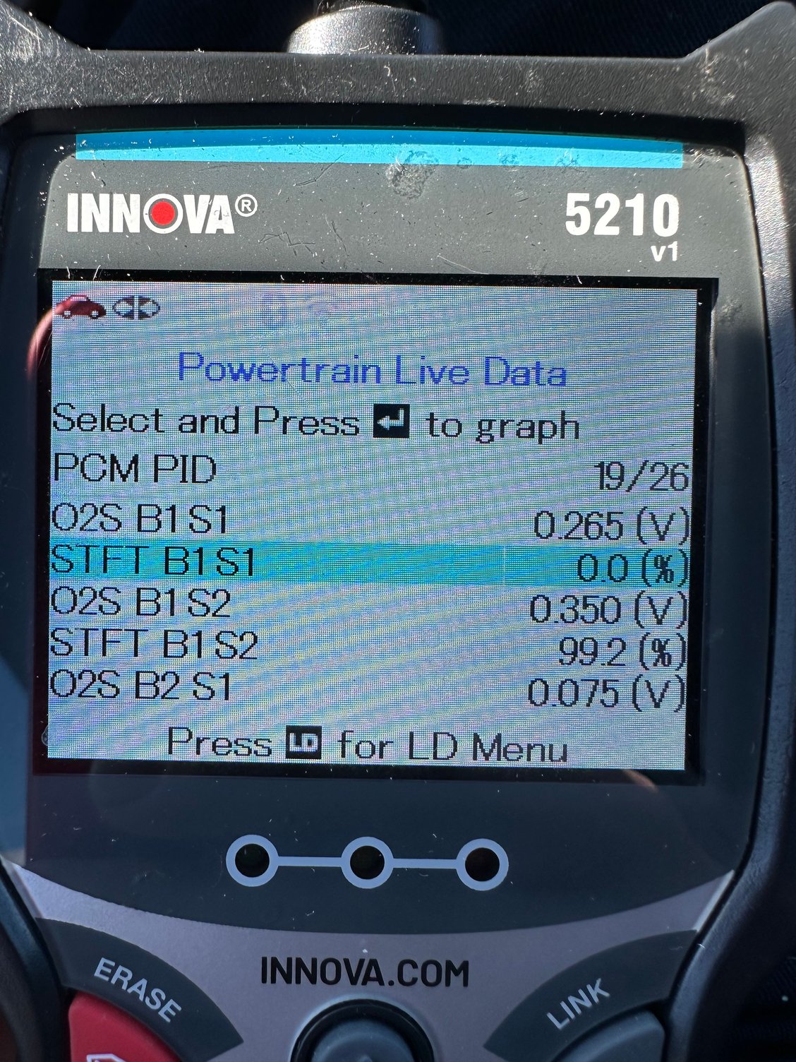

That scanner has the ability to graph sensors, so you need to graph both B1S1 and B2S1 and see what the pattern is. Watching the numbers jump around won't help you any. Go into live data (LD) and scroll down until you have highlighted O2S B1S1 ( and then O2S B2S1 ) and click the arrow to graph. My guess is that your sensor cross counts aren't sufficient and that your voltages are going to hover around the higher ranges, indicating a rich condition. Nothing is wrong with the sensors, most likely, it's probably a fuel system issue. You should put a fuel pressure gauge on your fuel rail and monitor fuel pressure both running and after shut off. If your fuel pressure drops quickly after shut off, you may have a leaking fuel injector.
I drive up to Alpena fairly often, and my route takes me close to Houghton Lake. If you can't get this figured out, I may be able to help out. The weather is about to turn, though - you store your car during the winter? I won't be up again until around Thanksgiving.
