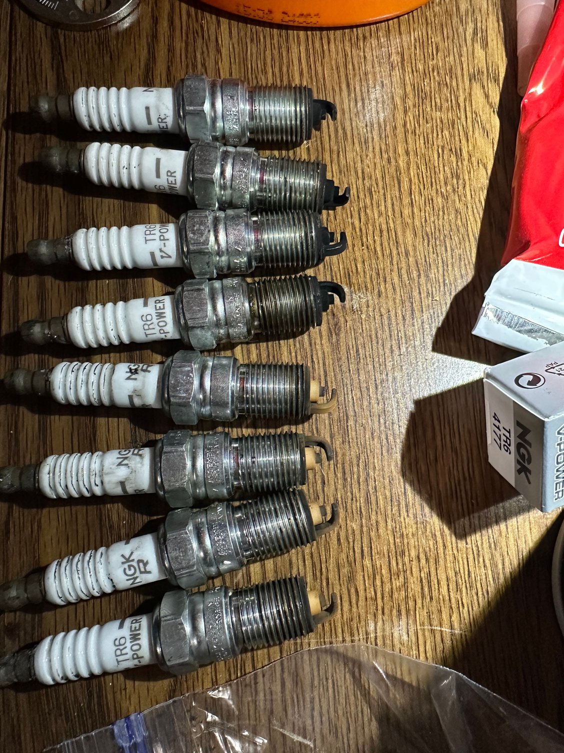

Pulled plug 1, and it was all carboned up. Went to the auto store and got all new plugs. Now, I changed all my plugs this spring, less than 10k miles ago. 1.3.5.7 were all full of carbon. Then I got to the passenger side and 2.4.6.8 are all orange? I have no idea what’s going on, especially since they are uniform on each side.

Oh, a pic might help lol.

If you have an infrared temp gun you may be able to check the header tubes after a cold start and see which cylinder has the initial misfire. Unfortunately, as I said before, once the computer starts to try to compensate for what it thinks is a lean condition, it will dump more and more fuel into that whole bank of cylinders. By then you may have the whole bank misfiring, so better to check on cold start before the closed loop fuel trims become active. If you can determine the original misfiring cylinder, then it will just be the usual process of diagnosing the cause.

Do some research to check me, but those TR6 plugs are probably to “cold” for a bolt-on car (they are better suited for a nitrous or forced induction car) and will be prone to fouling out. How old are your pre-cat 02 sensors? If they are old, I’d try swapping them out. I’d also look for an exhaust leak on the bank that had the black plugs.

I changed the pre cat O2s like 3-4 months ago. I got all 4, but the rears I couldn’t get out. I tried PB blaster, heat, hammer, O2 wrench, pipe wrench, they wouldn’t even budge. So I still have two more new ones in the box. It was throwing a bunch of O2 codes as well, I could try swapping the front ones out again, but it just seems weird they would go bad in a couple months.
As for the TR6, it is a heat range colder, but from what I’ve read it should work and it’s always had that in it. Since I don’t have access to the tune I don’t want to start swapping parts out when it’s set up for that.

As the plug number on NGK plugs goes down, the heat range becomes hotter, not colder.
NGK plug heat range chart - Search Images

I’m not sure the point you’re trying to make lol. While you are correct, stock is TR5 and I have TR6. So, confirmed, I guess lol.

Why are you running a colder plug for a bolt on LS1?? The stock heat range plug will be fine for what you got

I would agree. I'd suggest a TR55 for proper heat range and closer to stock gapping.

As previously stated, I have TR6 plugs because that’s what I took out when I changed them, so I put the same back in. The tune is not stock, this car has run an 11.8, I’m sure the timing has been changed and who knows what else. I didn’t want to start swapping out random parts when everything works fine. The cars pulls hard to 6700, I have no issue with the plugs. I’ve changed plugs twice on this recently, and I didn’t have any fouling issues til this O2 situation.

but as others have said i would go to a TR55 plug as well, yes a tr6 can work and under WOT you wouldnt notice a difference but for stock compression that heat range is unnecessary and will cruise around nicer with tr55's in it
