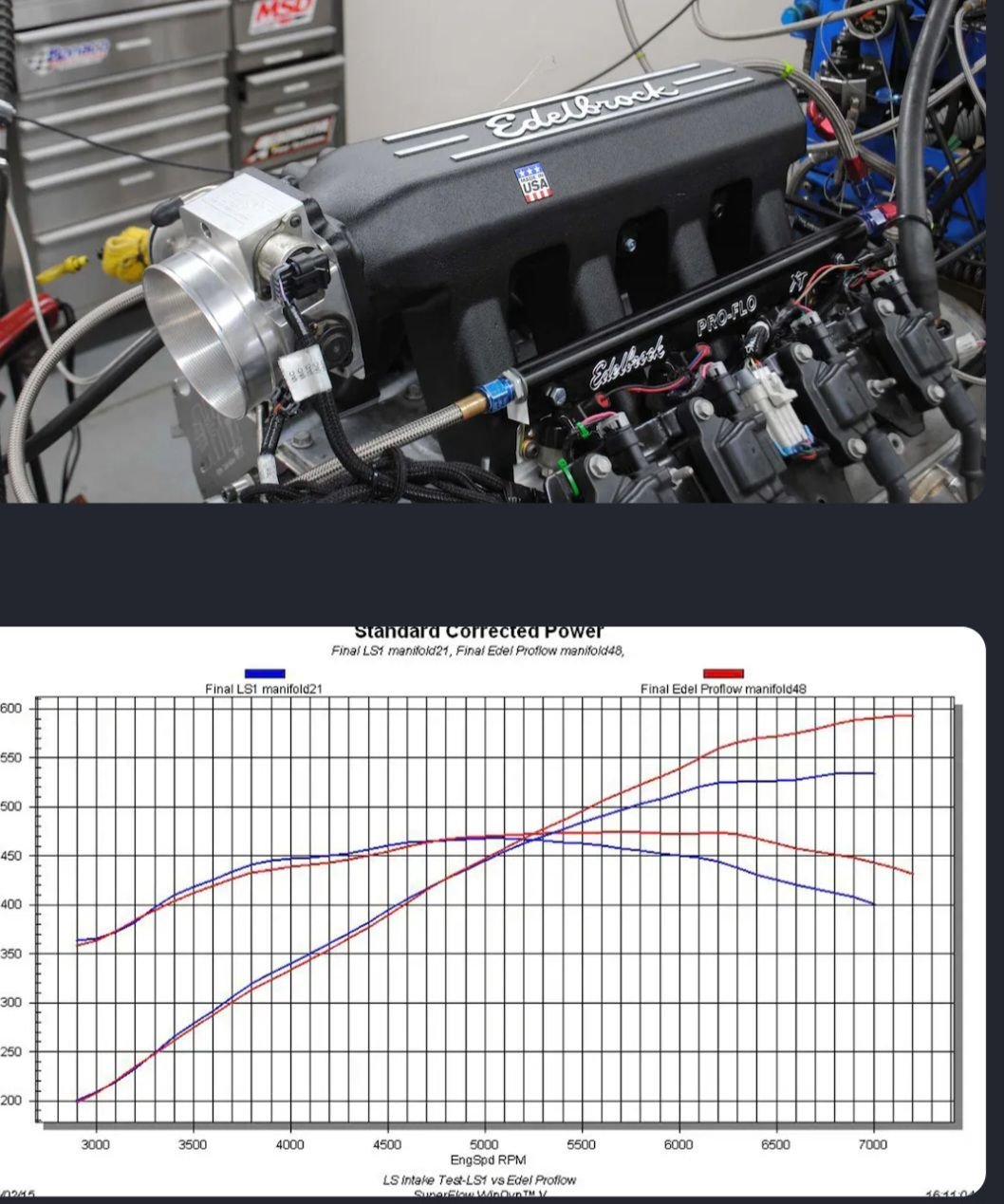

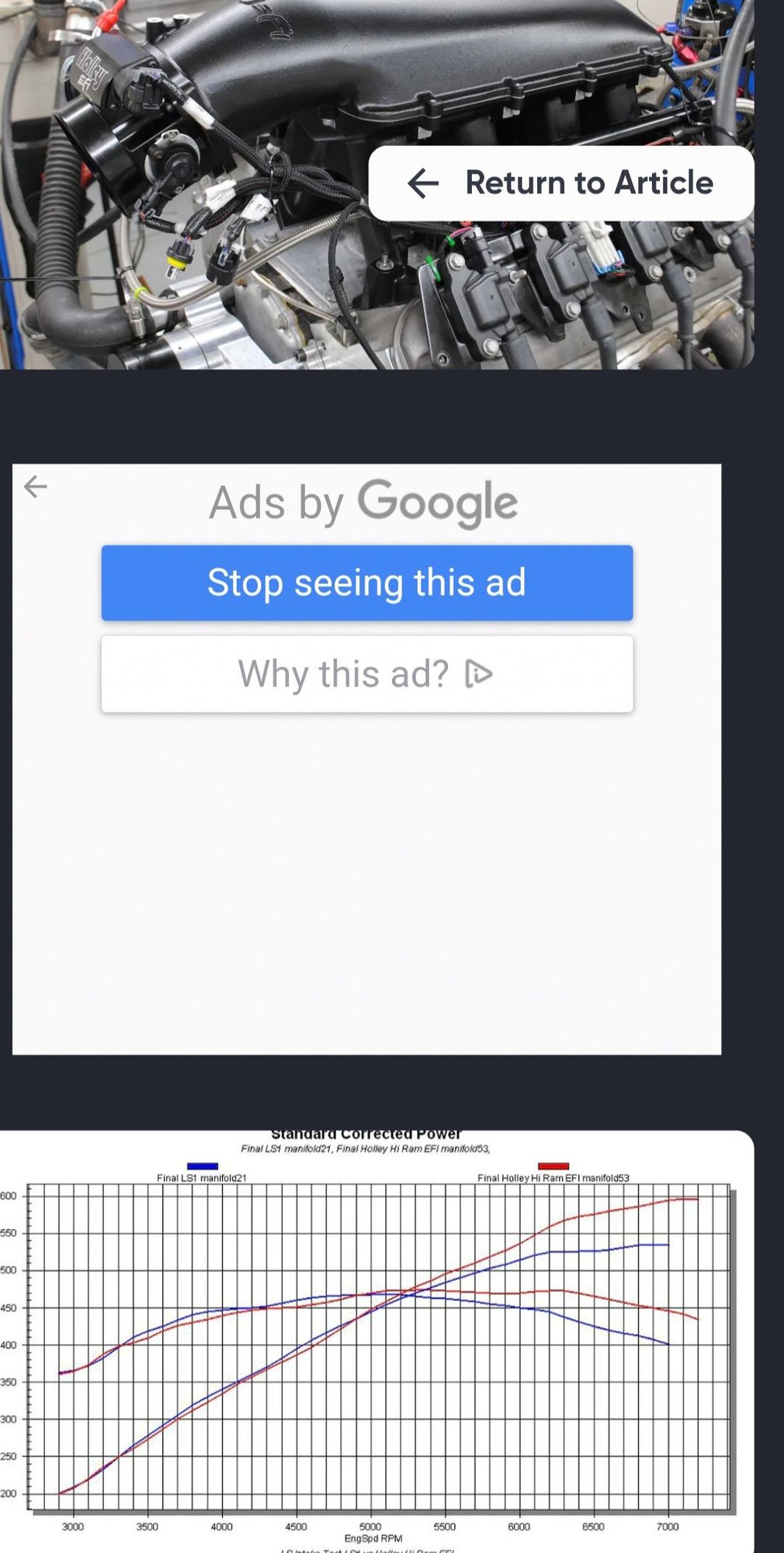

Jack Roberts (Squirrel tuned) ran an Edelbrock Pro Flo intake manifold when he made his stock 4.8 record 1/4 mike passes. It looks like the Btr Trinity makes a touch more above 6500 rpm versus the Edelbrock. Holley Hi-ram would be way too tall for my hood/application, but it looks like the Edelbrock is lower than the Hi-ram (and makes nearly identical power according to a Holdener video).
So on paper, it will be a choice between the Btr Trinity and Edelbrock Pro Flo. Assuming a TBSS intake manifold will heavily nose over by 7000 rpm versus the Trinity/Edelbrock, but have yet to see a direct dyno comparison.

Dyno graphs comparing intake manifolds are a bit unreliable when it comes to finding out where power falls off. A lot of that is based on the setup itself. A turbo setup is more likely to hold power better up top, and a different camshaft could have completely different results yet again.
My stock gen 3 truck intake manifold was still climbing in power above 7000 RPM in my old 4.8, but I very carefully chose my cam/turbo combo as well as header primary diameter/length/pairing etc to make sure everything worked right.
