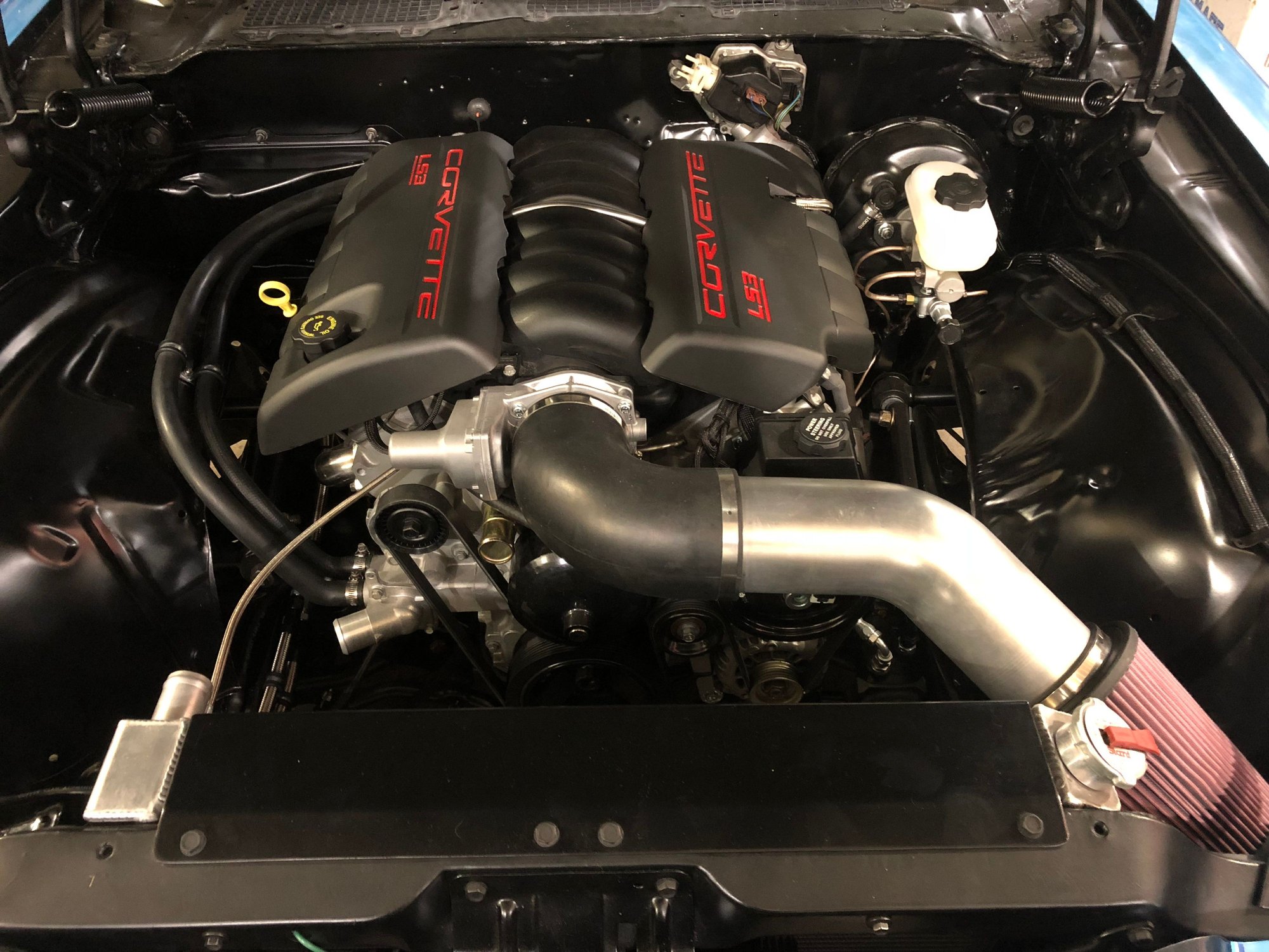

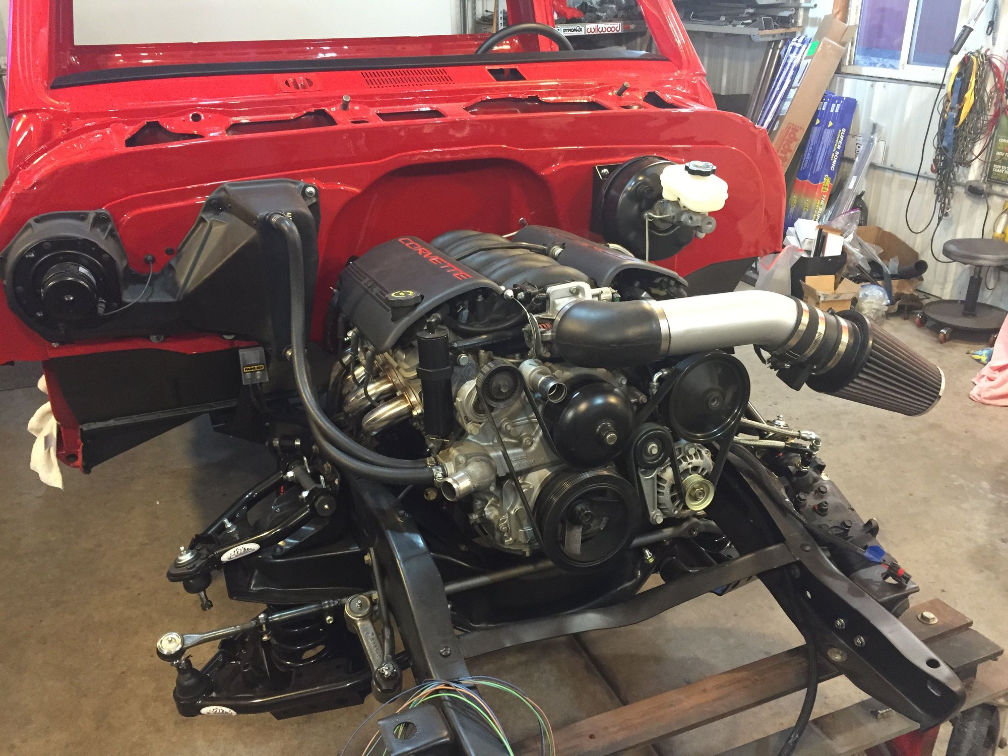

Pics of a couple LS swap air filters I've done. The truck has a 2002 LS6 swap. The Camaro has a 2012 6.2. Just hide the mass air sensor on the bottom of the intake tube.
But the OP has a stock airbox that is a REAL cold air intake, so what you have pictured would actually hurt performance by letting hot air in, and throw the tune off slightly by changing the location of the MAF. Paying to hurt performance and cause tune problems seems counterproductive.
