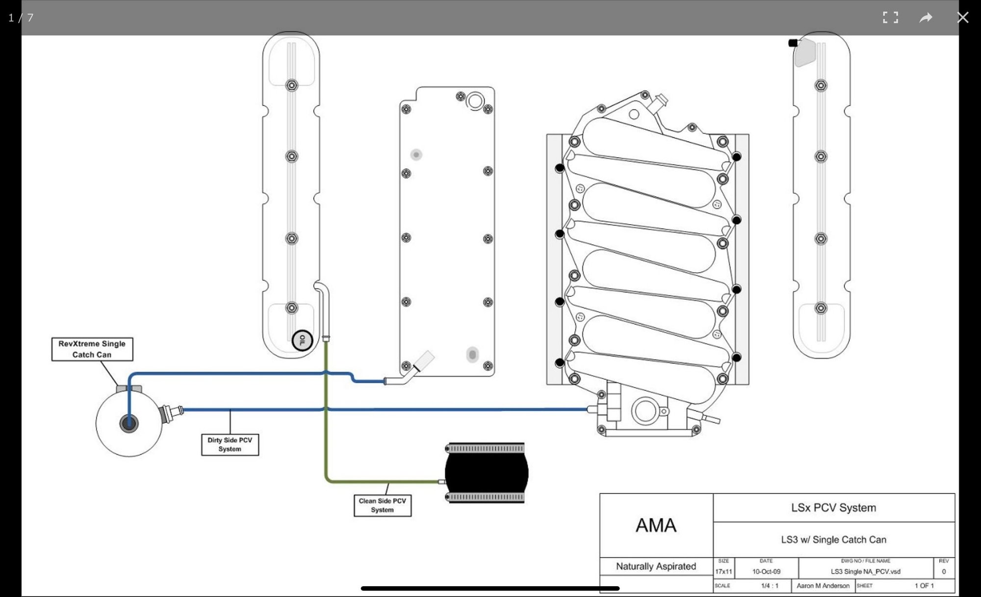

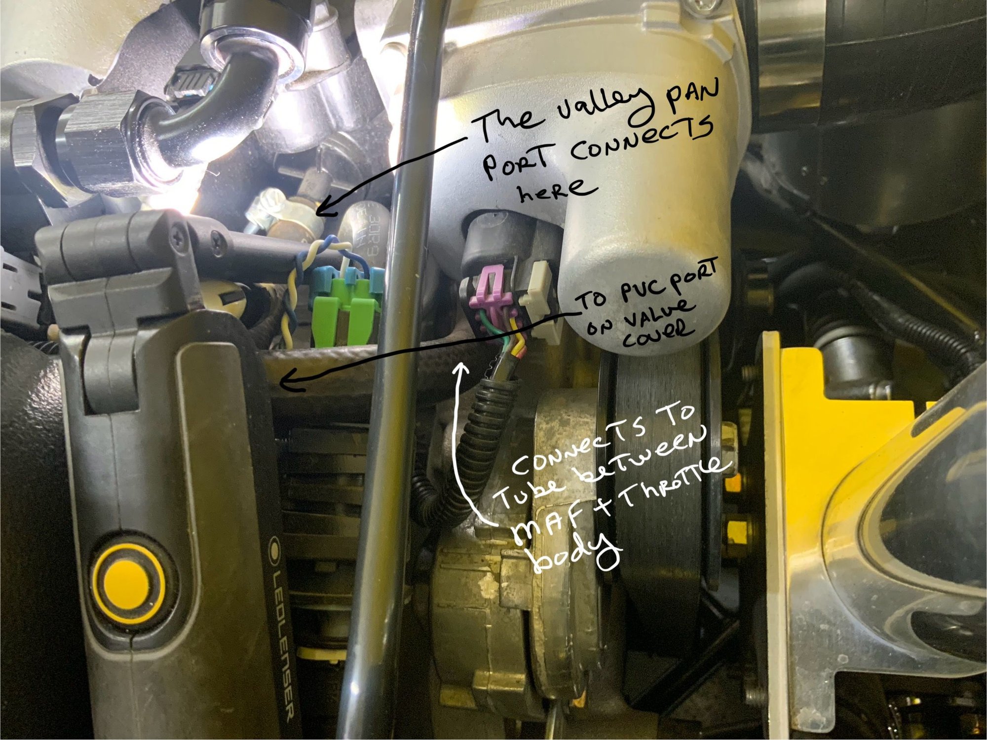

Stock LS3 430HP one, the only change was I added BBK shorty headers and a catch can.
The fresh air port from the pass side valve cover is connected between the MAF and throttle body.
The valley pan port is connected to a catch can and then to intake just past the throttle body.
The left rear drivers side valve cover port is blocked off with a plug.
This is how I have it connected.

Nothing wrong with that PCV setup. Straight from the factory that way.
