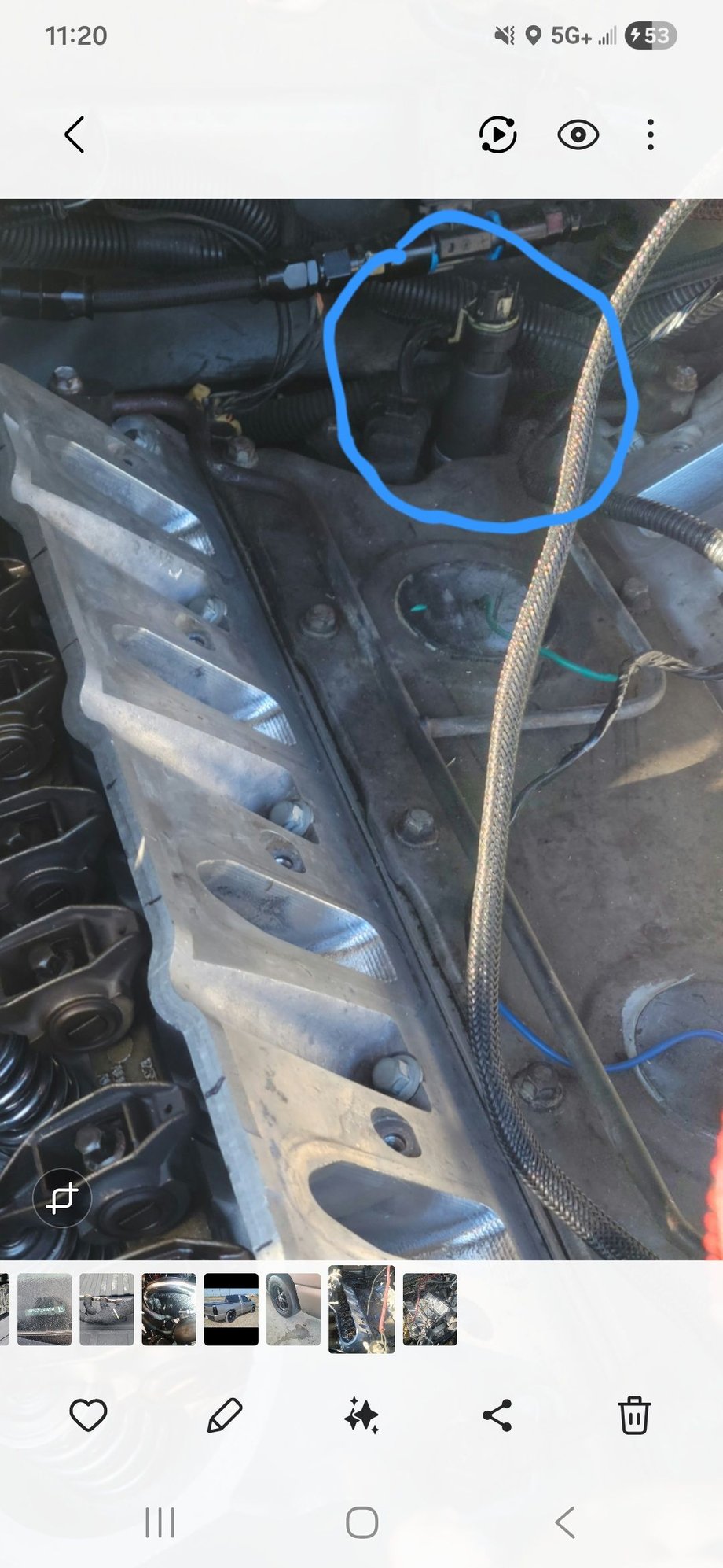

on the drivers side rear behind the intake manifold where the factory oil pressure sensor goes that is where its installed. I unscrewed the factory oil pressure sensor and screwed in that tee and then screwed the factory sensor into the top of it so its still in factory location so nothing had to be changed there and then put the 2nd sensor for holley on the npt fitting in the side of it.

I found the old picture of my old motor but it shows the sensor in the factory location, unscrew that and put the tee then screw new sensor into npt on side and run wires.
I found the old picture of my old motor but it shows the sensor in the factory location, unscrew that and put the tee then screw new sensor into npt on side and run wires. Factory sensor will go into the top of it.

the tee allows you to screw in the stock sensor and an aftermarket so you can have both so you can keep your factory gauge and still have an aftermarket as well.
unscrew the factory one, screw in the tee, screw factory gauge into the top, aftermarket screws into the side.
