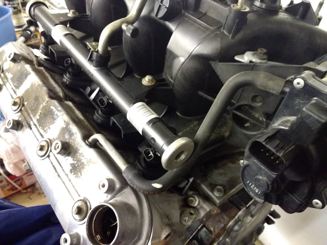

I believe all you would need is just the LS6 valley cover. It's the one with the nipple that sticks out on the passenger side under the throttle body.
From the factory, there's a "U" shaped hose that goes from the valley cover to the side of the intake.

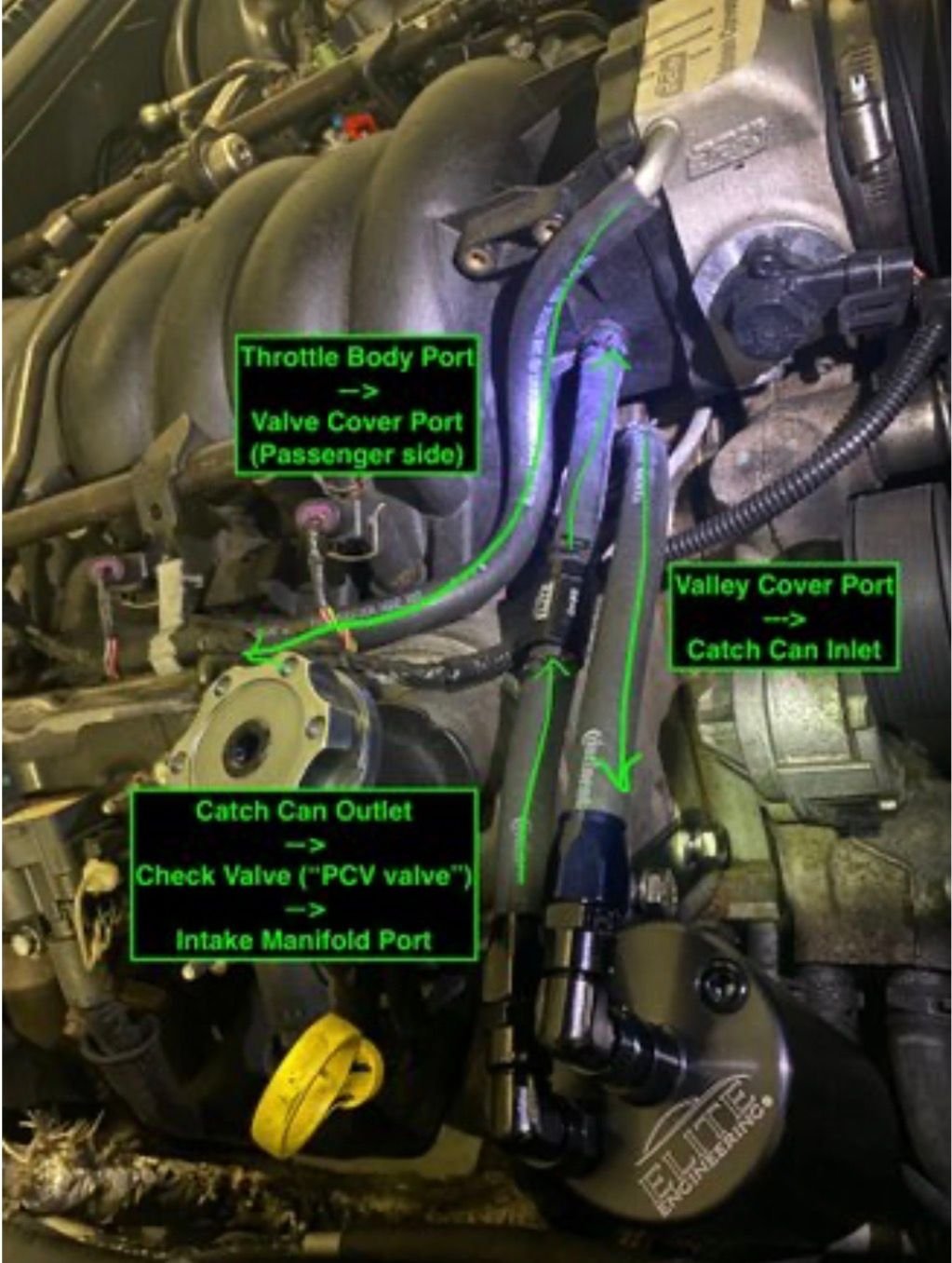

My PCV valve is in-line between the nipple and the intake. After installing the LS6 valley cover, would this be the proper routing? I think the Elite would suit my needs as I’m not planning to make more than 400-450hp.

Looks workable to me.
That place on the TB that the make-up air hose is hooked to, should go to a port in the front surface of the TB, ahead of the throttles butt behind the MAF. Lots of vehicles have that arrangement from the factory. Trucks bring it all the way through the TB to the plastic intake and the nipple going to the VC is back there. So if your TB has a passage like that, it'll work for yours too.

This is what my setup looks like currently. So after the LS6 valley cover, my valve cover/TB connection would remain the same. The PCV orifice would be connected at the catch cans inlet and the outlet would connect back to my intake manifold. The only thing I would need to do is plug off the inlets on the rear of both left and right valve covers. Correct?
Also would you recommend one catch can over the other? Or even a different catch can? I see MM all over the threads and I have an Elite on the (driver)
dirty side of my Silverado, which I’ve never had any issue with.

I do not see the PCV port on the valley cover so I suspect you have an LS1 valley cover. Still can run the Elite MS catch can just connect that line to the can and from there back to the intake manifold. Leave the front valve cover hose connected as is.
It currently has an LS1 valley cover. I’m replacing it with the LS6 valley. On my previous 00’ SLP SS, I swapped the cam and a number of other components within the drivetrain but never installed a clean side can or even considered swapping valley covers. So as many threads as there are, I want to be sure that I’m correct with the plan for installation and addition of the catch can. The LS6 block and LS6 intake manifold being stock with 241 heads is different from what I’m used to.
