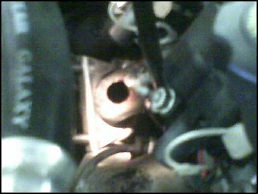

I was on a leisure trip from Hephzibah, Georgia to Kansas City, Missouri this past week. Last Thursday I left at 6 am to head back on my 1000 mile trip. It was 20 degrees outside and still dark when I left. I was on 291 for about 15 minutes and the car (01 modded z28/ss) became very loud like there was no exhaust on it. I pulled over at the nearest gas station and popped the hood to see blue flames coming out of the third cylinder on the passenger side. There was a 1 inch hole in the top of my headers 3 inches from the exhaust port. Oh snap!!!

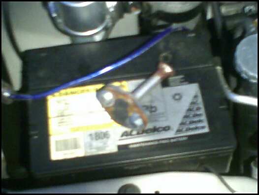

When I bought my headers I grabbed the longtubes with egr just in case I went to a state with vehicle inspections. The second egr line on the passenger side wasn't being used and had a block off plate on it. The weld that held that line to the headers failed and it just fell off.
So I drove the car about ten miles slowly to an exhaust shop and they said they couldn't do anything unless I got the parts off the car. they couldn't get a welder in there to fix it. I had them cut me a small peice of pipe so I could patch it up. I then went to O'reilly on 40 highway to get manifold wrapping/patching tape and an exhaust clamp. After this I went to my Mother's house because it was closest. I didn't have any tools to work on the car and no garage to use in the 20 degree weather. Fortunately a friend of my mother's that lived two houses down rebuilds cars in a garage in his back yard. I went down and told him who I was and what the problem was. He had an appointment to go to, but said he would help when he got back. This is a retired guy with a good heart for the military. He cam back three hours later and let me use his tools and garage. I got everything patched up without removing the header and was on the road at 3:30 pm the same day. I had no problems driving home, but the part looks like crap. I will have the patch welded on this weekend when I do my head/cam/exhaust swap.
Thought I would share this problem. I have pictures on my cell phone and will try to get them up here for you all to see soon.

Sorry to hear about that. Can block off plates lead to failure?
I was thinking about going to block off plates but when I think
about it probably would increase pressure on welds.
John

I talked to a welding expert about it and he said it looked like there was a cold weld. I bought the headers over a year ago from a company on ebay for $299. I will just get them patched up.

Im starting to think with block off plates that the exhaust pushes on the tube because it has nowhere to go and over time lifts the weld. Still doesnt seem like it would be strong enough to break weld though.

Very common weak point on our headers. Seen headers from 3-4 different manufactures do that. It's just not a strong location to have that type of fitting welded in.
Should be a easy fix.

I have a hard time understanding why it would break
if it was welded correctly. Thin wall tubing should be
TIG welded, though-less chance of undercut from a
not-too-experienced welder.
The fact that an AIR or EGR flange is blocked off
would provide no more stress than a properly
functioning system,IMO.
