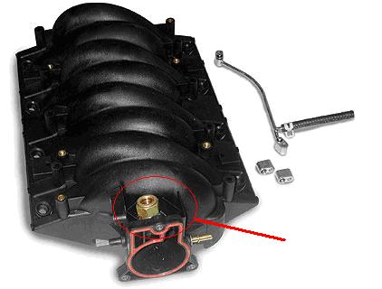

01s and 02s did not have egr and came factory equipped with an ls6 intake. I'm pretty sure whoever did the work would just replace the longblock. The accessories and intake were probably just swapped over. I don't think it is legal for them to remove any emissions equipment that your 98 came with.
Pre 01 Corvettes also came with the ls1 intake, but not the egr equipment. You can tell the difference between the ls1 and ls6 intakes by looking at the bottom of the intake. LS6 intakes have a flat bottom and no egr. LS1 intakes may or may not have egr and have a hump on the bottom.

Here are pics of an ls1 intake egr setup and an ls6 modified to use egr. If you have the modified ls6 intake, you have your old exhaust manifolds.
