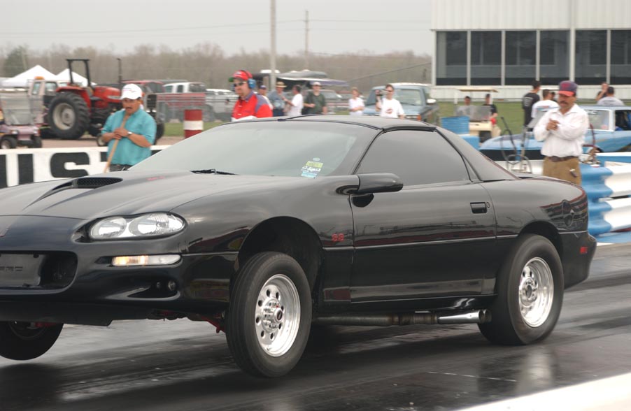

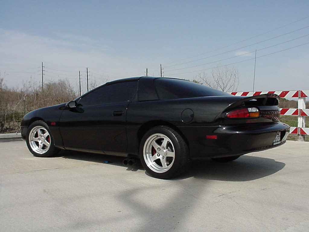

Default Re: ****True Dual Exhaust Roll Call!!!!****
</font><blockquote><font size="1" face="Verdana, Helvetica, sans-serif">quote:</font><hr /><font size="2" face="Verdana, Helvetica, sans-serif">Originally posted by 2000LS1:
<strong>Does anyone else think this would look cool? Side exiting exhaust in front of the rear wheels through the Sport Appearance Package (RS) ground effects.</strong></font><hr /></blockquote><font size="2" face="Verdana, Helvetica, sans-serif">Here are two pics of Onyx (Justin) car. Granted, he doesn't have the RS package, but it's close to what you want to do.
pic 1
pic 2
