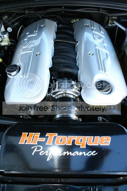

hey guys does anyone make engine covers to fit on a fsat manifold like the gto style covers i have a photo of my old engine bay but i cant use the engine covers now cause the runners are different shape.
here is old setup new one has fast manifold on

just grind them down. thats what i did.

I ground my GTO covers down a bit with a dremel. Just set the cover on the intake and use a pencil to mark the areas that need trimmed. Took me about 30 mins to get them to fit right and they look as good as new.

SWEET AS MATE got a phot so i can see what the result looks like please.thanks

Sorry for the delay here are pics of mine:
Attached Thumbnails twin engine covers on fast manifold-img_1942-small-.jpg   twin engine covers on fast manifold-img_1943-small-.jpg   twin engine covers on fast manifold-img_1947-small-.jpg   twin engine covers on fast manifold-img_1945-small-.jpg   twin engine covers on fast manifold-img_1950-small-.jpg

Nice work on the FRC's. Most would never notice the change if you had not pointed it out.
