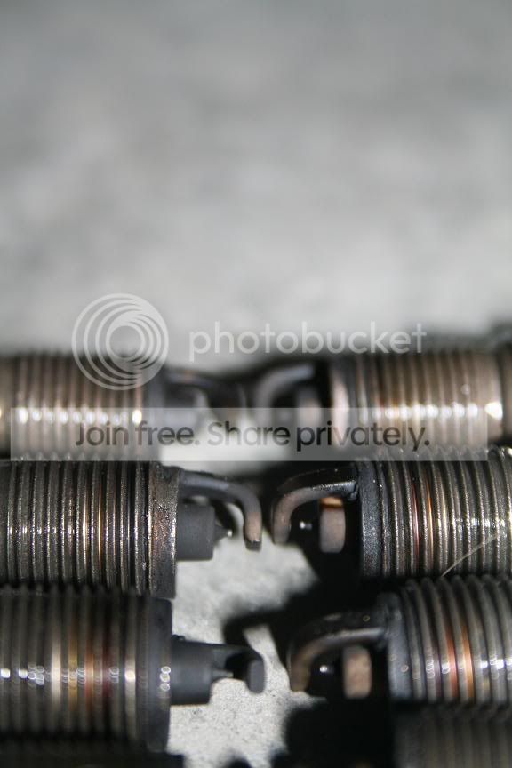

Pulled the spark plugs today, and I think they look fine???:
In those pics, cylinders go:
Passenger's front cylinder..........passenger rear cylinder
Driver's front...............driver rear
I'm new to motor diagnostics, so...help?

I just pulled a set of plugs out of my engine that looked liek that and my engine was missing horribly because of them and i have no idea why. I installed new plugs no more misfiring.

Your plugs don't look fine, they are fouled.

Also I agree those plugs do not look so great.
