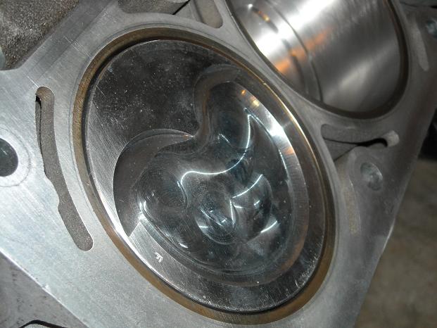

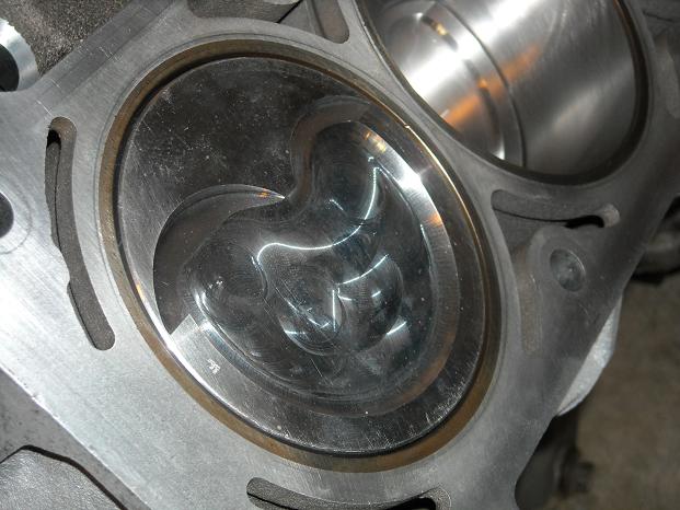

i don't really think that i have a 28cc dish. When i purchased the engine it was supposed to be 9:1
I had a local builder look at the pistons and he said there is no way that what I have a 28cc dish
What do you think?
Attached Thumbnails compression question-pistons.jpg   compression question-piston-1.jpg   compression question-piston2.jpg   compression question-piston3.jpg
