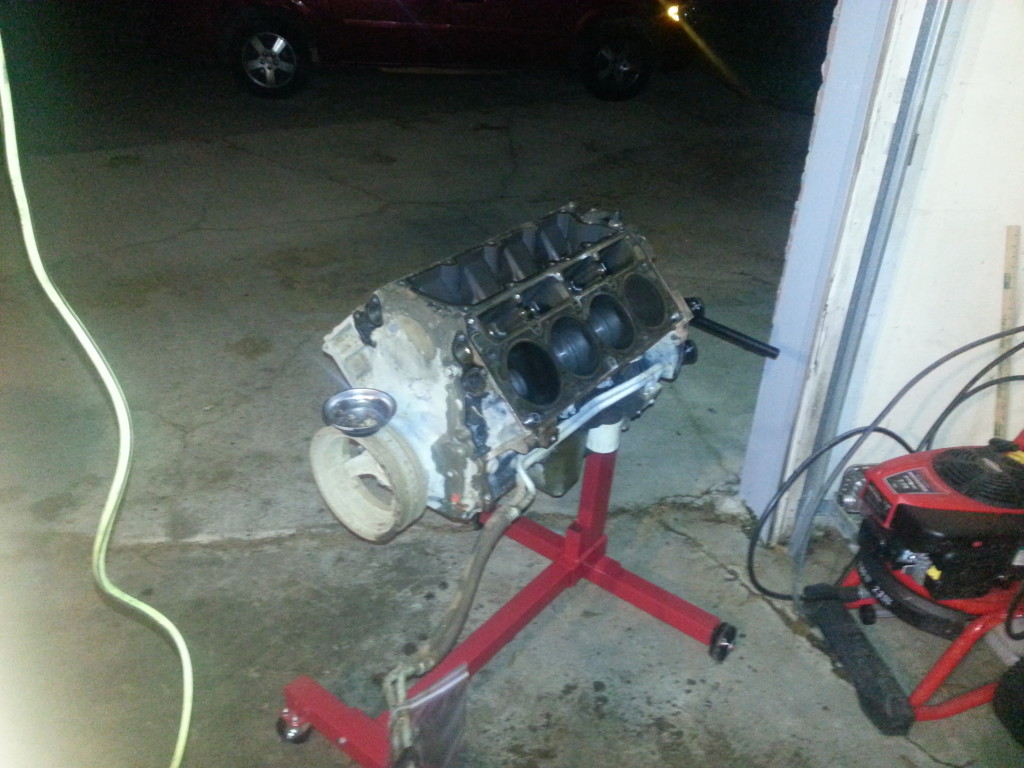

Thanks for the tips guys. 68cc chamber large bore version it is then. Spent some time tonight on the tear down and have it to a shortblock now.
