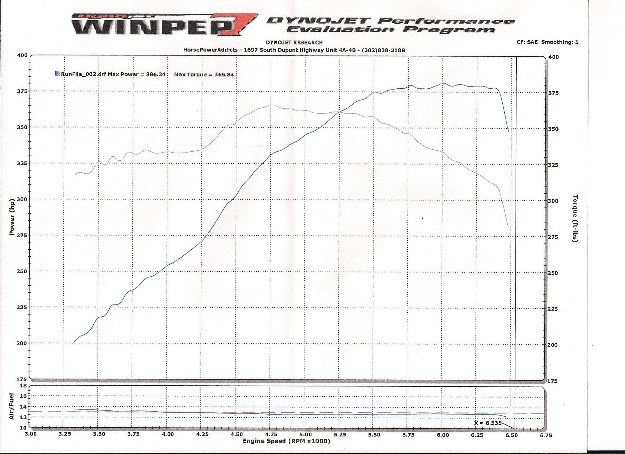

Assuming there are no mechanical issues, tune would be the obvious place to start for me.
Who tuned it? If not you, have you consulted them? If 386 didn't satisfy you I assume you would have at least given a funny look at the guy running the dyno? Even if the tune is spot on for the motor, you have the electronic transmission to tune as well.

Dyno numbers don't really matter but the 113 trap speed does seem a tad low. I'd be curious about the tune as well

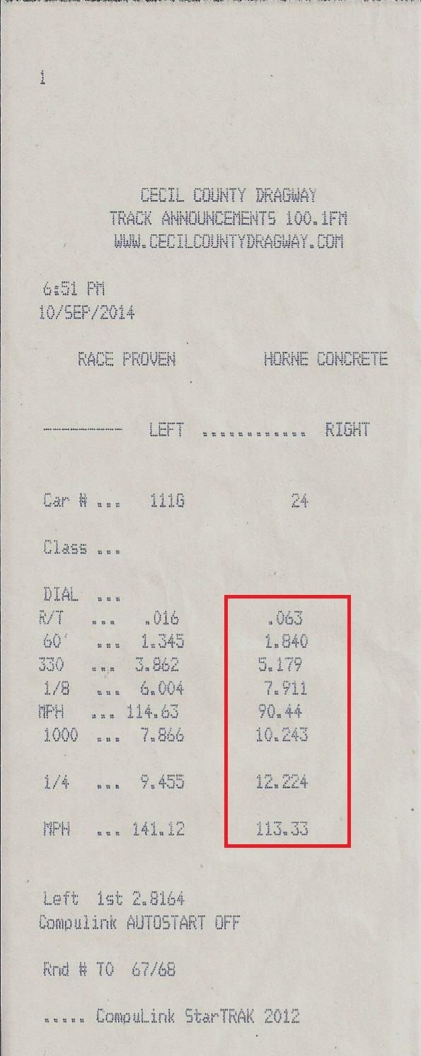

Post a pic of the dyno graph and the track timeslip. Your MPH is an 11.9 ET but lets get some pics first

My personal opinion is that you are losing a lot in your 60 foot.

I had a yank 3500 in my car and pulled a 1.76 on a street tire leaving at idle. Ran the same time as you in the 1/8th in a bolt on Trans Am @88 mph.

Also looks like the car really flattens out at around 5500.

Yeah. The 60 sucks. The 3.15 gears aren't doing us any favors. Looking to go to a set of 3.90s.

RPMs makes HP..so why flat between 5500-6500? I am sure your tuner is reputable..and because of that they should be able to answer this for you. If it were a stick car, I would wonder if the clutch was slipping. Maybe you could apply that in an automatic sense.
Throwing stuff at the wall:
Valve float? Running out of air(intake or TB)? Spark? Cam accidentally advanced bringing everything down a bit RPM-wise?
You pick up 75 HP between 4500-5500. I would expect you to make similar gains in the next 1000RPM. That would put you where you thought you would be. Torque drops off quickly at the end and for that reason with no other changes I'd like to see how the car performs with about a 5900-6000RPM shift point.
Still, I'd call the tuner and have them explain the dyno sheet to you. Something is funky past 5500.

Looks like it was dyno'd with the converter locked?
I'd ditch the roller rockers and put stock rockers back on there. I'd also verify the pushrod length. They seem a tad short with the roller rockers unless you've milled a ton off the heads.
That 3200 stall isn't helping you. Similar driving characteristics doesn't mean it's as efficient uptop or that it has the same shift extension as a larger converter. Have you logged the slip on the top end to see how much power it may be eating? I don't know if it's a 258mm converter or one of those 278mm "stock like" converters?
Also, a 3.15 doesn't really have much to do with track times with a converter. Guys run 2.73s and 4500 stalls and do well at the track. The issue is the tall gear makes the car lug around on the street with a big stall, but a 3200 isn't a big stall.
Also, the headers/exhaust might be choking you out a bit. What's the primary size of the OBX headers? Collector size?

I think with that dyno your shift point should be 5800. youre losing all your torque at 6300

Headers are 1 3/4", but it still has dual cats. Exhaust is twin 2.5".
The converter is a 258MM billet front. We're not slipping at high RPMS. The tuner said it's one of the most efficient converters he's ever seen.
7.4" pushrods were too long. Both the block and heads were cut. I used an adjustable pushrod to find the right lenth.
Cam is installed dot to dot.

So the tuner liked the converter, but did he/she not comment on the flatlining up top? AFR looks ok but without knowing anything about the tune I am afraid we may be spinning our wheels...and apparently not fast enough.
I love throwing **** at the wall but to me, asking the tuner is your obvious next step.

Who ported the heads? Could be a poor port job?
Looks like possible valve float up top to me...very rough graph up there for smoothing 5. I bet it runs better with stock rockers.
I agree that gears probably aren't going to help you much.

Lloyd Eliiot did the heads. It's still pulling hard at 6500 at the track.
