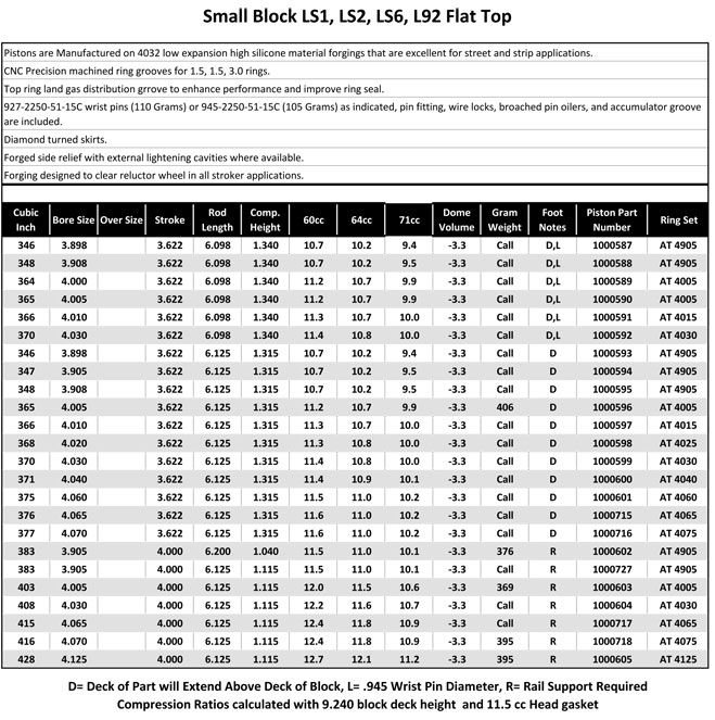

I was wondering if someone could take a look at the setup I plan I running for my ls1?
The block is a ls1 stock bore was just honed. I am taking the crankshaft to the machine shop later this week due to the engine spun a rod bearing on cylinder 6. So if all checks out I will be using the stock block with stock bore and stock crankshaft.
The rods are bad and one of the pistons has a hot spot on the top of it as if it started to melt.
I am thinking of going the route of new rods new pistons and 243's.

I got a piston rod chart off of ls1 tech so I have accounted for the extra rod length and searched for a piston with a smaller comp height. Am I over looking anything here?

If I use the 6.100" Connecting rods can I get away from running anything but stock piston comp height?

Here is that chart that I was talking about.

I will be talking the block to get the correct piston size that I need to the machine shop tomorrow after work. Whats the plus to going ls2 timing chain? Also does my piston comp[ height and rod length look correct?
