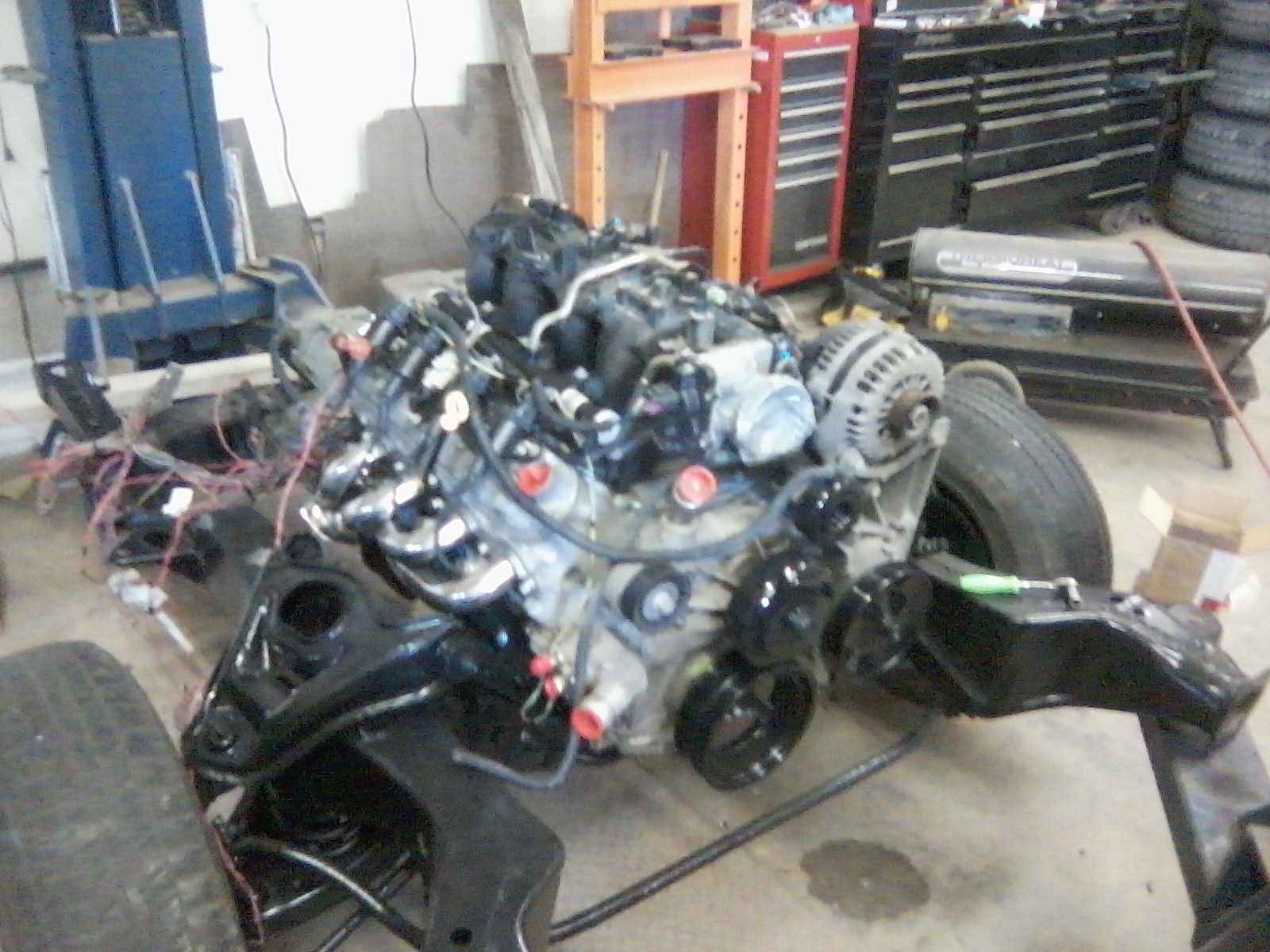

I found a deal on a 2011 Z06 corvette cam and I have a 2006 5.3 L33 engine. I believe its gen 3 engine. Im looking to upgrade before I get to far. I have motor/4L65E tranny mated to an extra subframe as of now. Car is a 76 buick skylark. I have subframe done with all new suspension parts, painted up black. So the front of motor is wide open to get at easy rite now. Is the Z06 cam way to go for cruiser/ weekend driver car or should go hotter? Rearend is 8 1/2 10 bolt posi with 3:23 gear.

thanks for the info/thoughts about cam. I been looking at craigs list and ebay but not much luck yet. Guy with Ls7 cam wanted $150 just thought might workout. Car is just a cruiser car not wanting a racer. The local corvette club has parts but wont give anything up. Only thought of changing cam while im still in project stage. I already pulled the truck wiring apart to get computor over inside passenger side of car.
06 L33 5.3 4L65E on a freshened up subframe. new suspension parts, springs. been working out the wiring to it will come in passenger side of car behind dash.
