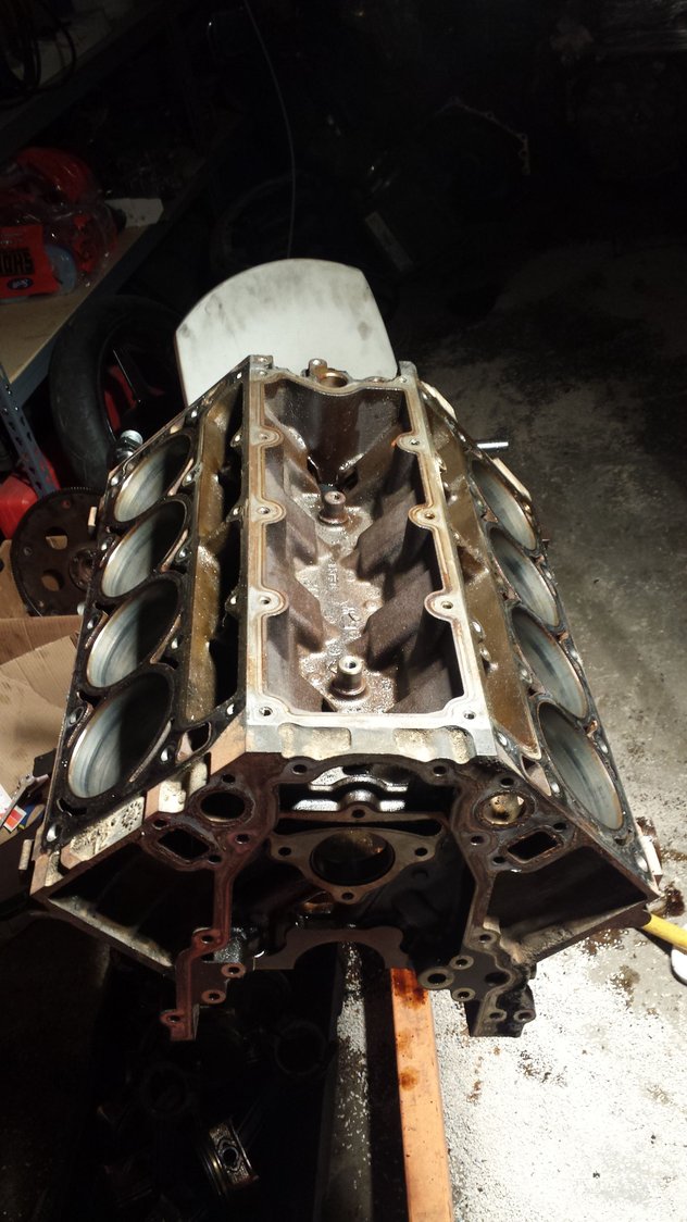

Old Apr 3, 2015 | 10:53 PM
roust84's Avatar
Joined: Aug 2013
Posts: 23
Block is off to the machine shop for boring and all that fun stuff.
I do have a question about head gaskets.
Are there any difference between ls2 lq4 and LS3 head gaskets other than the bore diameter? ie coolant galleries and passages or dowel pin locations
I will be running an oem MLS gasket but I need to take into consideration the new 4.03 bore as well as the combustion chamber diameter of the 243 heads. I was thinking the head gaskets with the 4.08 bore would work fine but I am not sure if there will be misalignment issues with other features of the gasket if there were any differences in block architectures.
Any thoughts?

Old Apr 4, 2015 | 01:24 PM
JRENIGAR's Avatar
iTrader: (37)
Joined: Dec 2010
Posts: 2,069
From: 72396
LS3 gaskets will work fine.
Old Apr 4, 2015 | 08:25 PM
roust84's Avatar
Joined: Aug 2013
Posts: 23
Great thanks!
Gaskets have been ordered.
