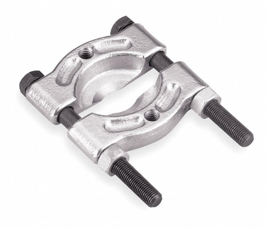

I just had the complete outter round section brake clean off of the center part of the balancer that fits onto the crankshaft snout.Does anyone have any ideas how to remove the part that is pressed onto the crank???? I am guessing its cast iron so welding something onto it is out??!!

Have you tried the 3 armed gear puller? Depending how long it is 6" or 9", it can fit around the outside of pulley to pull it off. A lot of Pb blaster wouldn't hurt

Grind 3 notches around it and use a 3 jaw puller.

No worries. Break your bolt loose and remove. Use a old shallow socket and a three jaw puller. Make sure to use a large enough socket to place the stress on the stronger portion of the crank. Give it 3 minutes of cranking and you'll be home free. Quit worrying..

There isnt nothing that a three jaw puller to grab onto!

i would try a bearing separator and a std steering wheel puller to bolt to the separator
http://static.grainger.com/rp/s/is/image/Grainger/1A807_AS01?$zmmain$
if that did not work (which it should i would grind the front smooth with what is under the bolt surface drill and tap a 1/4" bolt hole on either side.

But the bearing puller seems like the safest route right now.

OK thanks for the help guys,I went to harbor freight and bought a bearing puller/seperator today.After some wrestling I did get the broken part off of the crank.I will post up some photos later.PM me if you have any questions!!
