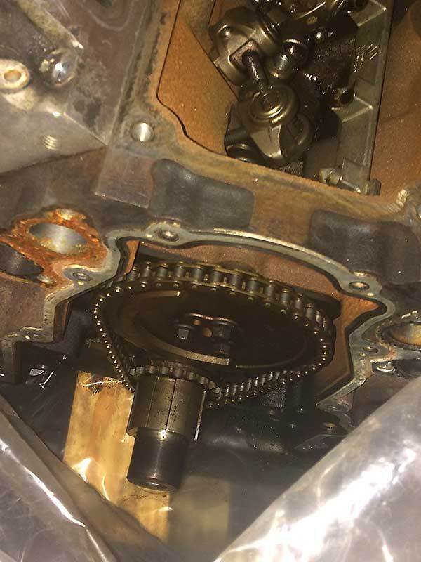

What do I do about this rust?

Wipe it down with oil or ATF. Marvel Mystery Oil works well too. That motor should have been coated with oil before it was stored.

You can use a wire wheel and something like WD40 to clean it off. A machine shop can blast if off too. I had a BBC blasted, cleaned, and checked for cracks for about $80.

Wire brush it off. The problem will come when you try to seal that area. That corrosion will make a pitted and irregular surface.
