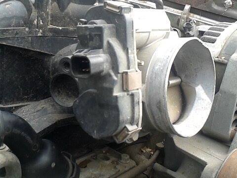

Hello I,m new on forum im from colombia and I'm new with the LS Engines
i want help to identify this engine,I hope some of you can help, and im want convert this EFI engine to carburated, u can say me the type of ignition controller to use and type of reluctor wheel 24x or 58x
Thank you
5.3 12571048
799

See the gray crank sensor? That means it is a 58X motor. If it was a 24X motor the sensor would be black.

this 58x reluctor works with MSD 6012?
i have a doubt... im looking on Jegs for MSD 6012 and says:
Ignition Controllers
Engine ID:
LS2/LS7 Cam sensor in front. Gray crank sensor connector.
LS1/LS6 Cam sensor in rear. Black crank sensor connector.
The cam sensor for this engine is in rear but the crank sensor is gray

Aside from the sensor plug colors:
It appears to have the later "TBSS" intake manifold
AND
It appears to have the plug for the oil control manifold
AND
The non-return fuel line
AND
The later DBW throttle body
Would all indicate this is a GenIV engine that would have a 58x/4x PCM.

So, MSD 6012 works for this engine?

This is a 5.3 out of a Trailblazer, the Drive by wire and tall power steering neck gave it away. If you can get a close up of the left rear of the engine block near the cylinder head there should a vin laser etched on it. I'm thinking it's a earlier Pre 05 Gen III engine because it has 799 heads. The GEN IV's I believe came with 243's in the trailblazer along with DOD.

799s are 243 heads, so this is a Gen IV from the heads and the fact it's aluminium block.
The earlier Gen IIIs had the "5.3" heads which I forget what casting they were but also had iron blocks.

Beat me too it, it looks like an Gen IV 5.3 from a gmt-360 truck (trailblazer, envoy, 9-7x, etc)
If theres a hole through the center of the oilpan for the front axle its a dead giveaway http://www.ls-guy.com/lh6/

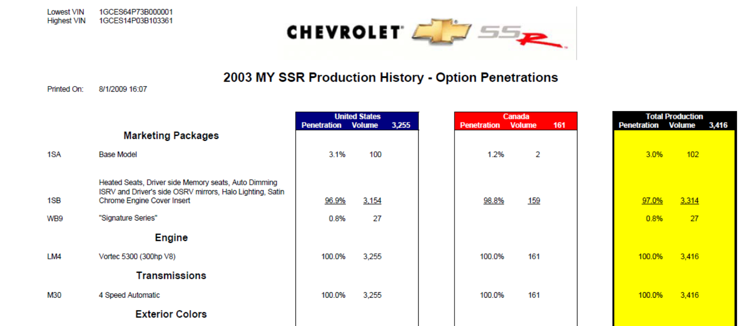

This from the SSR site "Chevy's new roadster is powered by an all-aluminum Vortec 5300 V-8." This is the LM4 and was never an Iron block nor was it offered in the Silverado. The package was made for the 360-370 platform (SSR,Trailblazer etc)

I know its not an iron block, I have one sitting in my garage on an engine stand right now that I just pulled out of an '04 Buick Rainier last weekend.

It looks like it has the cam sensor in the rear. Do you have a pic of the front timing cover?
