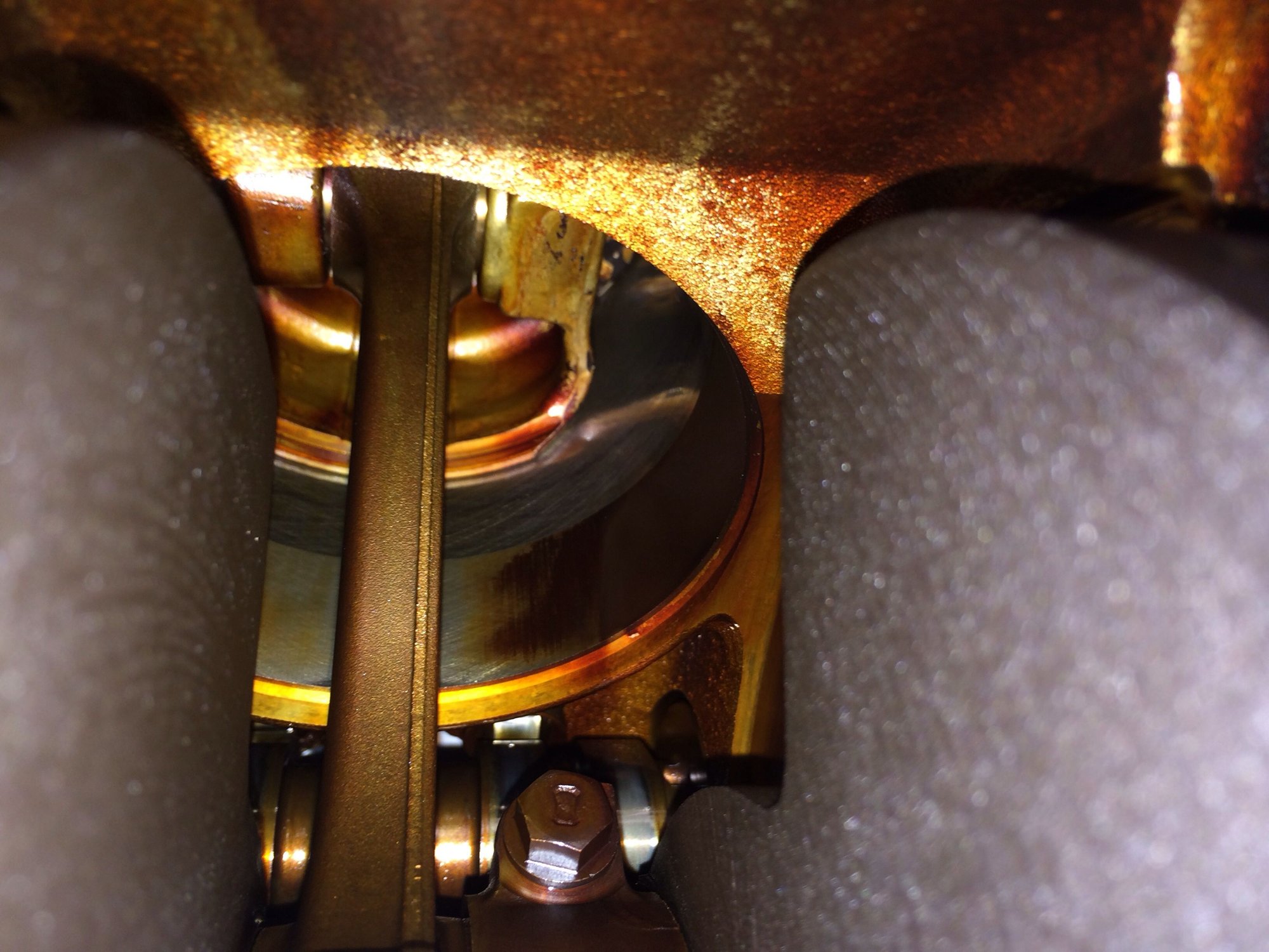

Hey, I bought this motor about 10 months ago and had it stored in my garage. It's from a 99 camaro that had 171k. It ran fine before I bought it and the seller pulled it. I went to put a new oil pan / t-chain / oil pump on it today and the crank will not rotate by hand. It turns about 40 degrees and then completely stops.
-Spark plugs are out
-T chain is off, cam spins perfect
-Oil pan is off and I can see cross hatchlings on the cyl walls where to pistons are up in the
sleeves
-rocker arms are off (replaced trunion bearings)
-flywheel is not hitting anything on the stand.

Ok, my guess was probably a little corrosion on the cyl walls. I wish I had a scope or something to see in the cylinders. I thought about just using a screwdriver in the flywheel teeth and prying on the arm of the engine stand to get it unstuck and see how far it will rotate counter clockwise.

Ok the motor is rotating a little better. Maybe 270 degrees total. It really starts to slow down / bind when the piston skirt gets down to where the cross hatching stops and the brown / rust begins... I can feel it pretty easy with my finger... Time to hone right?
That there at the bottom of your cylinder walls is carbon build up more than likely can't tell too well from the pic, but.. also your pistons nor rings never even touch that part of the cylinder walls..
If it were me, id so take some main caps off have a look at the bearings, maybe you have spun or seized main bearings, which is keeping it from turning maybe even rod bearings..
happen to me before.. not rod bearings, but mains!
Now if you have no spun or seized bearings, then id move on to taking the heads off, to have a look at the upper part of your cylinder walls to see if they have rusted.. if so, and the pitting isn't too bad, do some light honing either type of hone will work..
I like the dingle berry type, they cost lots though, but the 3 bar type of hone will help to keep your cylinders in round, either way, just do a light hone then recheck for pitting..
you can do the above in any order, heads off first if you want either way..
also id reuse the rings, head bolts, main bolts and rod bolts but that's me
im cheap lol .. head bolts are really cheap though too so.. might as well pop out 30 or so bucks for some.. 19.97 a side http://www.summitracing.com/parts/fel-es72173
Though saving up and doing it the right way is always best ..
I have no engine machine shop in my area either.. and shipping COSTS BIG TIME.. so iv been doing it myself lol in the backyard haha.. it does work though.. Anyways i just wanted to give you some encouragement

yeah... tty bolts twice is not a good idea. That lower portion of the cylinder bore definitely touches the skirt of the piston. The edges of the skirts go down below the bottom edge of the cylinder bore.
