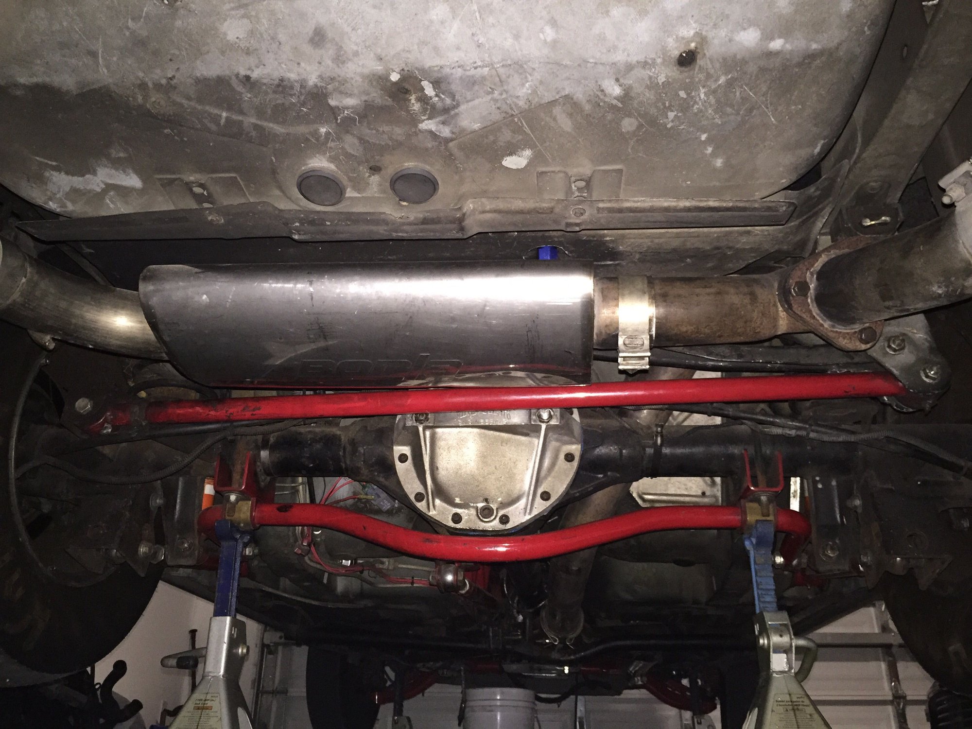

I don't have a Flowmaster merge but I do have a single pipe. I think it does just fine with my setup. In my opinion, until you reach a certain amount of horse power the difference between a good Y pipe setup and a good X pipe setup will be little to none. The reason I chose the exhaust setup that I did was the weight factor.

If you have a 3" Y pipe to start with, it can be cheaper. The vibrant merge was $100, I think the vibrant muffler was about the same, then I used a 4" stainless diesel stack for the rest of the piping and turndown which cost $40 (ebay). I chose the vibrant merge over the Flowmaster cause it is stainless as well and the construction of this piece is really nice. The ONLY down side of doing this is it's loud. I have had multiple exhaust setups (pacesetter Y with hooker cat back, pacesetter Y with 3.5" mufflex, custom 2.5" duals with an H pipe out the back, custom 3" duals with an X pipe out the back) and the setup I have now. For a lower horse power car like mine I feel the custom single 4" setup is superior to the rest for MY application. Not only is it lighter but I would bet at this power level it would be within 2hp of a decent dumped X pipe setup on my car. Here is what most people don't realize, the area of a 2.5" pipe is 4.9087385212341, the area of a 3" pipe is 7.068583470577 and the area of a 4" pipe is 12.566370614359.

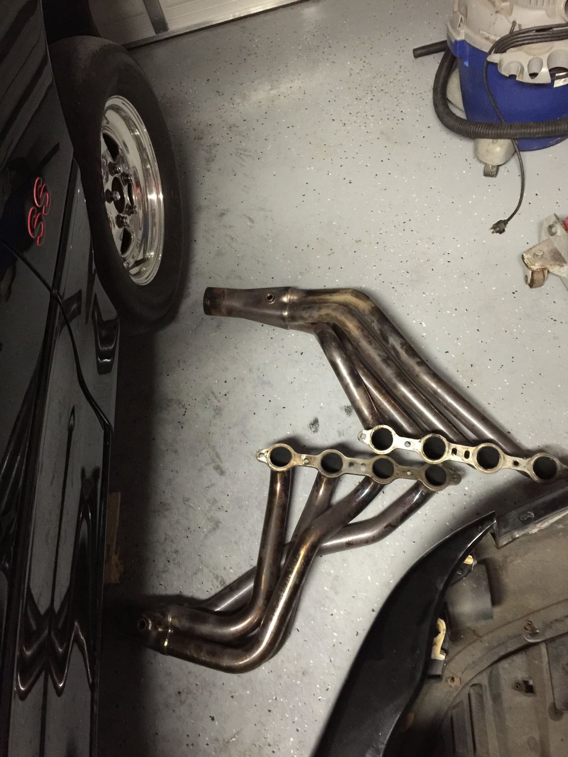

TSP 1 7/8 headers
TSP off road race Y pipe

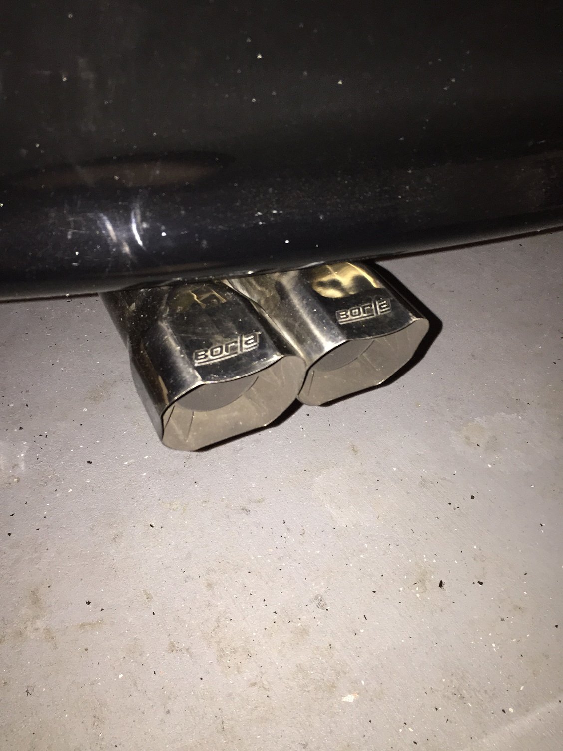

Borla cat back wide open exhaust
All looking for a new ride to make scream
I want 800 for everything you see here
Value of close to 1800
