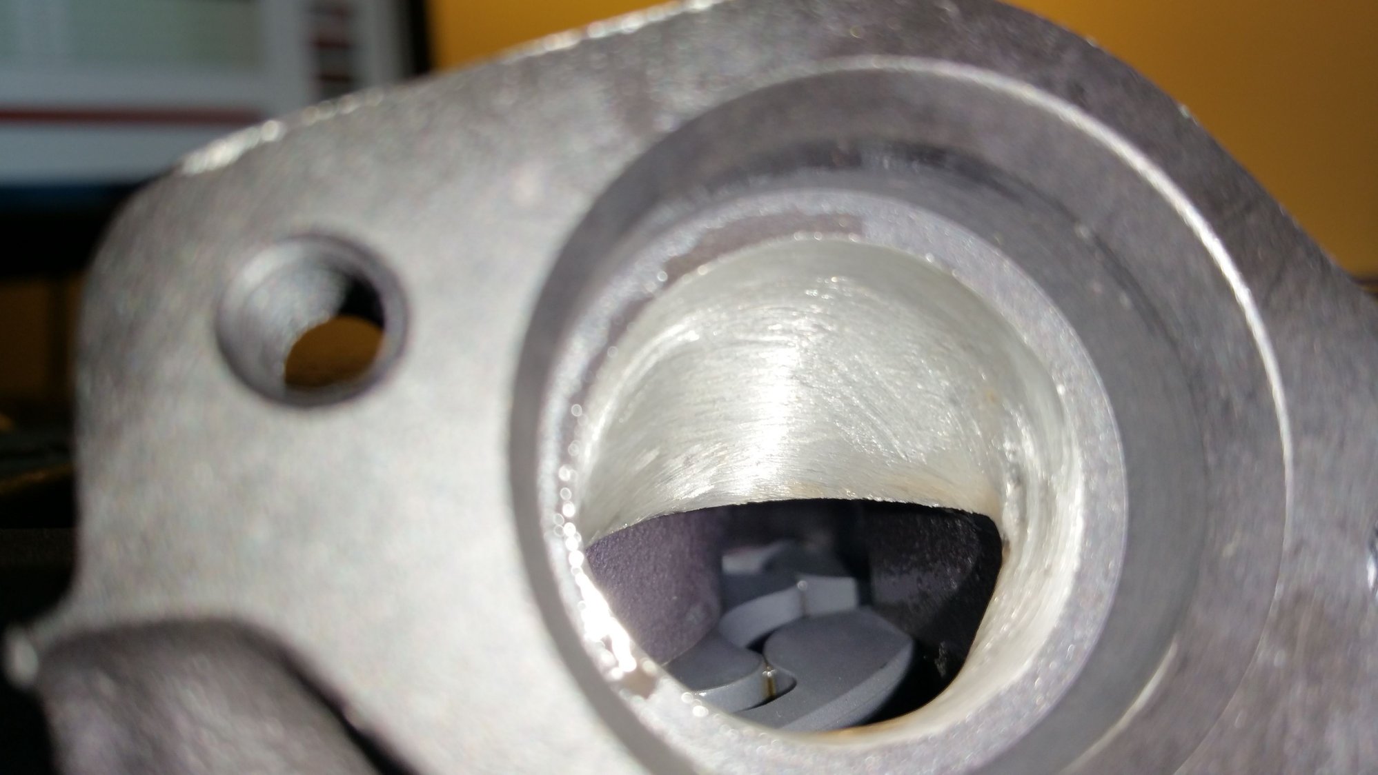

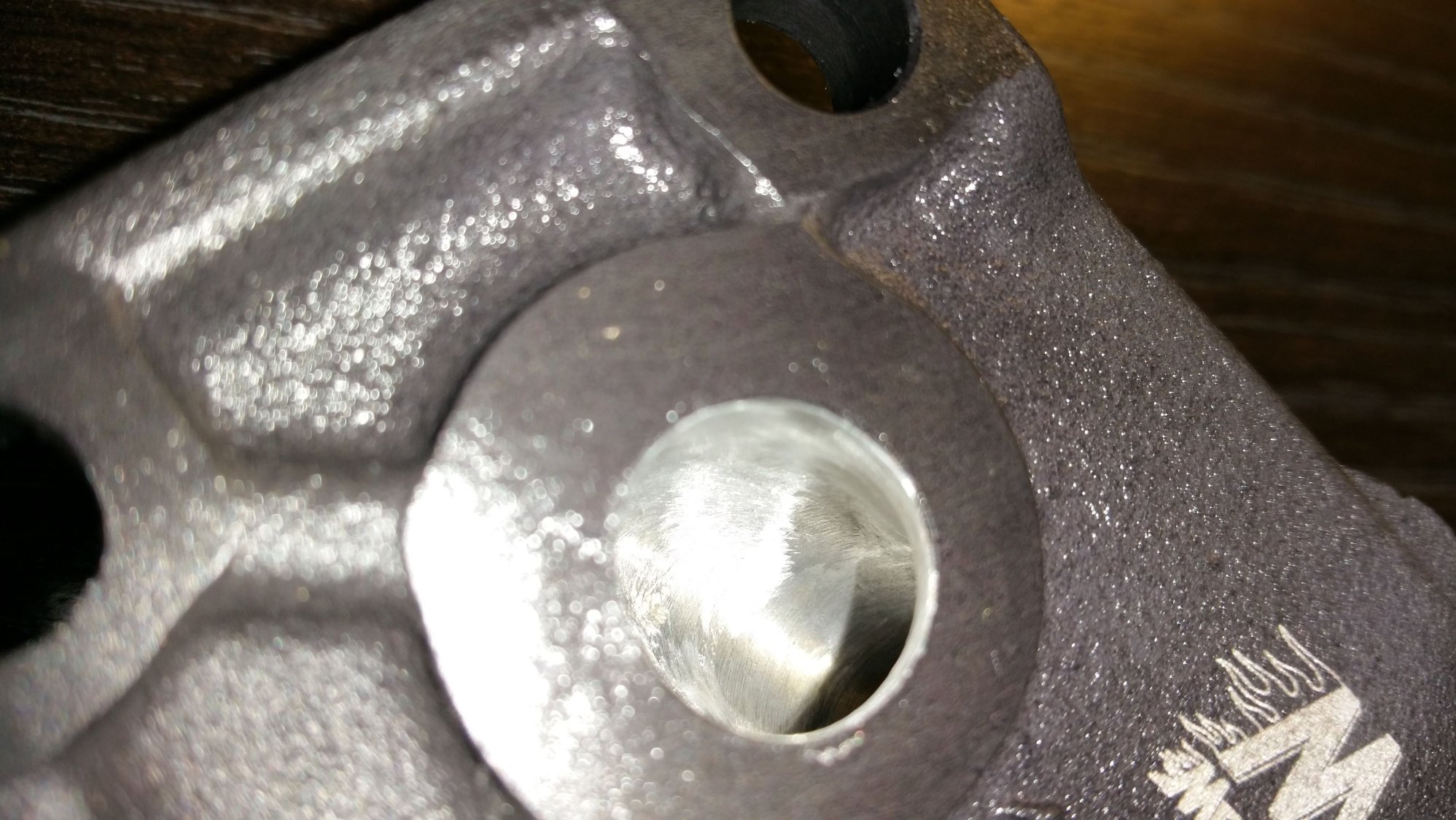

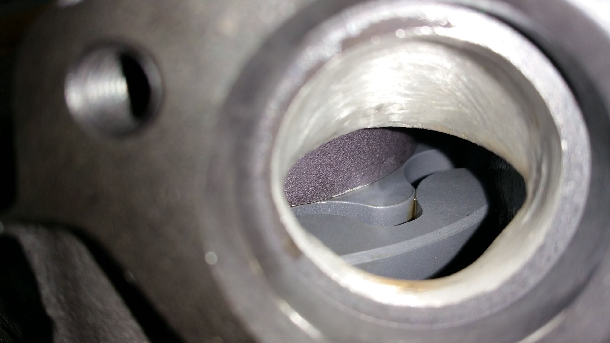

Bumping this to show some pics of my 10296 I just got for those interested in seeing the porting more close up. Warning big pics.

Missed this before. Looks good.

This is an easy port and polish job. I bought a porting kit from Standard Abrasives and went to town. Good DIY project that should help with cavitation and flow.
Amazon.com: Standard Abrasives 260001 Deluxe Porting Kit: Automotive Amazon.com: Standard Abrasives 260001 Deluxe Porting Kit: Automotive
